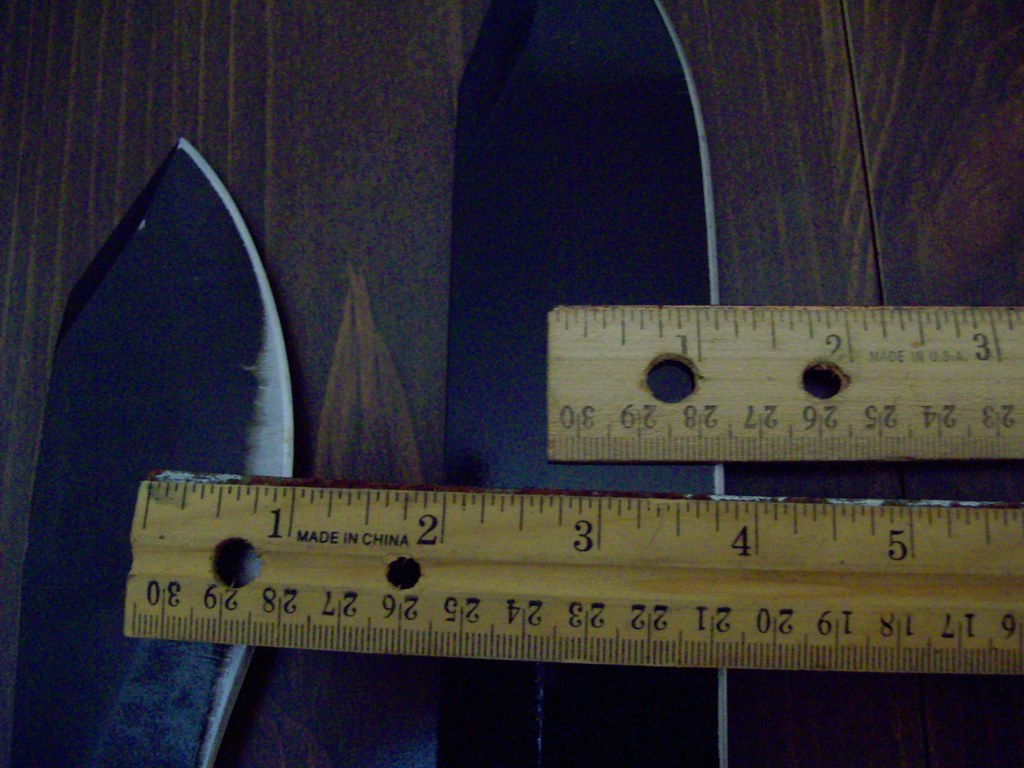

Ax, This is a great contrast-ison. I just gained some insight about the BK-4, and the BK-9 and which is a little better at what. One thing I picked up is that the grind heights probably provide an explanation of the Bk-9's deeper bite.
Please forgive me, I'm about to get technical :D
a little bit of a skewed angle. But, hopefully, the pic came out ok enough to see... I'm no pro photographer. But the moral of the story is that the Bk-4 has a grind height of around 7/8" (0.890" right at the thickest point) while the Bk-9 has a grind height of around 1 3/16" (1.175"). These are both Kabar knives. Taking stock thickness into account, the Bk-4 is 0.195" thick Bk-9 is 0.188" on the money (per the blade database's stats). Only 7 thousandths different. That is a quite similar stock thickness, and a good bit shorter grind for the Bk-4, providing a wider(more acute) grind angle. explaining why the BK-9 tends to bite deeper.
That being said, I would expect the BK-4 to split(baton) better because of the wider angle and greater focus of energy at the sweet spot. I also found it neat the the BK-4 seemed to limb better, but I'm going to chalk that up to the same focus of energy as above, and spare everyone a second pseudo-science lecture :D

you need an American ruler...... :D
but you make a good point, I think the angle of grind DOES explain some of why the 9 bites deeper.
