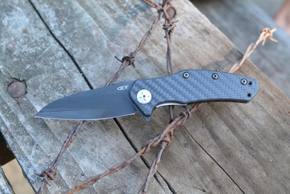

This ZT0180 has been batoned through the better part of a face cord of fireplace-length logs, mostly oak. The coating has not been touched, and the knife looks great after I cleaned it up.
This ZT0770CFM4 has seen quite a bit of cardboard cutting, I use it to cut down cardboard for target backers, and also used it to make a pile of cardboard backers for posters.
The coating has held up very well, and the steel on both of these knives is outstanding.
ZT does it right.
