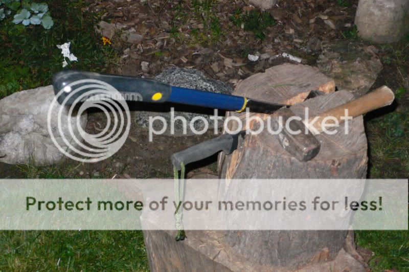

I've pounded the Res-C handle of my Dogfather with a small sledge hammer for quite some time. Used a lighter to smooth out the small scars and good as new. :thumbup: for Res-C. And it's grippy, not sure with seal oil?
