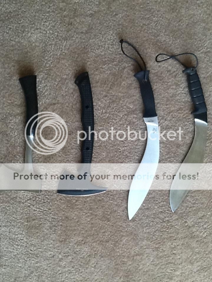

And here are the competitors. Sorry it's upside down, I'm struggling here with these on photobucket. Be patient with me, not very computer savey!

My testing was limited to chopping, using a very seasoned, very hard, 11 inch diameter log (yes I measured). Not sure what kind of wood it is.
I used 3 strikes with each blade.
Surprisingly, the Estwing hatchet performed the worst, despite its relatively thin blade geometry. This is the only one I did not take pics of, as it did not stick in the wood (which is actually a good thing). Of 3 strikes, deepest penetration was 1/2 inch.
The Ontario Spec Kukri penetrated 3/4 of an inch on its best strike. The other two strikes into the wood were between 1/2 inch and 3/4 inch.
The Kangee Tomahawk did much better than I expected for being a dedicated breacher. Two of the 3 strikes penetrated 3/4 of an inch while one only went 1/2 inch deep. Any tomahawk fans out there who do not own the Kangee...........GET ONE! This one hawk does it all. I have a TON of tomahawks (RMJs and Swamp Rats included all the way down to SOG's) and I'm telling you straight up..........this is one of the best all around tomahawks on the market today. I put ALL my blades through the "ringer", and the Kangee is one hell of a product.
The CS Gurka Kukri SK5 did what I thought it would do..........cut deep. All three cuts were 3/4 inch deep. This blade has a proven track record for a reason.......it's a performer.
Ok, now what you've all been waiting for. How did the BK9 stack up against blades that were engineered for deep penetration with a forward weight distribution design?? Well.........
All three strikes, the KING penetrated 3/4 of an inch deep into the seasoned hardwood. This things a beast.
I do not feel that the wood was any softer in one spot over the other. In fact, as you will be able to see in the pics when I post them, all chopping was done in the relatively same area (all within 4 inches of one another).
Now, with all this being said, do I think results would vary over a period of extended chopping? Yes........at least somewhat.
I got the impression that over time, through extended chopping, the CS Gurka Kukri would take the lead. I think the Ontario Spec Kukri and BK9 would be neck and neck. While the Kangee Tomahawk would certainly hold its own, it's place is tearing apart steel and opening doors that were thought to be closed for good. The Estwing threw chips like its supposed to and I see it holding true to its lineage as a true woodsmans companion.
