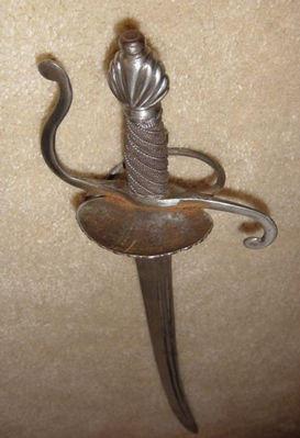

Granted, there were lots of antiques made by filing rather than forging, as shown on this antique sword-
And some did not have grooves at all, so I'm not trying to pick on anyone here. I just want more folks to stop and think about design.
