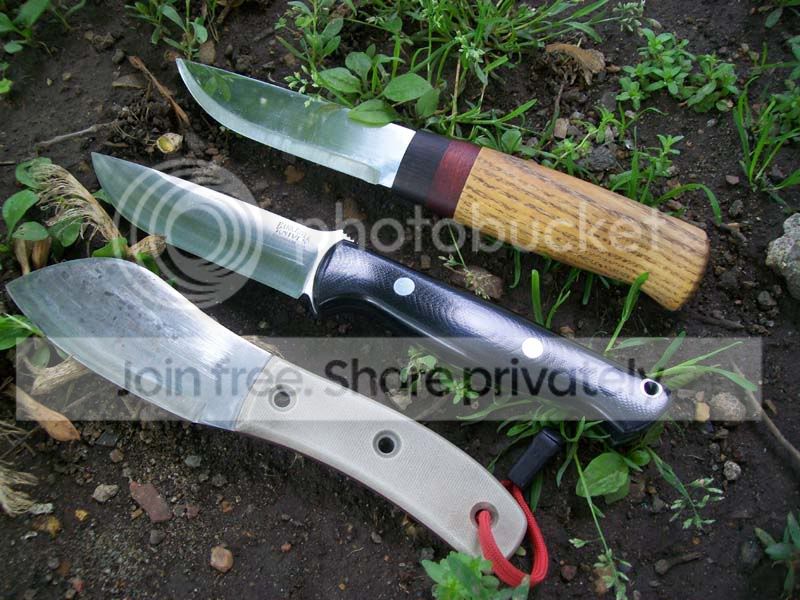

comparision shot with the Gunny and a Brusletto Scandi...

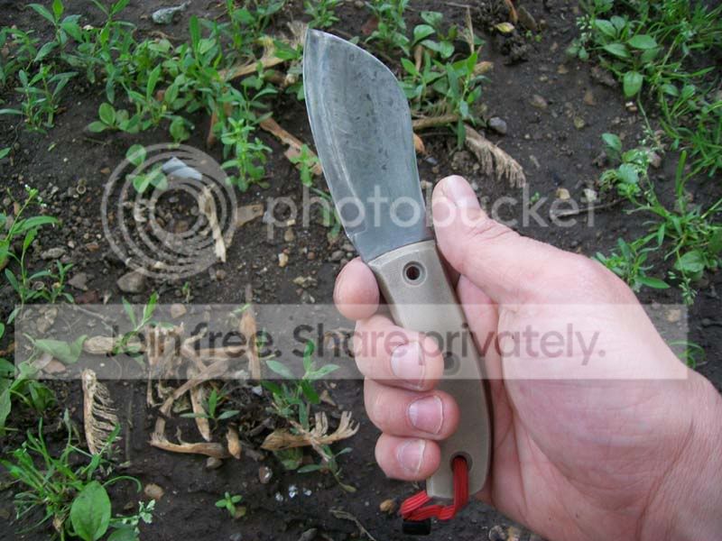

fits well in the hand for a knife this size!!

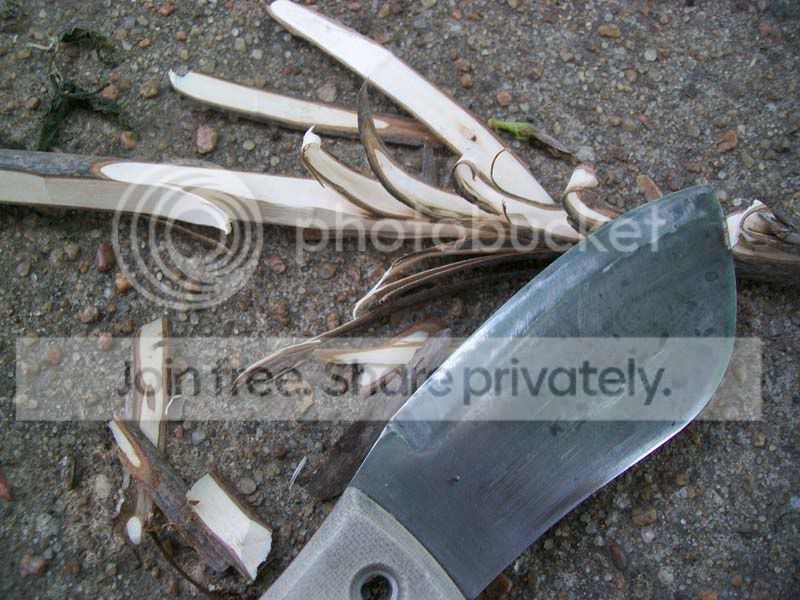

some woodworkin...

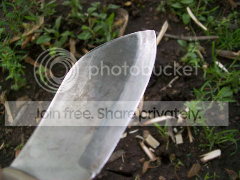

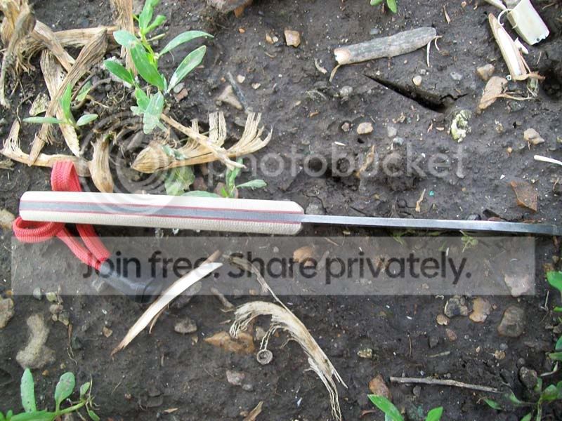

ultra lightweight thin design!!

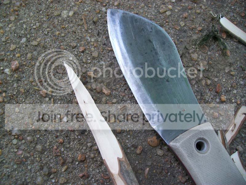

The hybrid convex scandi edge really bites well in the wood and is easily maintained!!!

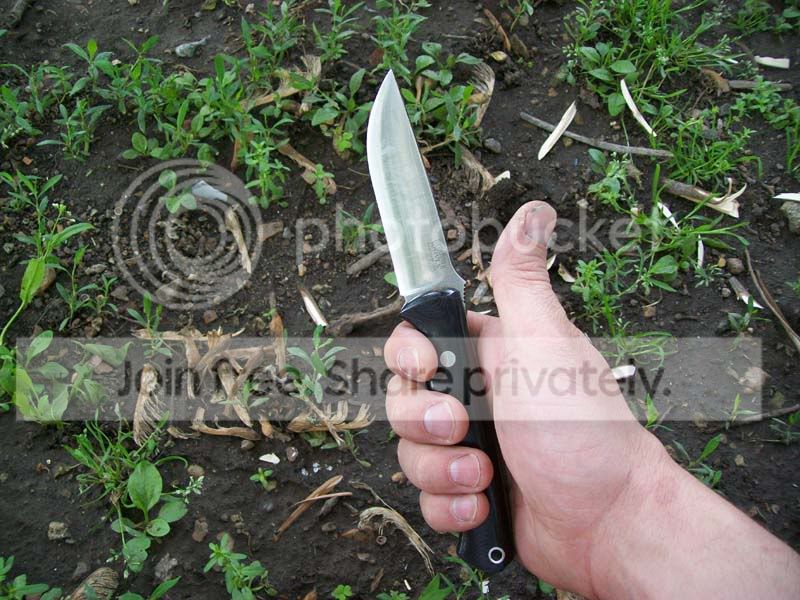

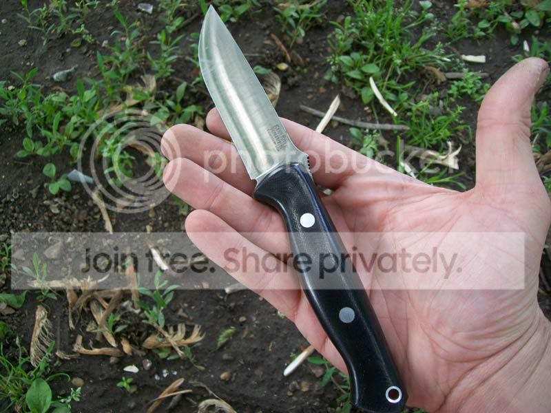

I also have read several requests for in hand shots of the Gunny. Heres a couple, and I am gonna get a review up soon....

Nice pics. Looks like a handy little knife.
P.S. I like the scandi too-where did you get it?

My thoughts, I was very pleased with everyones reviews and pictures. All were very well written. I think the next one I make will have a bit thicker handle scales and I will use 3/32 O1 instead of 1/8th thick. I also plan to pull the bevel up a bit higher to help make it a better cutter.
I had thought about bringing the tip up a bit more, but after everyones reviews I think I will leave the profile as is. If I change it up too much it will just end up being a different knife.
