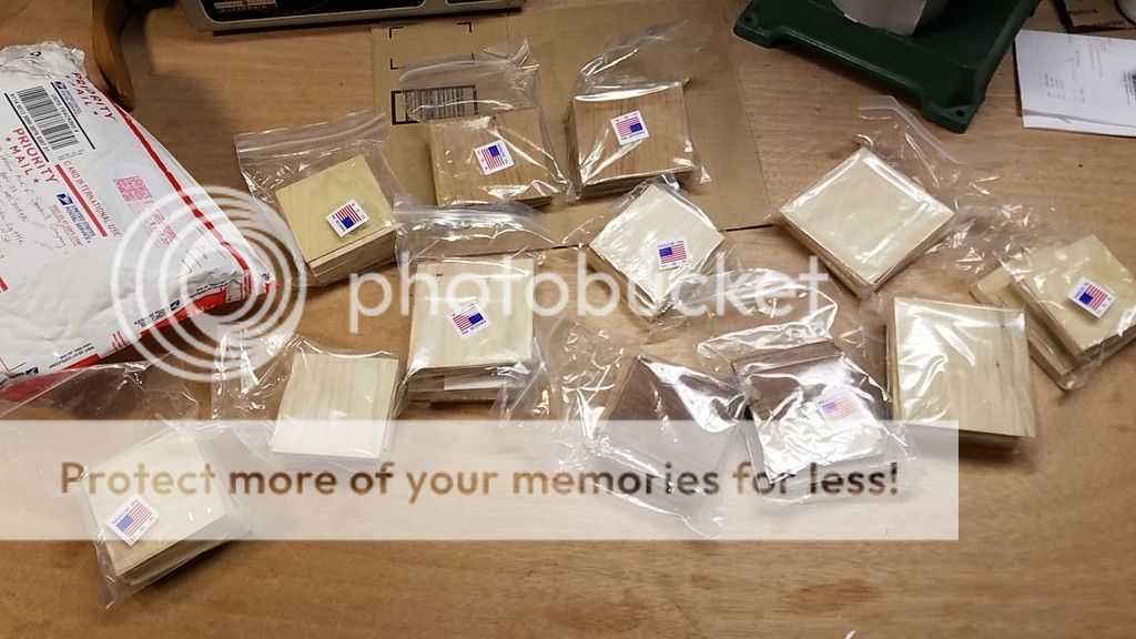

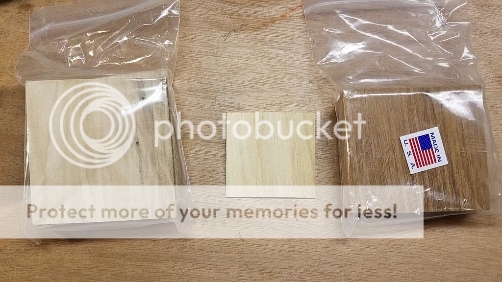

So I placed an order for some Thrane wedges, as I was sick of making my own. If I can order quality wedges for a good price, why not? Anyway, they seem to have flat rate shipping so if I order a dozen wedges the shipping is $15. If I order 6 dozen the shipping is $15. I may have ordered a couple years worth, but the cost per wedge goes down. These ended up averaging 85 cents each shipped. I got 48 poplar, 12 black walnut and 12 locust. I'm happy with the what I got for the price. The only downside is that it took a month to get them. I wasn't in a super hurry but I could have been. Maybe it was the size of my order. No biggie but be aware. Also, they are not uniform in size and many are huge. The second picture has a standard axe wedge in the middle for scale. Some of them are like shingles, and not all thin enough at the tip to enter the kerf without putting onto the belt sander first. I will need to cut and reshape some of these which is a bummer, but the price makes up for it.
Looks good. I bought a dozen elm wedges back in January. It took about 2 weeks to get mine. Like you I got a couple extra large ones. I like that. Overall I was happy with what I got and I wont have to cut my own for a while.

Oversized it's a good thing
Well, while I appreciate being able to split them up, part of my reason for ordering was to save myself the hassle of cutting my own and having to shape them on the sander. With many of these, I'll still have to shape them before they can be used.

jb hangs a LOT of axes. I'll be honest, I always have this feeling of "hey, I'm almost done" when the handle is fit but then I realize .... I still gotta make the damn wedge. And I hang nowhere near as many. He got wood choices, probably the grain orientation he prefers and all in one shot. I don't find any useful commercially available wedges near me which may also be the case for him. Dunno.
I'm simply sick of making them, and the only other options are paying $2 each at the hardware store or ordering some from House. I've had House wedges with mold and worm holes so I'm not ordering those. So that left this source which came recommended. I think they were a good value.
