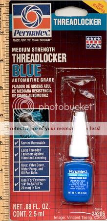

What brand of blue thread locker is best for the pivot on a folder? I have been using Permatex and it seems to work okay, but it is watery. I took the pivot off one of my Buck Striders and the blue thread locker is thicker and seems more "paste"-like. I would like something a little less watery than the Permatex.

I use Loc-Tite and Permatex. Either is fine and you only need the tiniest dab for it to work.
Typically using too much will crud up the pivot, leak out and afffect the action of the knife, and be soupy when you check it later.
loctite, or permatex are good. You need to shake the bottle good before using it. I usually let it dry for at least 12 hours after using it.

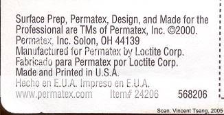

there's a very good reason for this :D
