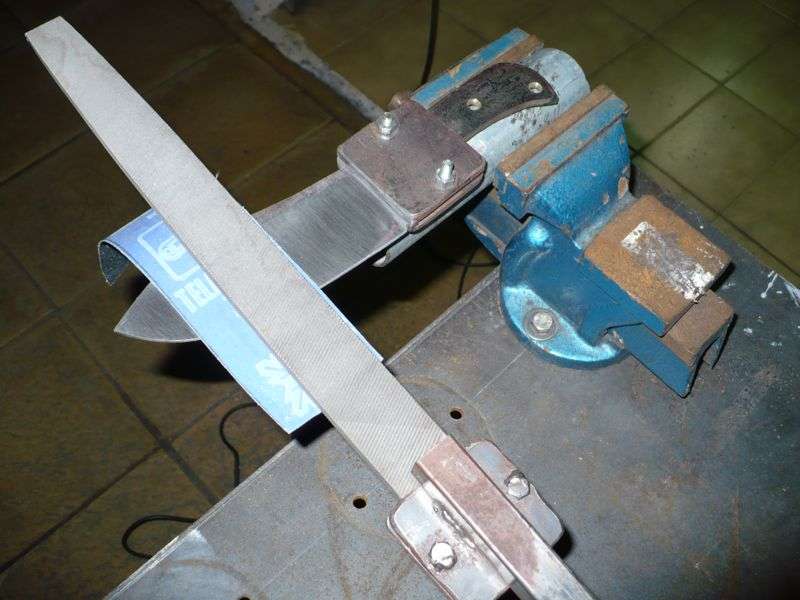

Starting from 5mm leaf spring with angle grinder, files, sandpaper and lot's of elbow grease I came up with three blades (a whole day or so working on them). This is my grinding/filing jig:

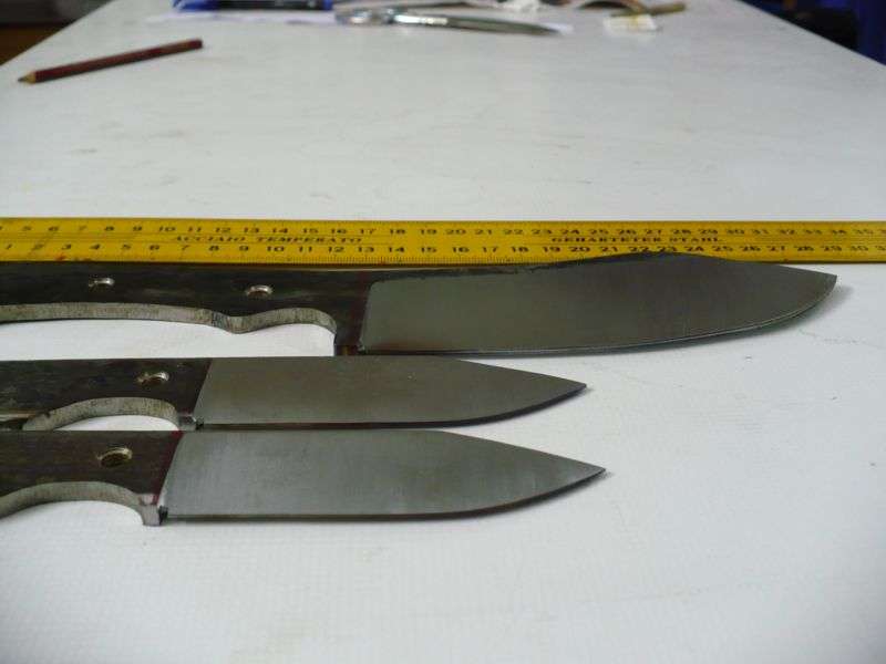

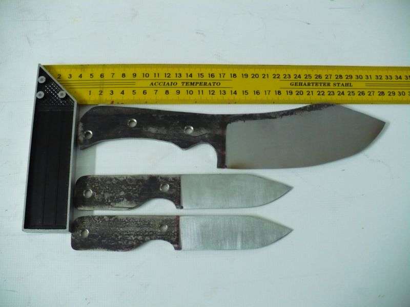

And these are the blades. BTW, I am not making another wide bevel blade in my life with handtools... I takes ages filing!!! There is a point where you are trying to sand such a big area that the file doesn't bite at all.

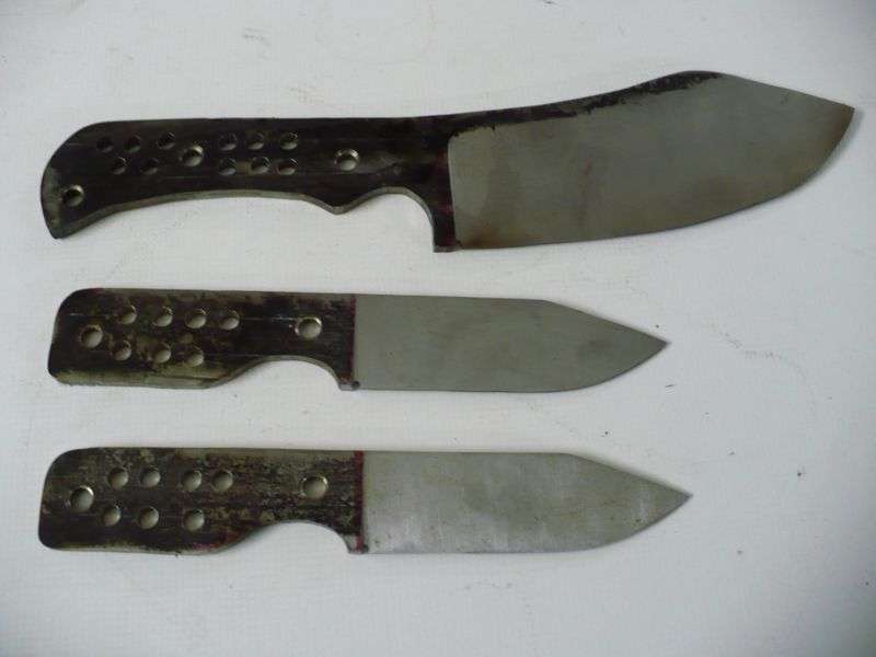

These are going to be my first not skeletonized handles. I always did that on my other blades but without a powerfull drill it takes a lot of time to do and it doesn't actually make much of a difference. I was a tad worried about the epoxy not having enough grip so I drilled a bunch of holes in the tangs. They ended up like this.
As you can see in this picture, the two small ones are ground thin (edges are like 1mm thick or so), while the big one ended up almost twice as thick (2mm).
I didn't meant to do so but wanting to keep the saber grind as even as possible on both sides... I screwed up a bit. I guess I will have to work a sweat putting an edge on that one. Probably a wide convex edge. That might help making cutting tool instead of a splitting one.

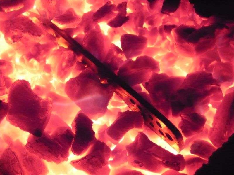

And here you have a few pictures of the heat treat of one of the small ones. Coal forge and lukewarm burnt engine oil for quenching.
I actually had to repeat the HT on one of the blades TWICE because it didn't pass the file test on the whole edge. Somehow some of it didn't get hard (not hot enough I guess). I finally got it right the third time. Now it's all good.
If you thought that was bad, try filing the bevels into an 8" chef knife with full distal taper. Never again.

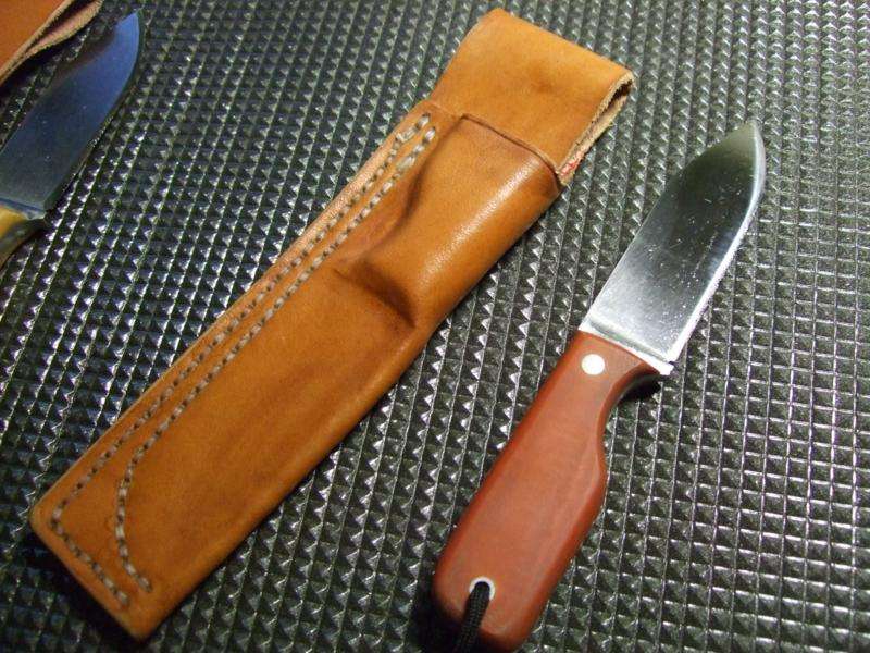

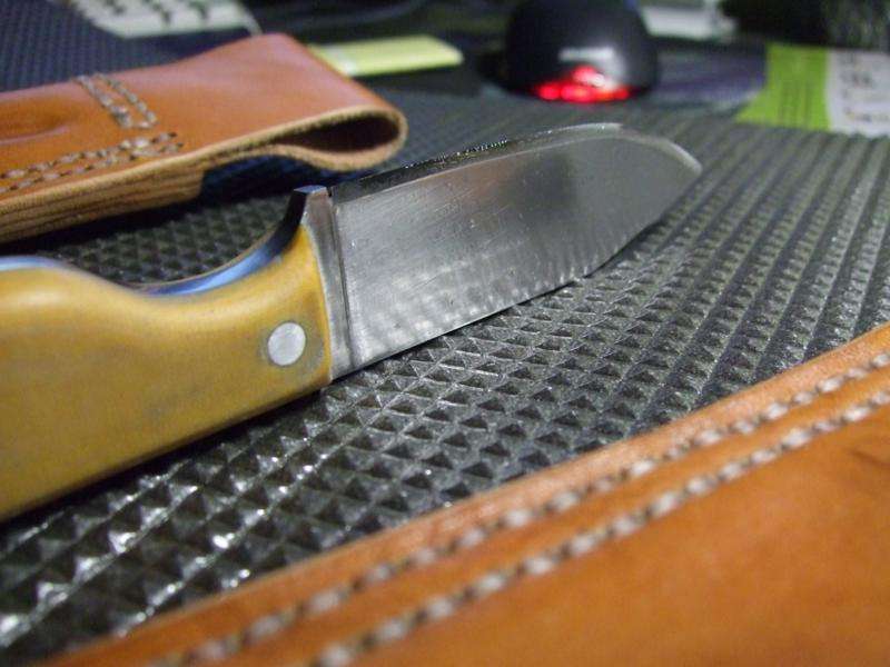

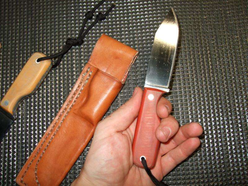

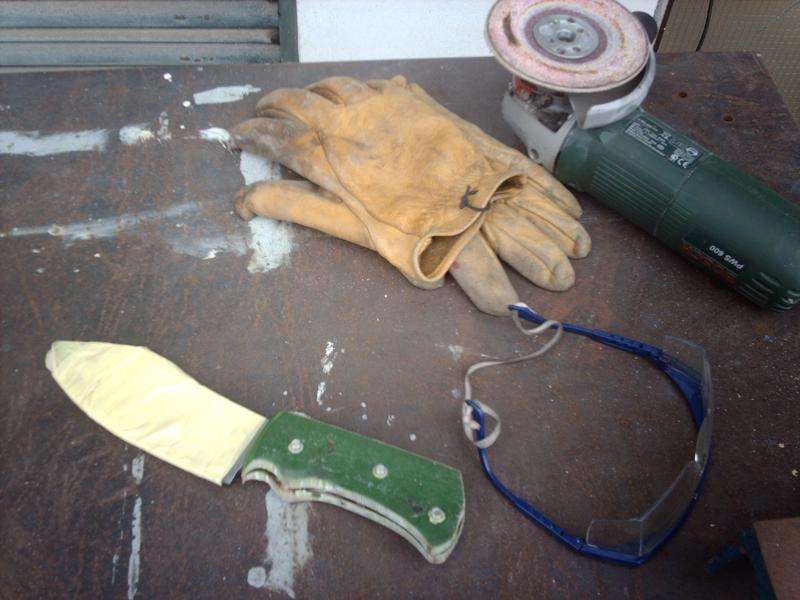

Well, I guess enough time has gone by... This thread needs an update. Sadly I can't work as often as I would like on my knives, that's why they take sooooooo long to finish. To be fair, que nessie is not quite done. It still needs a bit of polishing in the blade and a sheath. I have used it though and it works like a champ. Anyway, here you have the pictures.
While working on the handles....
Mostly done (crappy picture)

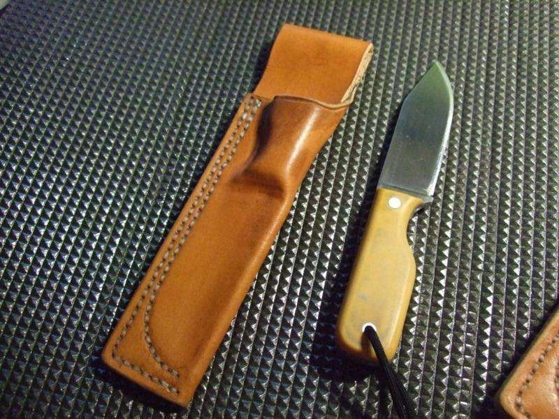

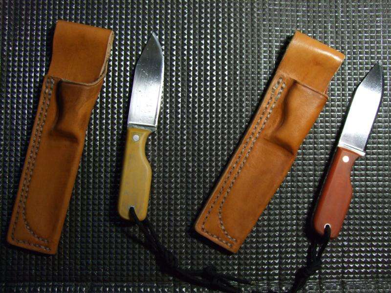

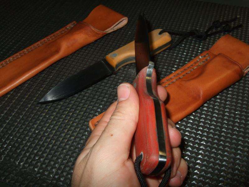

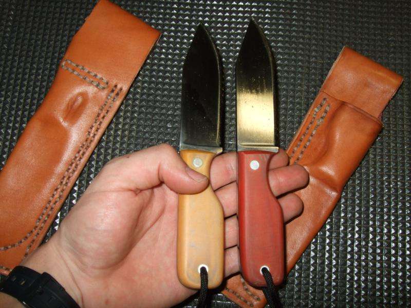

And now the twin ones. I made the mistake of oiling the blades BEFORE taking the pictures, so there is some dust on them. Sorry about that.
Let me say that the orange one has a mistake on the handles that I will be fixing tomorrow. I will also try to get better leather for my next sheaths since the one I used was thinner than desired and not hard enough (I couldn't burnish the edges).
