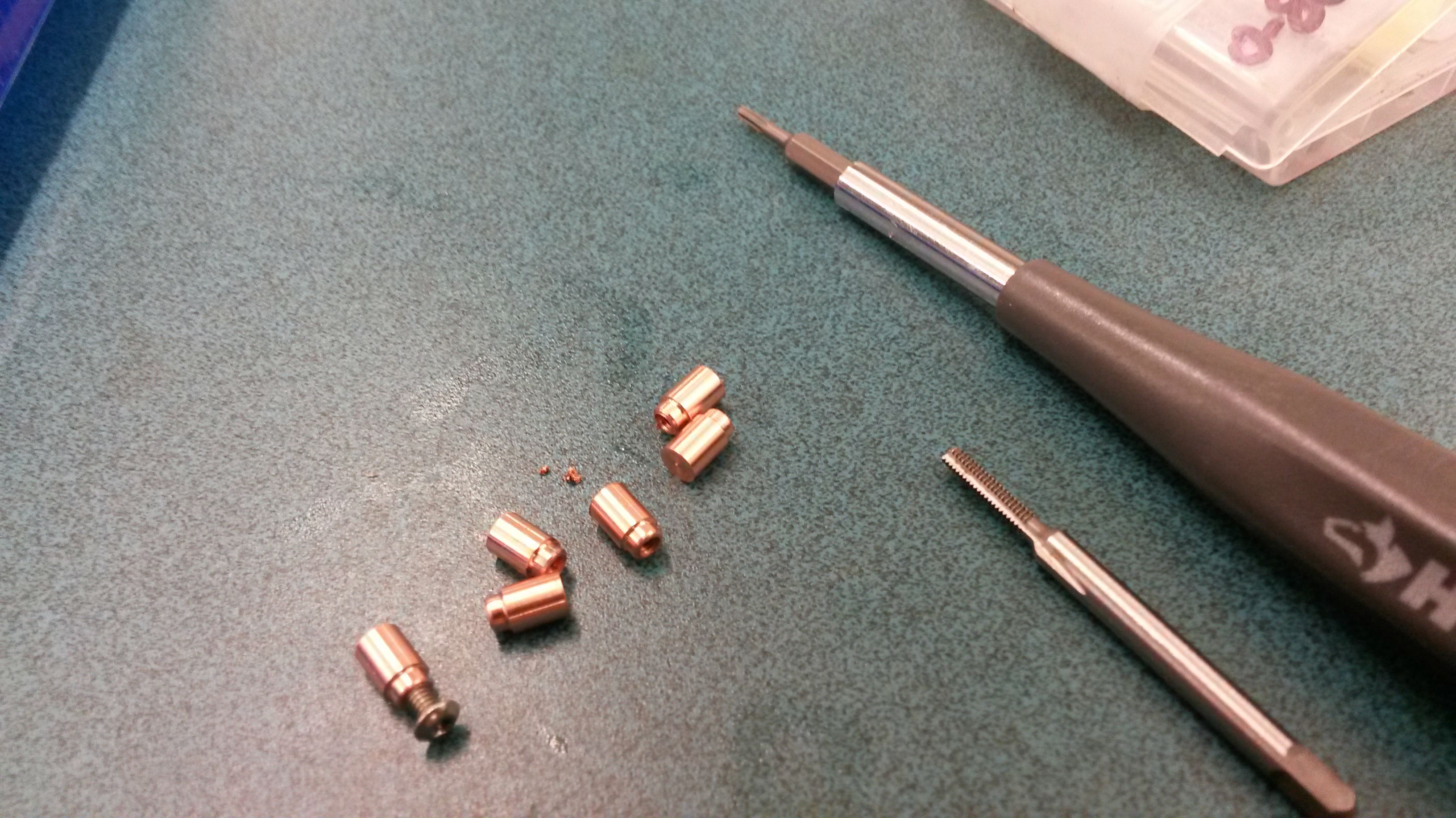

Hey,
Im looking to make a thumbstud for a folder knife im making. Does anyone have any ideas or ways that they use to make the things?

They're usually turned on a lathe (you can mill them too). In a pinch you could also chuck up a rod on the drill press and use files and sandpaper to shape it. The last method works better if you buy pre-made ones and just modify them that way. Here's some I turned on the lathe a couple days ago. If you don't have a lathe though, you should probably just buy them.

Neil, those look good, brass?
Thanks, they're copper actually, pretty happy with the surface finish. Funny that Frank mentioned USA Knifemaker, because they're basically just copper copies of the brass ones USAKM sells (which I also recommend).
