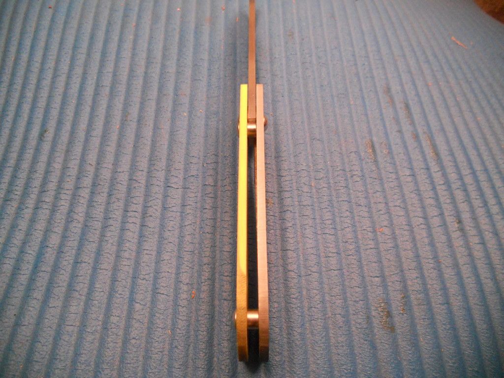

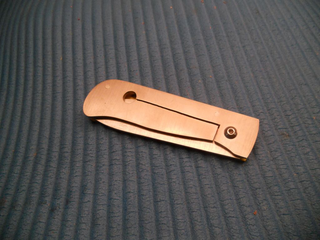

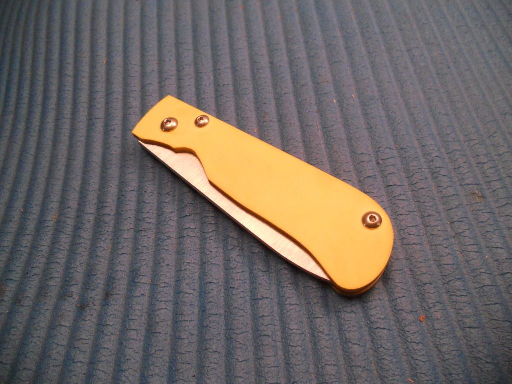

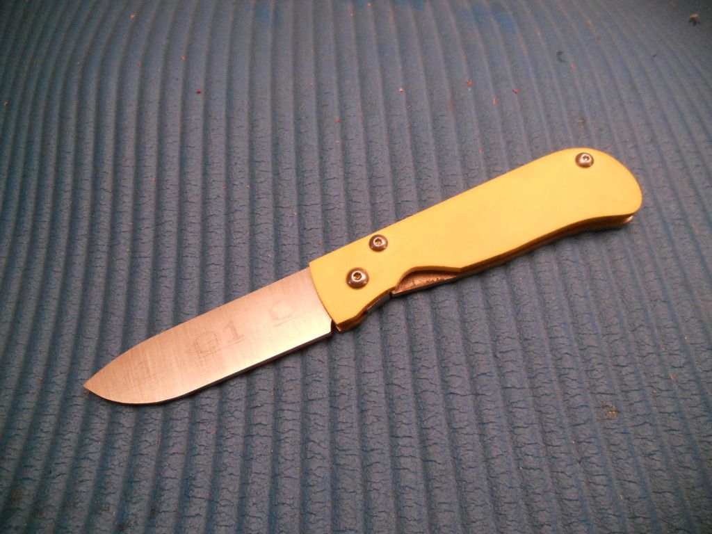

Thought I would share how it is looking so far. This one has a titanium locking side, and a yellow G10 non locking side. (Why? Because I had it on hand!)
Here are the specs:
4 1/2" handle (each handle slab is 1/8" thick)
3 1/2" X 1/8" blade of O1
Pivot pin is 1/4" stainless surounded by a 1/4" I.D. X 3/8" O.D. ball bearing
.016 bronze washers
1/4" stainless stop pin
Looks great to my eyes.:thumbup:
that's an awesome blade shape! I really dig the design. Just curious, what do u think of a kephart folder?
I played around with this again today, so far everything is working out as I envisioned it would. In other words, these will be available to order. What nobody realizes is that I have been playing around with drawings, and lots of ideas (some good, some not), but it`s proving to be worth the time (and scrapped out materials!)
This one will be finished up this week. I broke my 6-32 tap yesterday, so I need to get more of those, so the thumbstud won`t be like the production ones, but I could not wait, I want to heat treat the blade tomorrow.
Looks great, John -
I can see that you have done some work on the contours of the handle. I like the blade shape.
I am anxious to see a finished product.

The big changes are on the inside. I`ll be sure to post pics.
