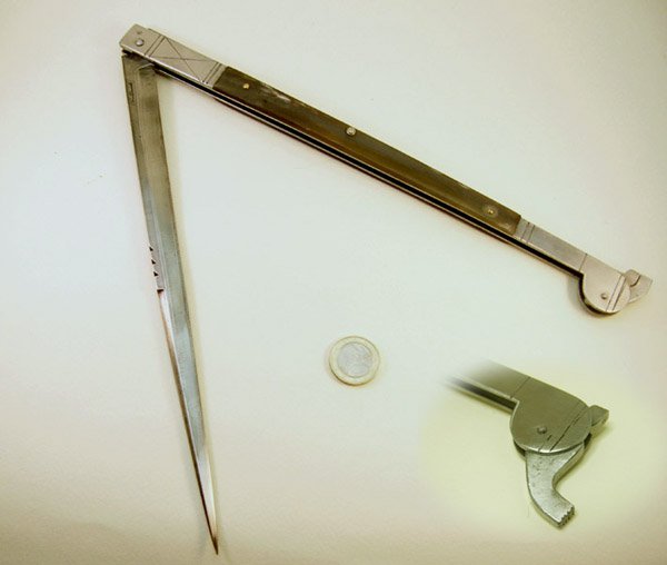

Just for the coolness factor I bought the Cold Steel Ti Lite 6. I don't intend to carry it (much), but I have had a project in my mind. There is a living tradition of italian knife fighting (with which I have had a brush) and the knives they used in old times were something like this:
The Ti Lite 6 has the size and shape to be a modern version of a classic duelling weapon. So, I intend to make wood scales and modify the blade. The quillons will be sligthly reshaped and I will take the thumb stud off. The knife can be opened with a flick anyway.
