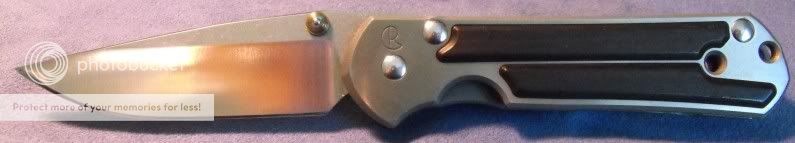

I received my new TI-Lock today. I was really looking forward to getting this one and have now had a chance to check it out and report my initial impressions.
Let me start out by saying that there are some things I really like about it, and I some really don't. Let me explain...
The size makes it perfect for EDC. When it's closed, it is nearly identical in size to the small seb.

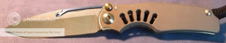

Opening the Ti-Lock is smooth as silk. I find it easier and more natural to open by applying slight pressure to the blue ti-spring and open in a fluid movement as if it were a thumbstud. Trying to open with the locklugs is not as fluid, and the sharp edges of the lugs are not comfortable. The nature of the TI Locking mechanism is such that toward the end of the travel, right before the blade locks, the spring is required to overcome additional resistance - without a thumbstud, the resistance is enough to cause the thumb to slip off of the blade during this motion. Because the spring is now under tension, the blade wants to retract slightly - this is IMHO a little bit dangerous.

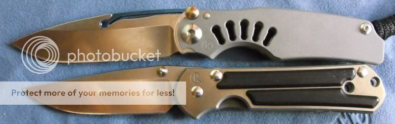

Once it is open, it is quite remarkable how different it is from the sebenza. You will notice in the photos below that although the handle sizes are the same, the blade of the TI is larger than the small seb. The blade shape is a drop point, and the entire blade is angled slightly away from the handle as opposed to the seb which begins much more parallel to the handle.
It is definitely unique looking with the blue ti-lock and the cutout to engage it. The more I handle it, the more it grows on me, but overall it is quite funky and definitely visually "Front heavy". This makes it look beefier than the Seb, although in use, CRK acknowledges that the TI-Locking system is not designed for strength, and one should assume that the framelock sebbe is capable of more. Neither the Ti-Lock nor the small Seb are big knives - I would not ask either of them for very heavy use - if you need a heavy use folder, get an umnum or a lerge seb.
What I really do not yet like is the closing action. I am very much used to frame and linerlocks, so this is a completely different operation. There are videos on the youtoobs that make it look very easy - one of which makes it look like it springs shut. I find it awkward and uncomfortable to close one-handed. The position of the lugs make me want to put my fingers in an unsafe position in the path of the blade. The lugs themselves have a pretty sharp edge, so my thumb is not a happy camper at the moment. So far the only comfortable position for me to close it in is to grab the lugs between my thumb and middle finger while applying slight pressure to the back of the blade with my index finger. I know that with time, I will get comfortable with it, but my first impression is an awkward one.
I really like the pocket clip - I'm used the the ones on the sebs, but this one is very cool.
Overall, I would say that this is still a very cool knife. The quality certainly lives up to CRK standards, but some little touches like the sharp edges of the lock lugs, and the additional pressure needed at the end of the opening stroke are things I would not expect from CRK. CRK describes this as " an exercise in mechanical innovation". With that, they have certainly accomplished their goal. It is very unique - Grant and Gavin Hawk have certainly proven themselves as designers. I hope Chris Reeve continues to refine this model as he has done with his other products.
I'm curious to hear your experiences and reactions to this knife.

As for opening, I don't think those lugs are opening lugs, they are more designed as a part of the locking mechanism. When you look closely there are thumb nicks on both sides of the blade near the blue spring, similar to those of the Mnandi, they are for opening the knife.
It takes some time and effort to get used to the action of Ti-Lock and operate it single handed, but after you get used to it's really smooth and convenient.

I use my middle finger, ring finger and pinky to grab the handle against my palm, and use my thumb and index finger to get a hold of the thumb lugs from both sides, lift the lock bar, move the three fingers away from the path of the blade, grab the back of the handle using four fingers (no thumb) against my palm, use thumb to close blade.
It sounds complicated but it's actually quite easy, takes me 1 sec to complete the series of motions.
