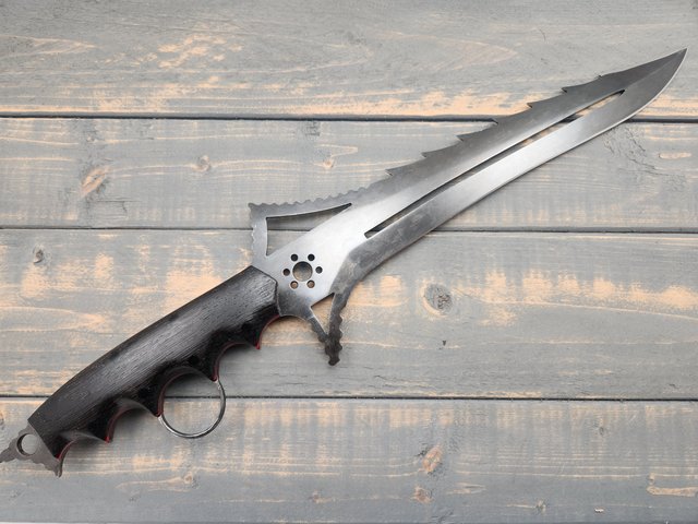

Crafted from 1095 this custom piece features a skeletonized design, complete with a saw back, an integral guard, and jimping throughout. The recurve blade measures in at 9", with a sharpened clip point. This 16 3/4" knife has been cold blued for a tactical feel.

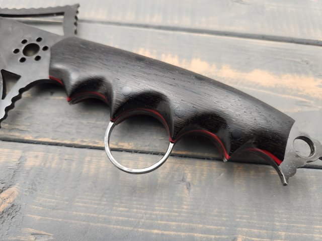

The handle is stabilized bog oak, with dark red G10 liners and black G10 pins. It features a six finger grip with finger ring and lanyard hole.

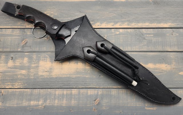

The all black custom leather sheath features both standard and dangler belt loops. The sheath also holds a ferro rod and ceramic sharpening rod, both with bog oak handles.
This project was a long time in the making, with a ton of back and forth emails. This is what we came up with, and I'm pretty happy with how it turned out. If you have any questions, please feel free to ask.
