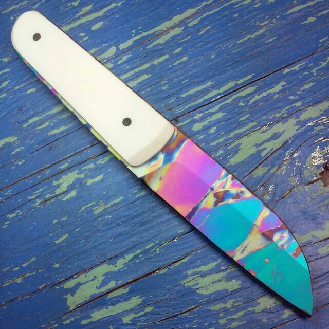

Tie Dye Titanium! Nakago Kitchen Utility

D- is the Ti showing all around the micarta equally? Pic makes it hard to tell with angle. Looks cool, specs?
Not exactly, lol there is a bit more Ti at the bottom but it still looks good. It's my first inset handle, something I planned on doing when I first designed these about 5 years ago and finally got to try. One day I want to have inset handles CNC router cut with a lip that fits inside the Backpacker handle hole to index some bolt on scales.
6" long, 1" tall, .125" thick with white G10 and black micarta pins. I plan on making more with skeletonized Backpacker style handles in the .062-.080" thick range.
