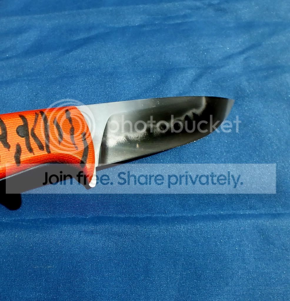

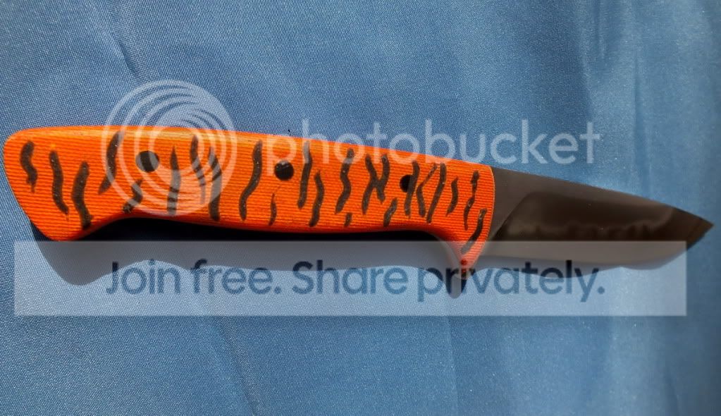

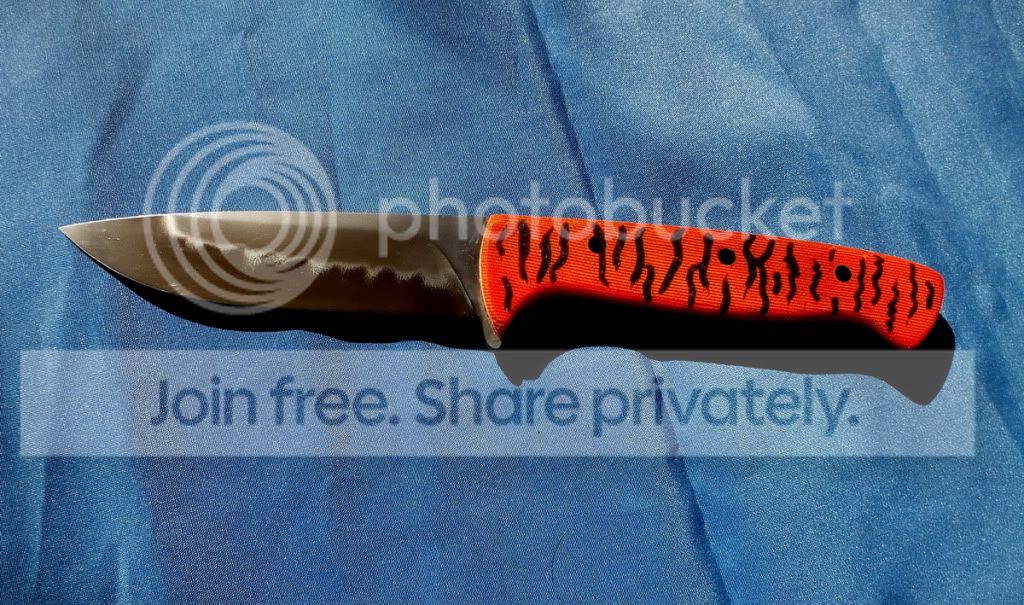

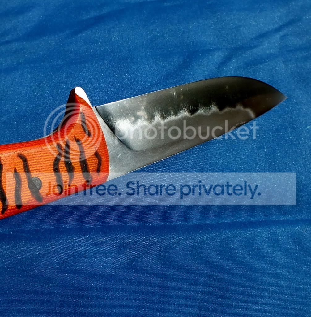

Steel is ck 60, handle is micarta. Total lenght 240mm, handle lenght 120mm, thickness 4mm. Thanks for interesting.
Sefa ( Sorry for bad English )
I don't know if I'm crazy about the orange mycarta, but that is one nice looking hamon! And a good shape for a user as well.
Is that marker? Your pins don't look very centered either? Will make a good user reguardless
Pattern is not marker. According to the pattern before the carved surface of micarta. Mixed ebony sawdust and epoxy, filled with a carved into the regions. after sanding. Pins is ebony. Thanks for comment
Sefa
I have a mammoth ivory knife where the cracks are filled with black epoxy- turning it into a "Zebra knife" that my daughter liked so much it became hers on her 6th birthday. I am sure she will love this one. I like how you thought outside the box for this one! If buying it I would prefer the pins lower into the center of the handle, but it does look like a great user with its own personality, thank you for showing this knife.
