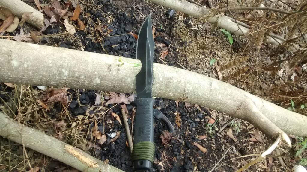

Copped through some dried Mimosa like butter. Of course I had it hair pipping sharp. Then I stabbed the limb and pried with it a little.
What happened next surprise me, because I have pried with in before in more extreme inncidents
I will get PMoore to grind a tip on it and get rid of the serrations. This is a tip strength test I do, that I don't consider abuse. Few have failed. The knife has held up well, the sheet being its weakest point. It's worth fixing. When I get it done I will post pics. O think it's best to get a knife you don't have to modify though
Wow! Great report, Carney C., but sorry about your knife tip failure.

Thanks defiant, it's been a good hard use knife. I was shocked at how easy it snapped. But like I said I will have my friend regrind a stronger too. The knife was a test knife that in many ways was a very good hard use knife. The sheath was terrible. And I have tested the tip before on much harder wood. Maybe it had weakened. It disappointed me, bit its good to know what a knife will do before you spend your hard earned money on it.
This type of tip breakage on large knives...I've seen a few over the years (decades) but it seems to me like it occurs mostly with Stainless
blades rather than Carbon ones. I wonder if that's just my imagination, or that I simply by luck I just didn't come across them.
I would place that tip failure squarly on three factors... The knife is a fighter, designed to stab flesh so it has a thin tip, Stainless steel and the length of that beast. The longer it is, the more leverage you have and the more force you can concentrate onto the tip. I am not surprised that it broke. I dont feel like the tip was designed for that task.
Sorry about that tip. Nice pics though.
I agree with Ken and Riz. Stainless is going to have that happen from time to time. And the leverage on such a large knife is a big factor!
That said, If SOG came out with one in 3v for around $200 and with no serrations, I would by multiple.
Carney, after you get it reground, post up some more pics please!
Bummer man!
But good info to see. I would not have expected that from this knife.
Years ago, I saw X-Rays of stainless and carbon rifle barrels. It was an interesting comparison, and backs up what was said here.
I agree with what many of my friends on here are saying. But I have had great performance with AUS. And yes its a tactical knife, but there is enough belly under the clip point, that it shouldn't have broken. I am going more with HT. I don't like classifying SOGs elites as just fighters. Sorry. I will get it reground, remove the serration and get a good quality sheath made. I'm so gl

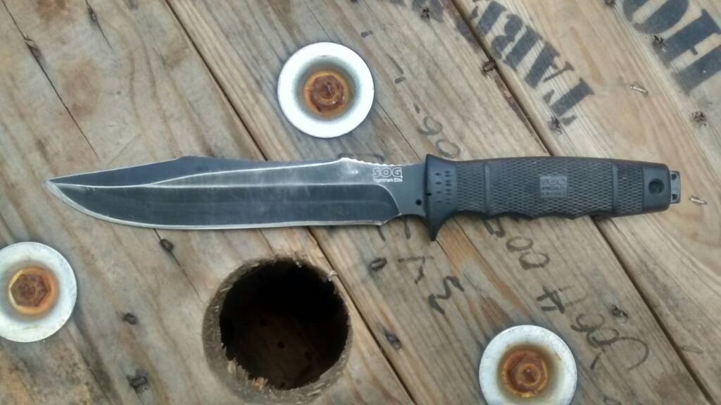

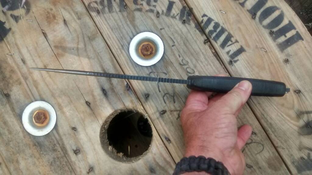

I said heck with it, I will do it myself.... Put new tip on it, took the serrations off, and took the filed spine off from tip, to the place where the spine V's. Its Razor sharp and ready to work. It actually feels better, like it's a little heavier in the blade in the around the end of the curve below tip. Removing the serrations gave it a little belly [emoji10] .. I can't wait to chop with it & see what happens!
