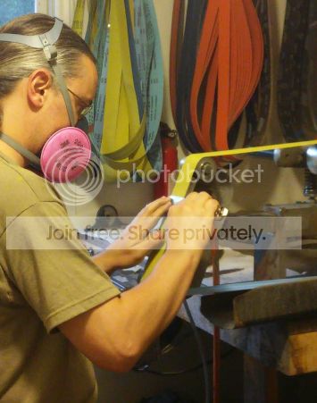

I tilt it way back and sit. It keeps my head more upright and my neck and eyes straight and my wrists aligned with my arms. It feels more natural to me. I typically grind for several hours at a stretch and feel fatigue and sore if I'm not careful.
It may or may not be the right way to grind, but I'm gimpy enough as it is and it seems to work for me.

Nathan, that looks comfortable. I assume you have a lap full of dust when you're done?
Well, most of the material ends up as chips in a can, not dust. But yeah, I do look like a brillo pad pretty frequently.
