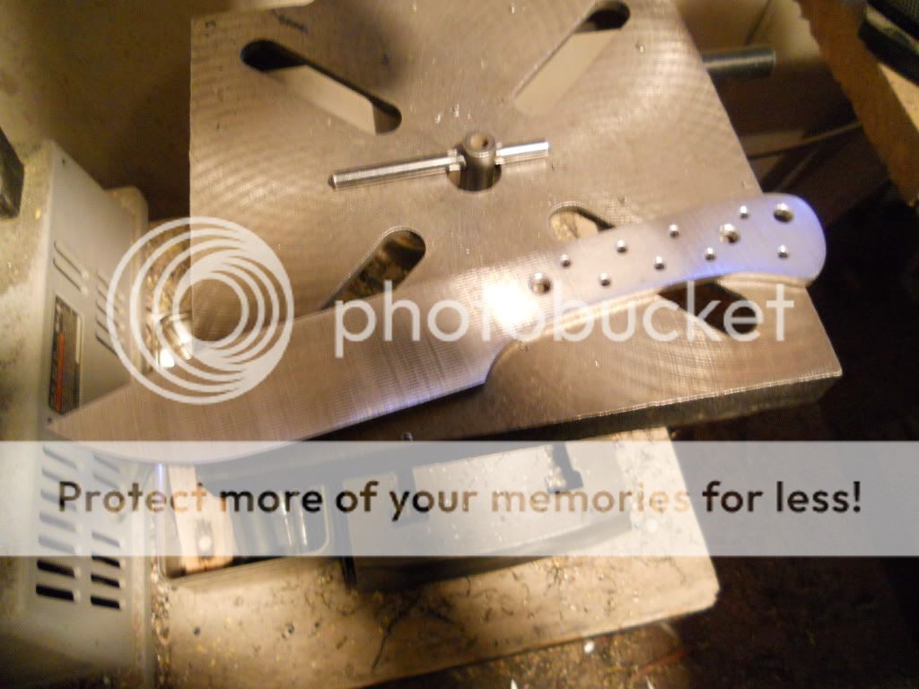

This one is partly ground because I leave some "meat" on them before heat treating, to allow for cleaning up after heat treat.
This one is fully ground because it will have the heat treat finish left on.
Next up is heat treat, which will be Monday, got some stuff to take care of this weekend. After Monday things will start moving faster.
