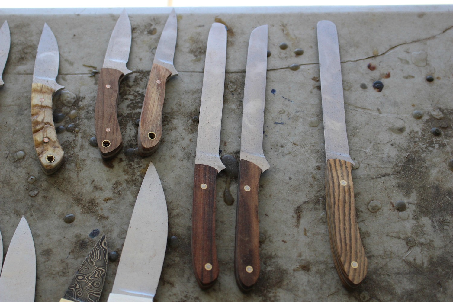

Here is the batch I was working on. Handles are profiled and ready to start shaping. The three skivers are upper right. The way I work I'm gonna make all future skivvers with bolsters. Had problems with the handle bolts being off center on the ironwood one and slightly on the bocote. The holes through the tangs were oversized and so since the handle materials were not profiled completely to the tang prior to glue up I didn't realize this. The way I build bolstered knives eliminates this problem. Plus ya look at the roundknife in the pic above and its just more classy.
So Cocobolo on the left, Ironwood in the center and Bocote on the right.
Here they are ready for hand sanding. I take the handles up to 330 grit on the grinder and then finish with hand sanding. The tangs of the knives are taken up to 600 grit while on the grinder.
During handsanding I'll start back at 220 and then proceed to higher grits. Both the bocote and the cocobolo are taken to 1200 grit and the ironwood goes to 4,000. All three will then get buffed with pink scratchless and then a coupleof coats of car wax. I'll run the blades over the scothbrite belt again and then they are ready for edges. I have finished the handsanding on these and they will head to the buffer today. We'll get to see what these guys can do pretty quick.

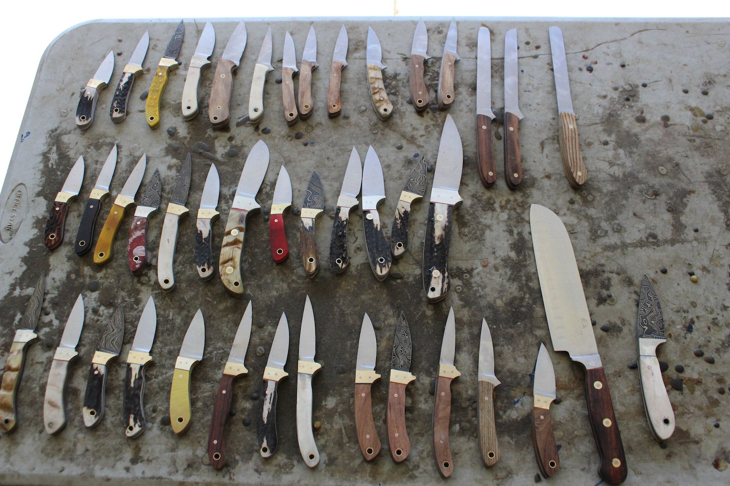

btw, what midel is the 7th from the left in the top row? looks like a nice slicer. almost went for it on your last sale, "luckily" didn't as other things got in the way. :(

Thanks for all the kind words guys. They are appreciated! Vilepossum 7th from the left on the top row is a Compadre. Quite a few in this batch. The camel bone to the left of the 7th is one too as are the two to the right. Also the elk handled one with the brass bolster second from the left and the one next to the skivvers. All these in the top row.To answer the qquestion on the edges yeah more sanding. This belt was machine sanded to 400 grit and then hand rubbed and then hand sanded at 600 grit and then rubbed again. It was like glass. However, the buckle is not a true size and it has rasped those edges up some. The belt was actually cut for this buckle and its a smidgen under 1.5" which is what the attachment loop is on this buckle. So built the belt and lo and behold doesn't fit. And you are going !@#$%%%. Why it doesn't work is the silversmith made the buckle backwards when he attached the belt loop. The loop is attached by two flat headed pins. I've got a shelf of these types of buckles that I've won. Every single one of them has the flat head of the pin on the inside (where the belt will pass through) and then peened or spread on the outside where the pin sticks out some. Not this one. This one the pins are to the inside where they rub against the belt. So really went to looking at it and even a 1.25" belt will get rubbed by those pins. So my buddy is gonna use another buckle for this belt and we're building another belt for this buckle. However it won't be carved as it is just too narrow. We'l basket stamp it or something. 1.5" is the narrowest we'll carve. Vet is coming, horses are fine we're just going for a ride, gotta go, more on the skivvers as I do have an interesting update. Ken I stand suitably rebuked. Thank-you sir! Vile I line all my belts. Two layers of veggie tan. This carved one is 8 to 10 oz Wicket and Craig and lined with 4-5 oz Herman Oak. They are substantial but my buddy that we built this belt for carries a 1911 and likes the stiffness due to the weight of the pistol.
