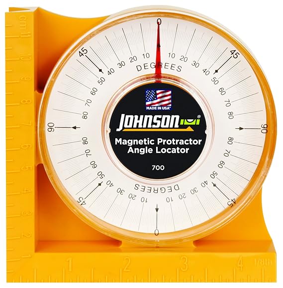

I've used this a time or two to either set a bench stone at a certain angle...or to check the angle of the arm on the Edge Pro...but to be honest, for the most part it sits gathering dust on the corner of my workbench. Works great, inexpensive and no batteries required...so I got that going for me, which is nice. It just doesn't see much use.
