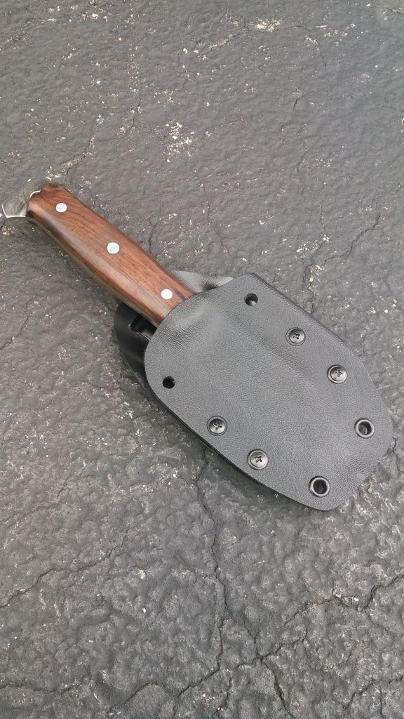

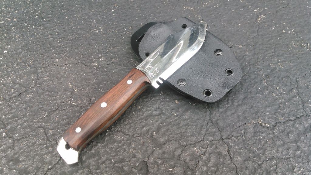

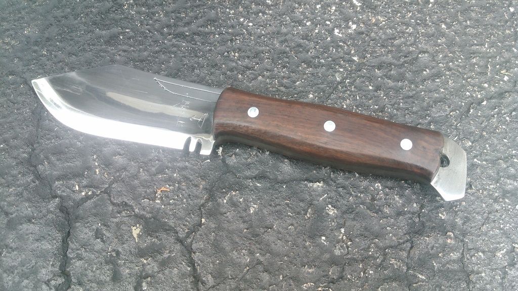

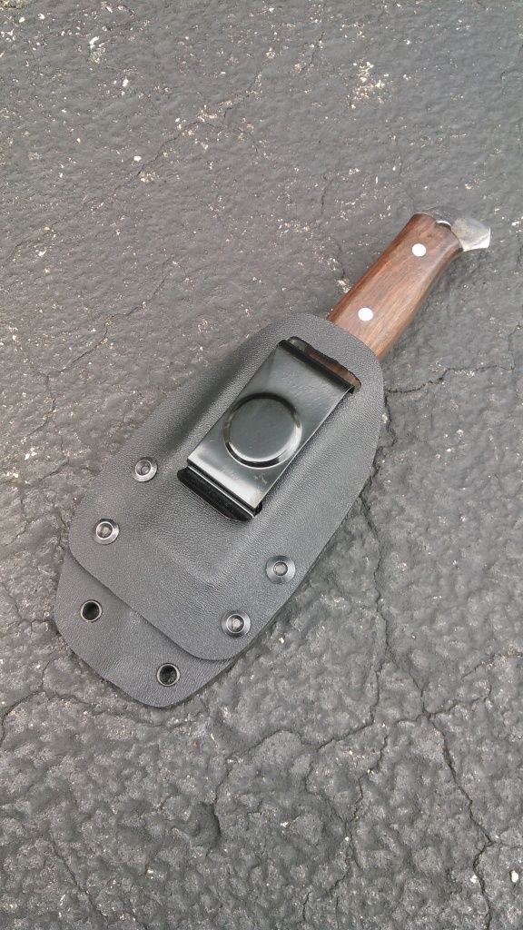

Though my collection is fairly small now, my Mini Micro Bowie by Bhakta is currently the only HI knife that I carry and use everyday, and is absolutely my favorite for that reason among others. I made a kydex sheath for it, and did some light reprofiling work on the main bevel/edge (basically a convex zero-grind) so it stays hair popping sharp. It's taken about 2 hours to get the edge to where it's at, and there's still a bit more to go. It stays attached to me from the time I wake up til the time I go to sleep, sometimes longer. I did not think I would ever part with it.
Bawanna has generously offered to do a checkering job on my beloved MMB, and it will be making the cross-country trip starting tomorrow (or maybe Tuesday). I'm both excited and anxious to part with it, but I know it will come back lookin sweeter than stolen honey. I still had to put it in the box Saturday, just to ease into the goodbye :D
Being the curious bugger that I am, I asked if we could try to do a little more than just a before and after thread, and include a couple shots from during the checkering process. He was all for it! So here are a couple shots of the knife, the first being most recent, and the others from after I made the sheath. I know they're not the best shots of the blade, but they do a great job showing the handle.

Nice looking blade, and I like the sheath too. I need to learn how to make a kydex sheath.
Nothing like putting on the pressure buddy. Like your sending your first born. But I understand, mine is with me sunup to sundown and beyond too. I'm already chanting don't screw up, don't screw up, don't screw up.
I made a kydex for mine too and I have a couple Pugs nice leather sheaths. Your kydex looks way more better than mine, nice and clean.
I'm anxious to see and hopefully not feel the edge you put on this bad boy.
The handle looks really good, from the picture I doubt it will ask for a whole new handle unless of course you decide you want one.

I am hoping you two have discussed possibly not cutting quite deep enough to give perfect artisan pyamids with sharp points, but instead opting to leave little flats on top?
I have hated to do it, but most every perfectly checkered item i have ever owned which was subject to recoil or hard pulling/pushing with hand has ended up having those perfect artwork points sanded down just a hair to blount them as they were just too abrasive to even calloused skin.
The handle on that knife, the wood, the grain, the shape, the wide expanse of bare wood, does indeed call out for checkering, fleur de lis even....
Bawanna: No pressure man! I'm sure it will come out great. I think we stick with just checkers, since I really like these wood scales too. Feel free to play with it, but you'll definitely want to tape the blade up after, maybe double :)
Thanks for the kind words about the sheath guys. Took me a couple times heating and pressing but I like how it came out. The goal was to ride on my belt at about the same height as the one it came with, but just not extend as far. The point on the other one was always poking out from my shirt. The clip plate on this one turned out to be reversible too, which was not totally intended.
mtngunr: Funny you should mention that. I am aiming to avoid the sea of tiny diamonds that is all too popular. Found a couple pictures of a more spaced out checker pattern that I really liked, and sent them as reference. He says it's called "skip line" and that he can probably do something similar (don't wanna add too much pressure, artists interpretation you know?). We had a good discussion via email and I believe we are on the same page.
I seldom bring the diamonds to a full point to avoid that cheese grater finish. Some prefer it, I had a detective that says if it doesn't wear a hole in his shirt every two weeks it's not agressive enough.

I had my leather sheaths made and did my kydex sheath so the point of the blade is barely below belt level, it rides high, which is best for me since I'm a full time sitter. I used the stretchy bungy cord through my grommets so the sheath has some flexability. If I get caught on something the knife will just move and flex until I'm not caught.

I like that bungee cord idea. I prefer clips myself because I like the ability to put on or take off the knife quickly, plus some of my hiking pants don't have belt loops :/
Mine rides on my right hip since my flashlight goes on the left (made a kydex holster for that too). Then my trusty Emerson CQC-7AW, that's the one with the drop point blade, stays in my back pocket for casual use. That one comes out first, unless I'm with people who know about the bowie. The CQC-7 is just a tad more sheeple-friendly, even when I draw it with that all-too-satisfying "CRACK!"
