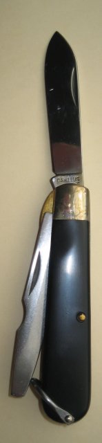

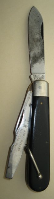

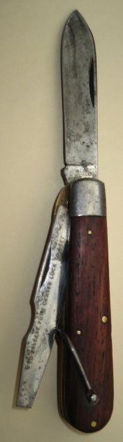

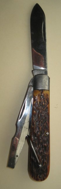

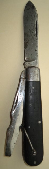

Here are pics of a few that I have:

The first electrician's knife with the black handles (only 1 pin showing on each handle) utilizes "studs" to attach the handles to the linings. The studs are molded into the handles and extend through the linings to secure the handles. Camillus introduced this design in the early 1970's and made millions of knives with this feature.
All the other knives have pinned-on covers.
Tom Williams
