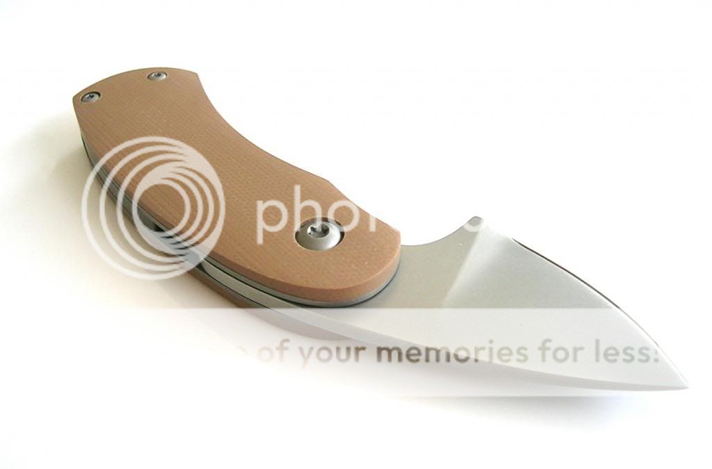

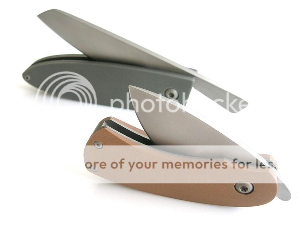

That said, if you want a small knife for her, I can recommend the Dragonfly and the Ladybug in ZDP-189. Frankly, it may be a while before either is produced in M4. If you like the Ladybug size, but want some jimping, give the Manbug a look. Blade under 2" long but a nice feel to it.
