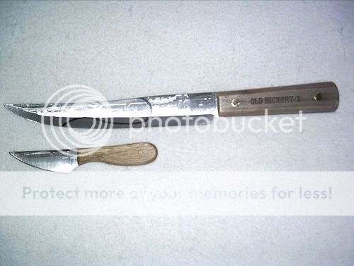

One thing about the Hartsook: there is so very little to it, apart from some of the clever design features, that I wonder if one couldn't make a very credible high-carbon replacement with an Old Hickory paring knife and a Dremel tool, for about a quarter of the price. I'd pop off the rivets and the wooden scales, maybe insert the blade into a potato to avoid drawing the temper, then try grinding a choil or some other finger-friendly curvature to the handle part, perhaps enlarge or add a hole for a Hartsook-like paracord loop (because that is, I think, a genuinely-great feature of the latter knife), cut a few jimping notches in appropriate spots . . . . It'd be an interesting project. Also, one could try a similar trick with some of Old Hickory's larger knives, which would give you a little wider stock, again potentially allowing you to get plenty of grip on a very short handle. I could imagine getting some seriously-excellent handle-handling mileage by combining a Hartsook-like loop and jimping with a Sicut Mintan-like handle structure. If any of you knifemaking types try any of this out, I'd love to see your results.

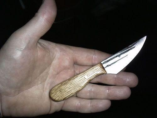

You can make a fine necker from a Old Hickory...

Pretty neat, Todd. I was just thinking about doing something similar with a Cold Steel Bushman.
Todd, that is absolutly the neatest thing I've seen in a long time. Small, but very effective looking. You did a very good job.:thumbup: :thumbup: :thumbup: :thumbup:
