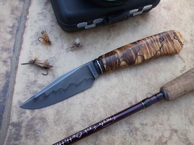

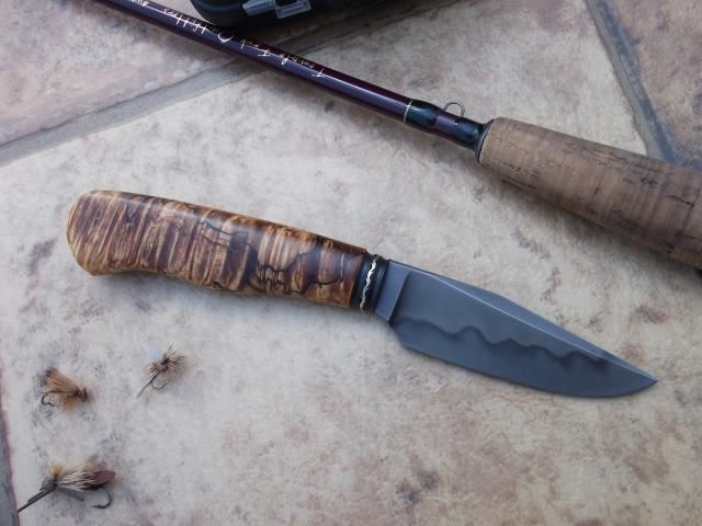

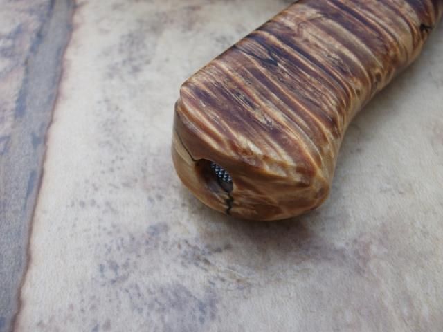

This is the latest out of my shop. It completes a commissioned order for two small hunter/utility type knives. One ground and full tang, and the other, this one, forged and hidden tang. This is the smallest and thinnest knife that I've forged.
Specs:

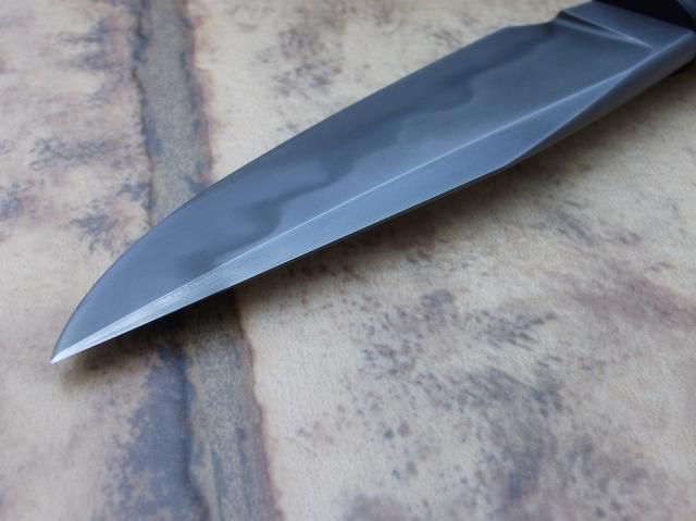

Hand forged from 1075 steel, clay quenched and etched
7 1/4" overall, 3" blade, .160" thick at the ricasso
Full distal taper and an almost but not quite sharp clip makes for a really light knife with a needle point
Rounded spine and ricasso edge for comfort

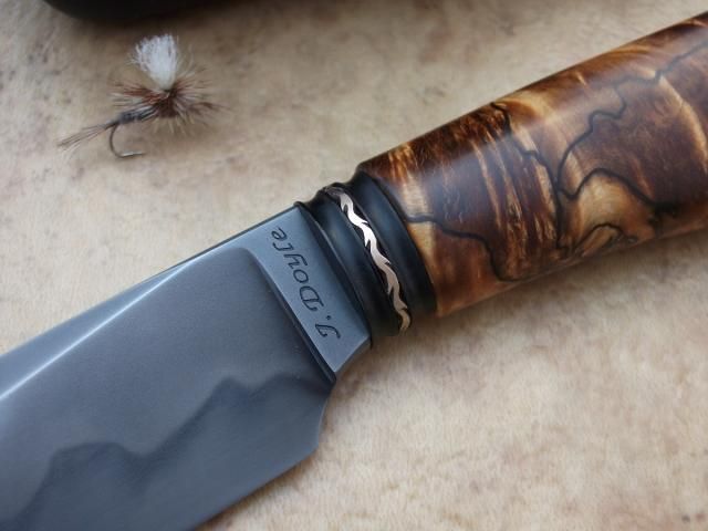

Black g-10 collars
Bronze fileworked spacer
Stabilized spalted and curly box elder burl. It has some really nice almost koa-like figure and chatoyance.

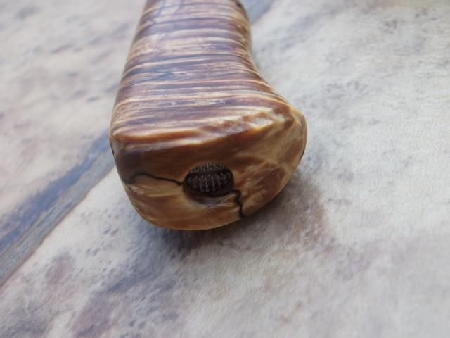

Checkered stainless steel finial nut
File carved fuller on the butt end of the handle
All comments and discussion welcome. :)

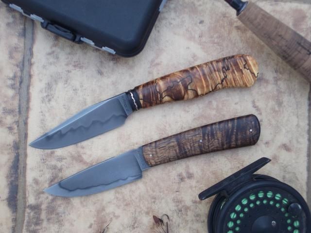

And here's a quick photo of both (the other one, I posted up a week or two ago.)
Very nice john! Great finish on the handle and I love the simple but elegant file worked spacer. Nice touch!
Someone's gonna be happy!
That's the kind of knife I always want to have around - I'd find about a hundred uses for it. Stunning wood and nice detail work on the spacer elevate the whole piece.

Real nice pair, John. (some clever person will likely chime in with "And the knives are great too")
so cute! Love that shiny file worked spacer, it totally sets the whole thing on fire. Winner winner chicken dinner!
I concur with the gentlemen above... One fine small knife. As close to perfect as I can make out from here! :eek:
