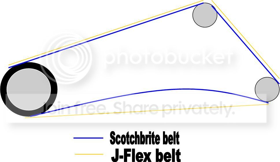

I know that I can't be the only one who occationally gets those annoying horizontal grind lines on a long blade. They often come when you lay the blade flat against the platen and always start at the plunge. That might be a good way of starting a plunge, but unless you tilt the tip away from the belt you end up cutting a gash with the opposite edge of the belt as well.
I was recently working on a 8" Chef knife and noticed a few of these grinding imperfections. I admit it, I get them from time to time... well, most of the time on long blades. Suddenly I remembered a trick that Dan Graves showed us at the last hammerin. If you haven't gone to one of his, you SHOULD!
His trick is to stack up a scotchbrite belt UNDER a 360 J-flex blelt on your grinder. It takes a few tries to get the tracking and lining right so they don't slip off, but my goodness, this method works great! Use it on a slack belt as you would to get a convex grind. The extra stiffness behind the J-flex helps to keep your flats straight while blending in the grinding imperfections.
I forgot to take pics, but here is a crude diagram to show what I'm talking about
As you can see the scotchbrite belt is usually a bit longer than the J-Flex, so it will buckle/bow up. Try to make it so that happens between the contact wheel and drive wheel. I'm not sure if I tried this using a flat platen but it will certaily work as a slack belt.
Give it a try sometime. I image this method would be a good alternative to the multiplaten as it is basically the same thing - a slack belt with stiff lining underneath
I've tried that before, and it works great.
The only problem is that it usually takes me several trys to get both belts aligned properly.

How would that compare to using a rotary platen?
I must admit that I've never used a rotary platen but my understanding is that there are two main "magical" benefits to it. One is the ability to choose the amount of slack behind the belt. This is done by using wheels that are closer/further apart. The other area of benefit the RP has is the cushioned belt that rides behind the grinding belt. This gives you somewhat of a firm backing that still countours around the work piece.
The later is the reason I suggest this method might be a good alternative to the Rotary Platen. I don't mean to suggest this replaces the RP, only that there is a way to get a firm slack belt without having to spend $500 on extra equipment.
