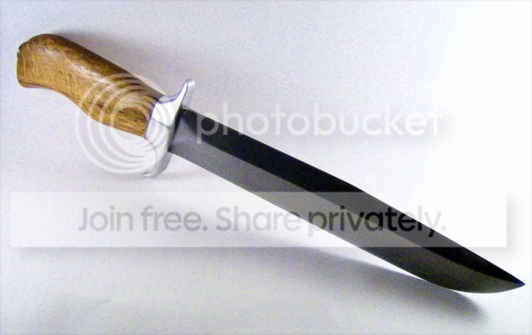

I do quite a few double edged pieces, daggers as well as bowies etc. and have tried lots of different methods.. my only tips would be to leave a small flat 'ridge' along the spine of the 2 bevels until the final grind when they are joined. I also do the primary bevel after the secondary one is roughed out, I find it makes it easier to get the center spine right..
here is one I recently finished, bear in mind I'm no expert:)
