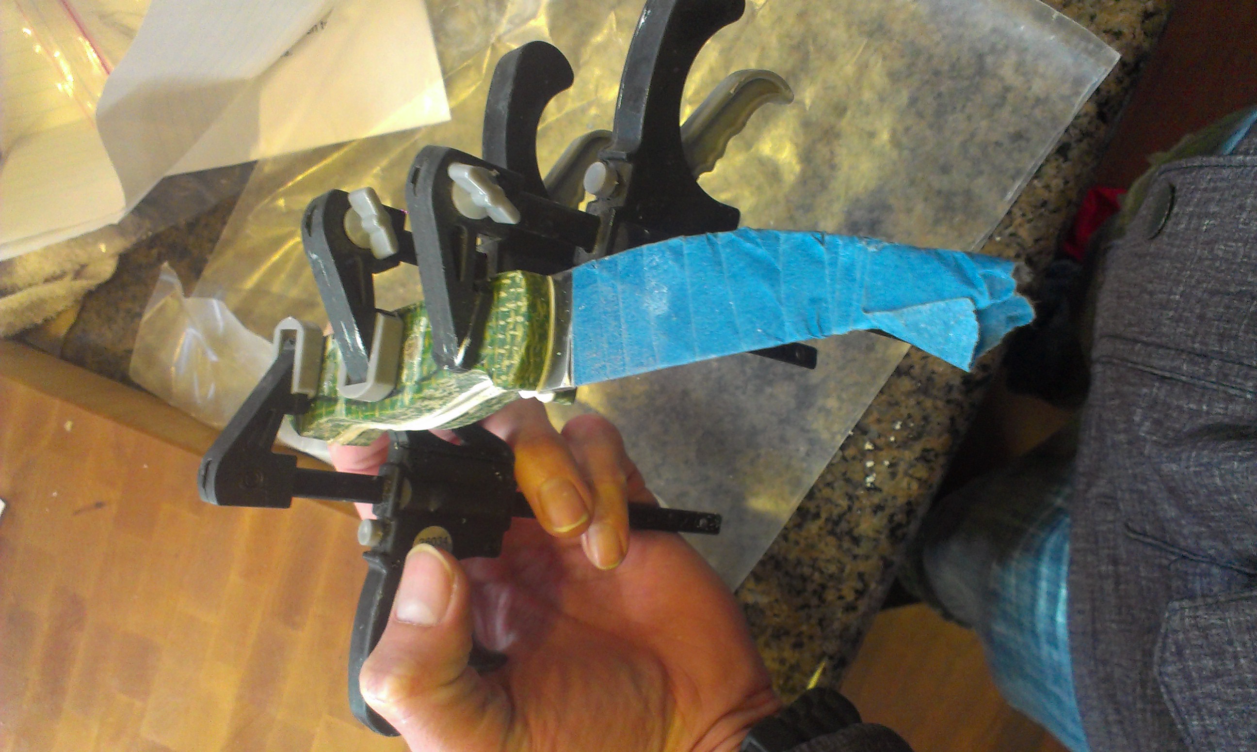

Here's a pic of my last glue up.
Light pressure from whatever clamps you are using is advised. Because there are liners on that one, holes were drilled through them and into the scale material being careful to not drill so deep as to have any of the holes inadvertently exposed while grinding/shaping.

When you say tang, you are meaning ricasso. So long as you manage the squeeze out you shouldn't have a problem. In the pic I posted I had plenty of it. In fact, my epoxy was colored white so keeping squeeze out cleaned up was of the utmost importance. Even so, it was just a matter of wiping it off with the above mentioned acetone on qtips.

I found that by temporarily mounting the scales over a Pc of tape applied to the ricasso and under the scales, then using a X-acto knife to carefully trim around the scales against the ricasso. Take the scales off, remove the tape that was cut to match the scale but leaving the Pc on the ricasso in place. Glue up the scales and after they set you can just remove the tape and the excess epoxy goes with it. Pretty simple and clean for me. I use a thin film tape used in powder coating but I would think packing tape or electrical tape would work ok too?

I put the tape on and trim also. I also put tape on the front of the scales. I use scotch tape I think it works well. If I feel that I may scratch the ricasso I use a sharpened brass feeler gauge. Most sets have one and they are somewhat hardened. Jess

So, after that mess I ended up reshaping the handles slightly again and then just throwing some masking tape on the ricasso to keep it from getting polished. It worked like a charm. There was no trimming of the tape involved or anything. Anyway, here is my new knife. This is the fifth knife I've made. Bevel was ground partially with a jig and partially freehand. I still have some work to do to get the grind to match on both sides at the ricasso. :/ Knife porn below...
