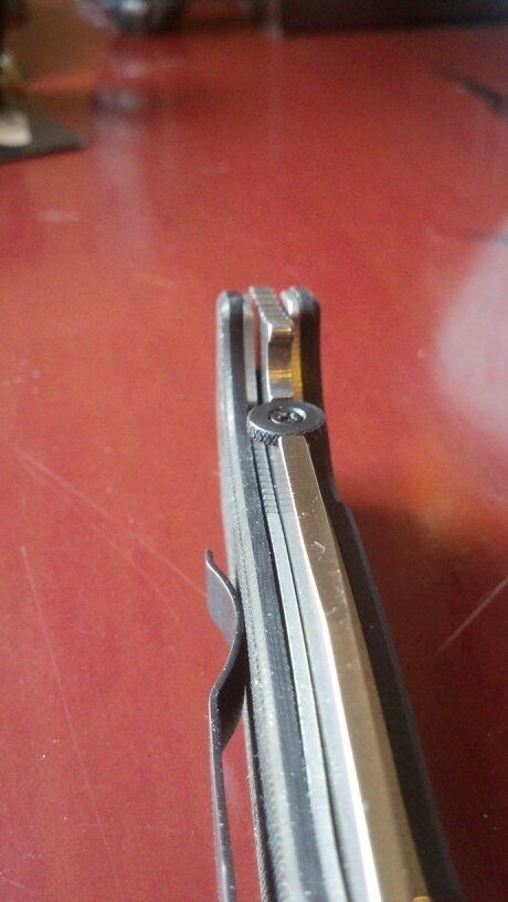

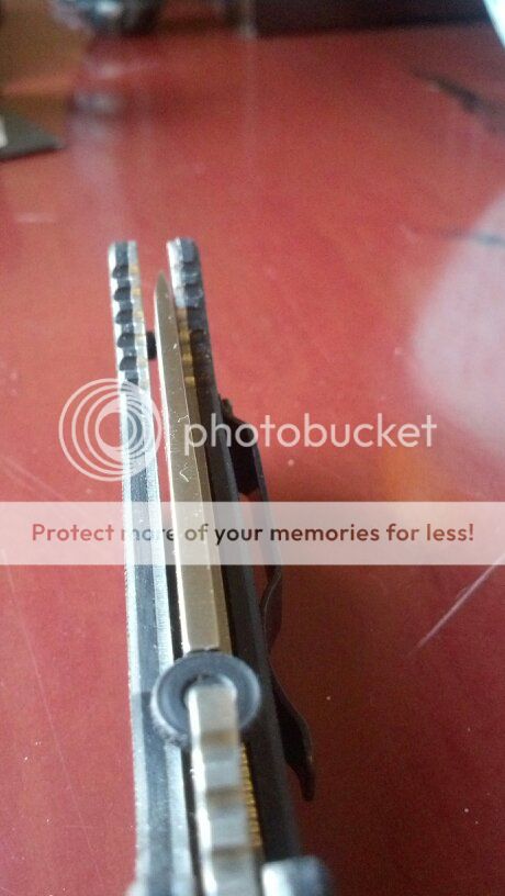

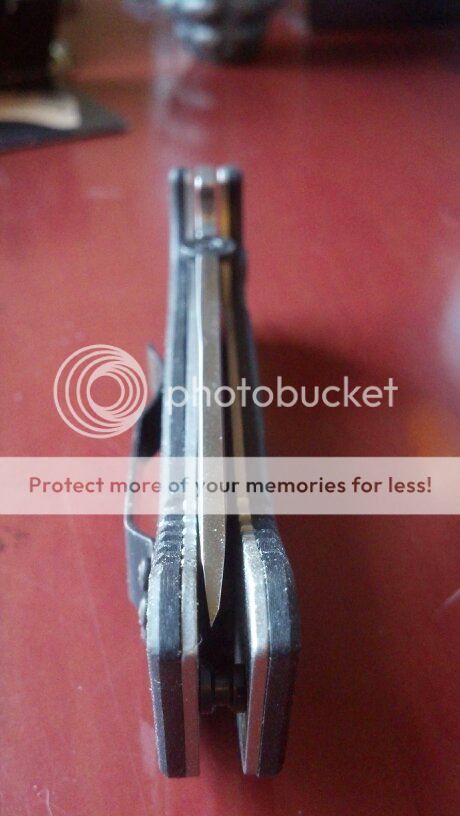

I just picked up an ETAK two weeks ago and tried centering the blade myself via the method described in this thread with no luck, I think I will send it to Emerson to see if they can fix it for me. Love the knife though and can't wait to carry it.
Most Emerson's appear to be off center because of the chisel ground blade. If it is off center it will appear a lot worse than it is.

That one is off-center. The tip does sometimes throw your perception off, but looking down the sides of the liners is a dead giveaway on that one. Emerson will take care of you, though.
