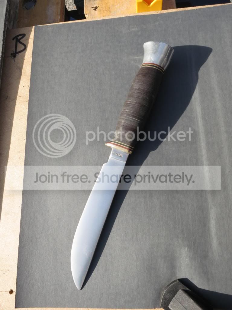

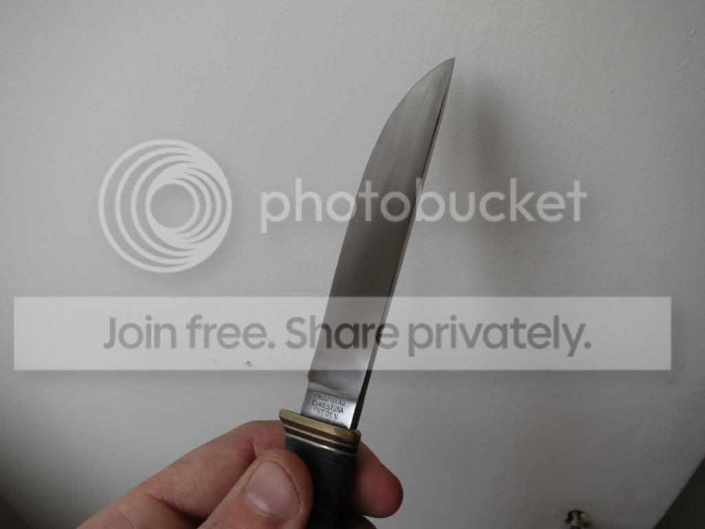

To do list

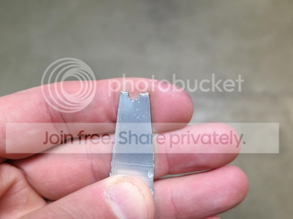

Make tool to loosen but nut

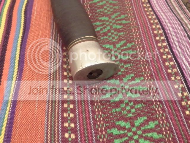

Straighten tang
Glue pommel to spacers
Reprofile the convex grind
Give it tip

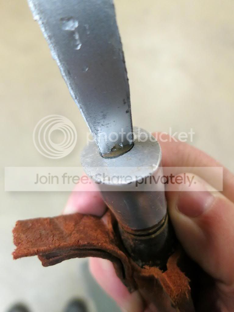

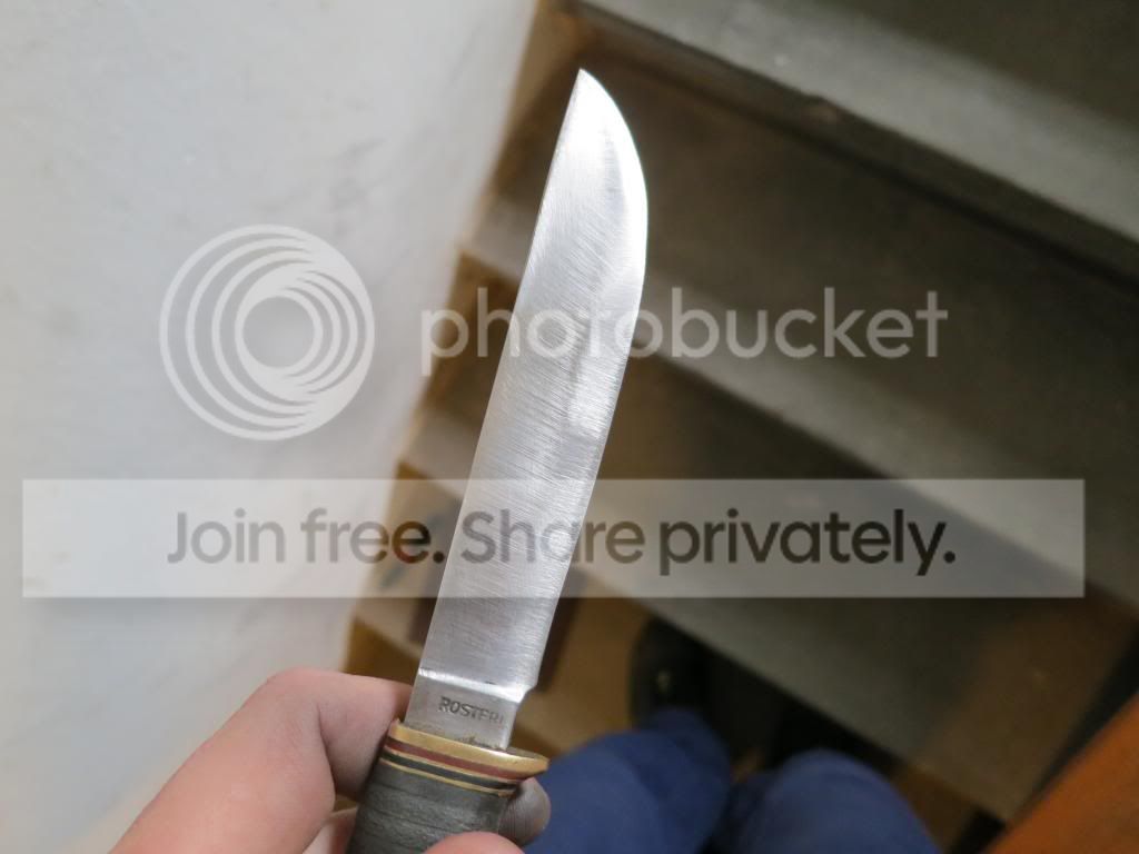

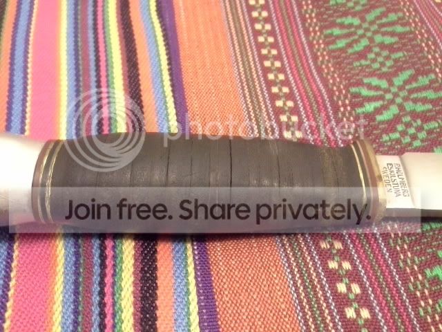

The state of the leather is hard fore me to judge. Its hard and gives a hollow sound when tapped. The distance between the disks is slightly larger than esteticaly pleasing at three places. This coud be fixed whit colored vax ore fat. I'm not shure if I should replace it or not.
The choil is to narrow to fit a finger. It would need to be twice as long. this would really change the overall appearance of the knife and take away any collector's value. I'm leaning towards this but does not really know yet.

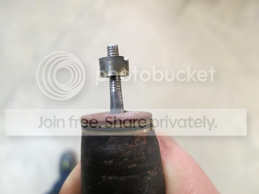

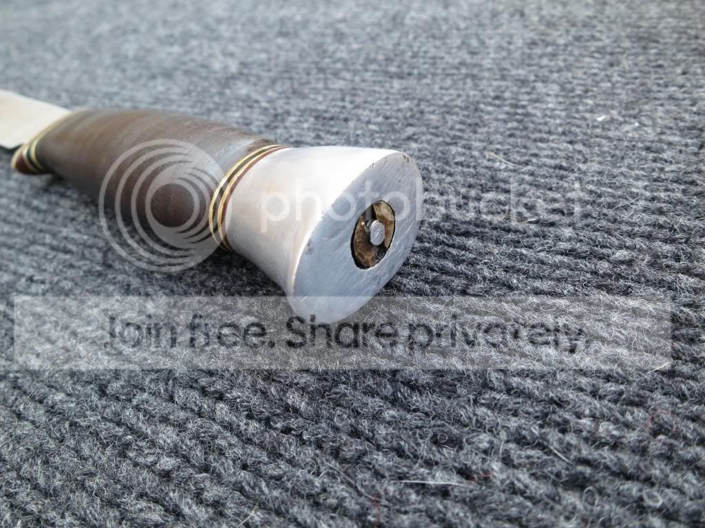

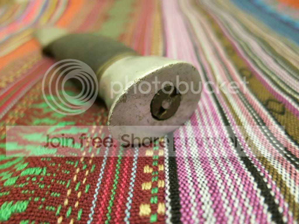

You might be able to tighten up the handle by removing the nut and pommel and tapping the tang threads down a bit farther, you might need to file the area a bit to get the tap to go farther then reassemble and tighten the nut and carefully grind, file sand the excess tang end off. I did that with an old hard used Marbles and used fine steel wool to clean off the rust and the crud and a good edge made it back into a solid decent looking knife, that was still very original. I also used Obenauf's oil on the leather.

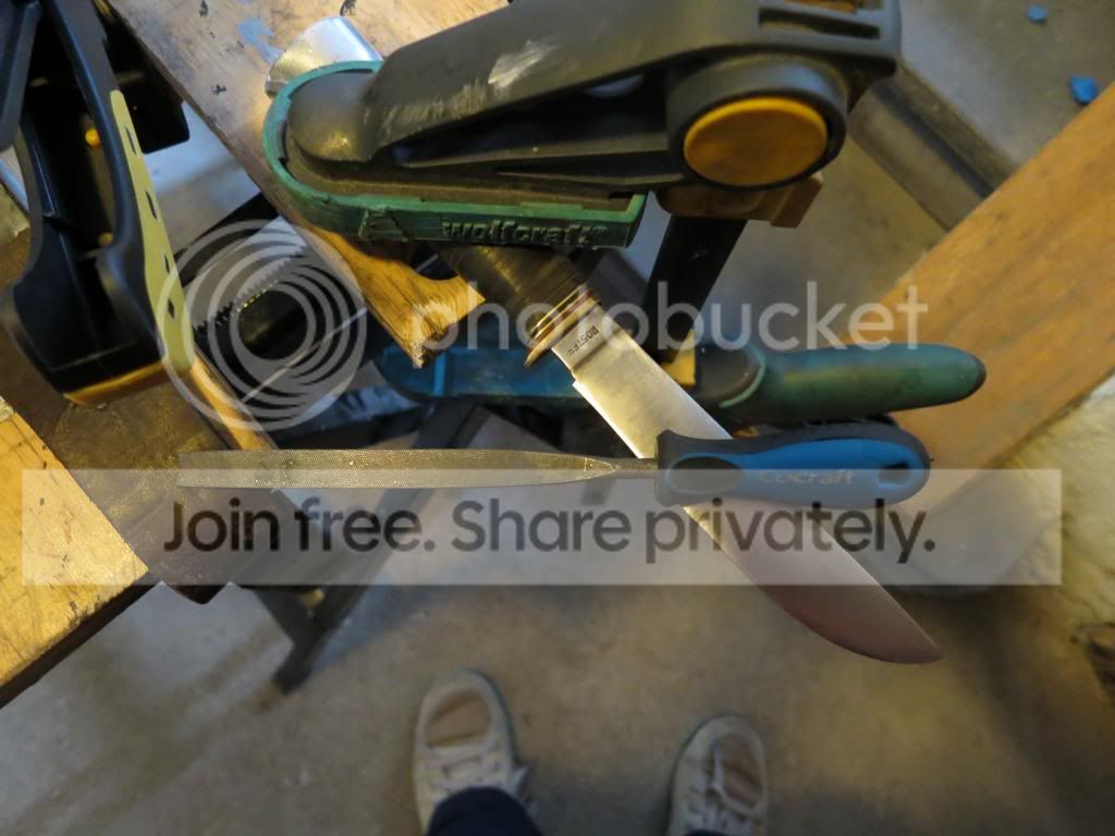

Really helpful tips here! :) I ended up making a small tool out of aluminum.
I have 3-4mm of good threads left.

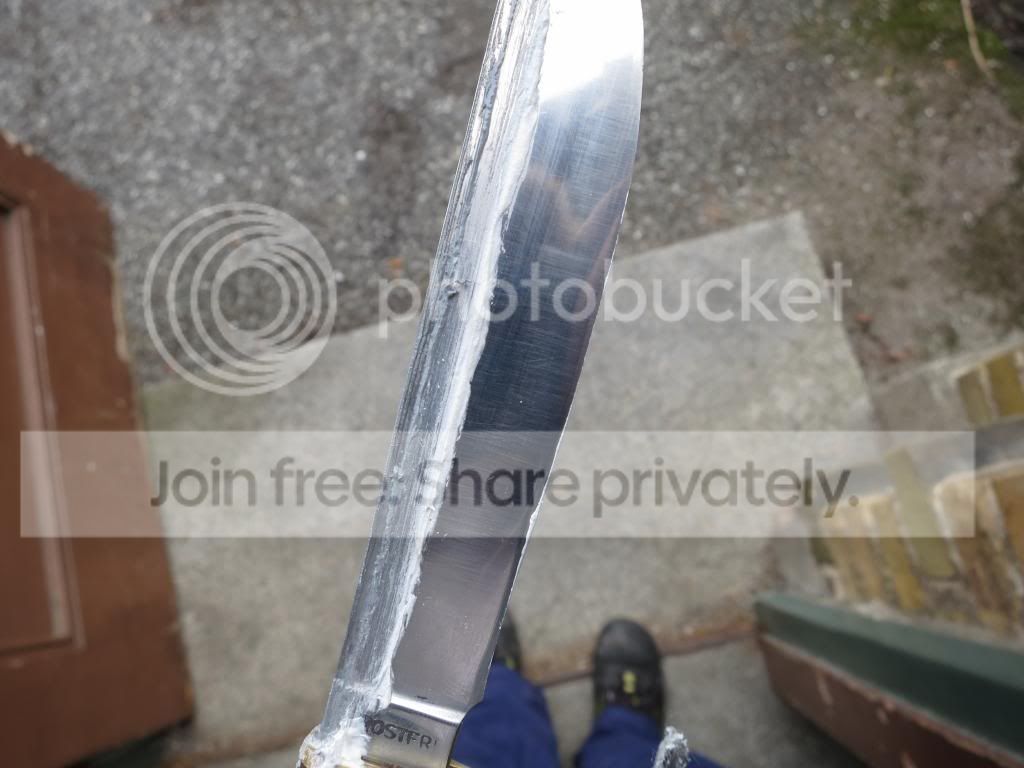

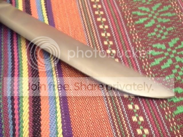

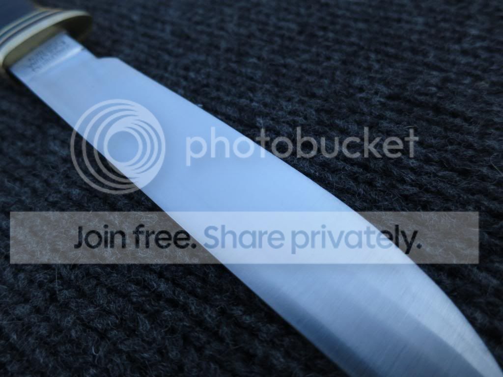

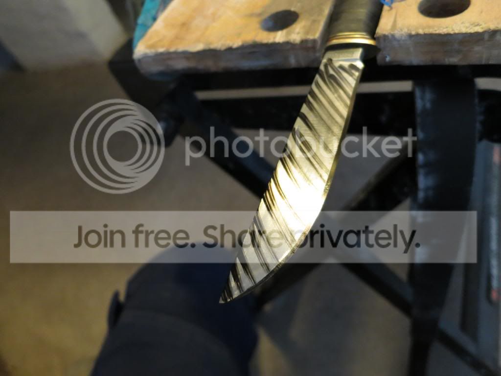

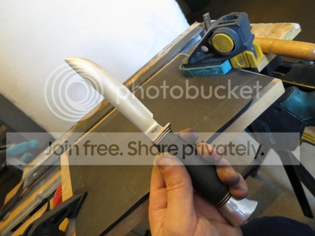

Rough shaping of the blade.

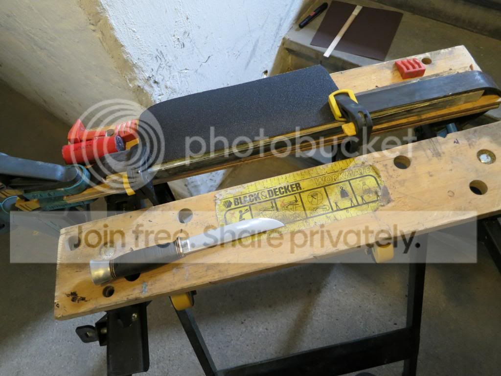

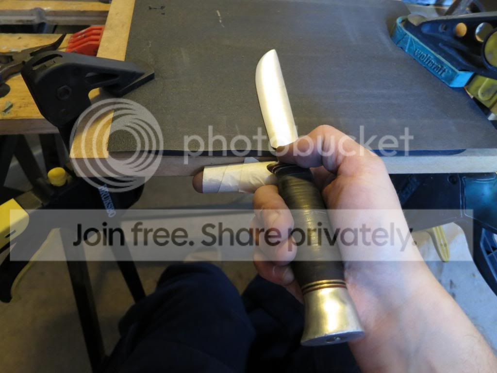

I have never put a finish on a convex grind before. Is sand paper on a stick or waterstones prefered.
It looks like a flat grind in the photos. However, if it is a convex grind, put a leather strip on the sanding backer and sand away.

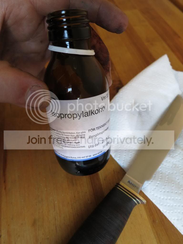

Chrome polish

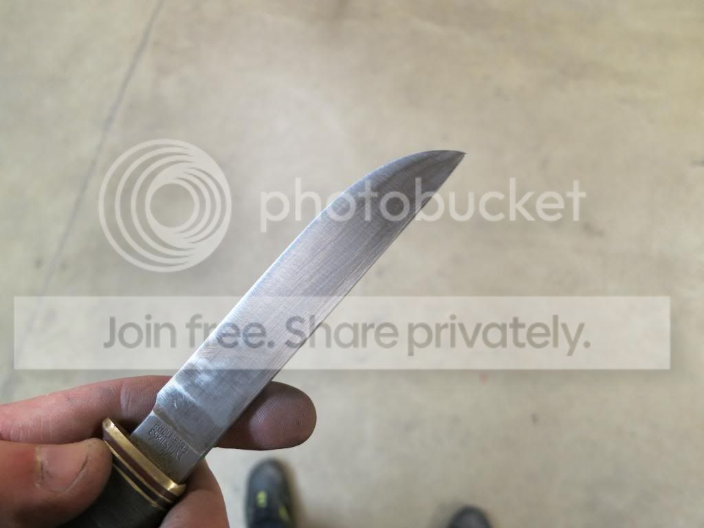

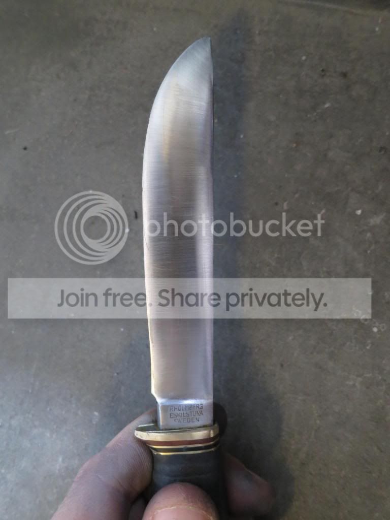

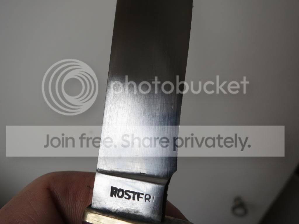

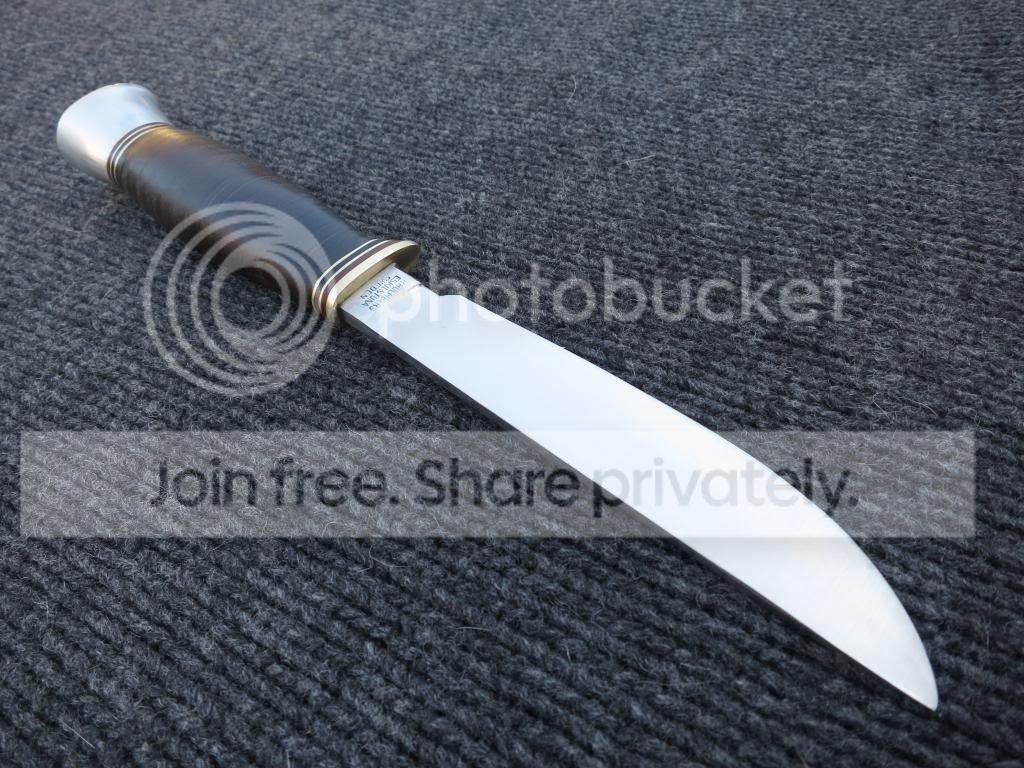

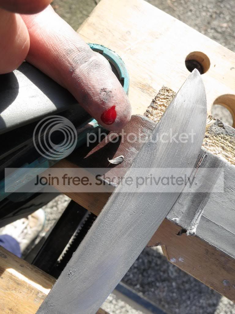

Over all shape is done. Some scratches still remain and the part just in front of the ricasso needs to be taken down.
I have gone from 180 paper to polish. I might have to do it one more time but focusing on the flaws this time. :)

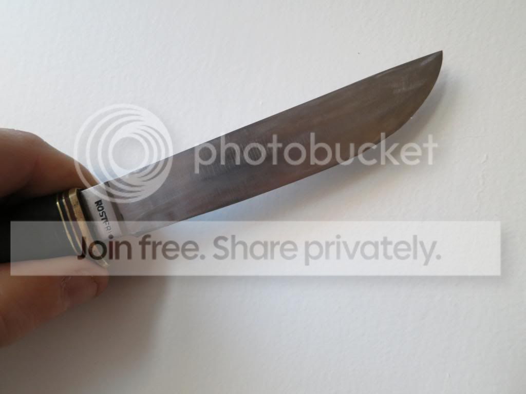

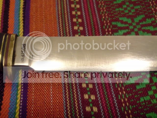

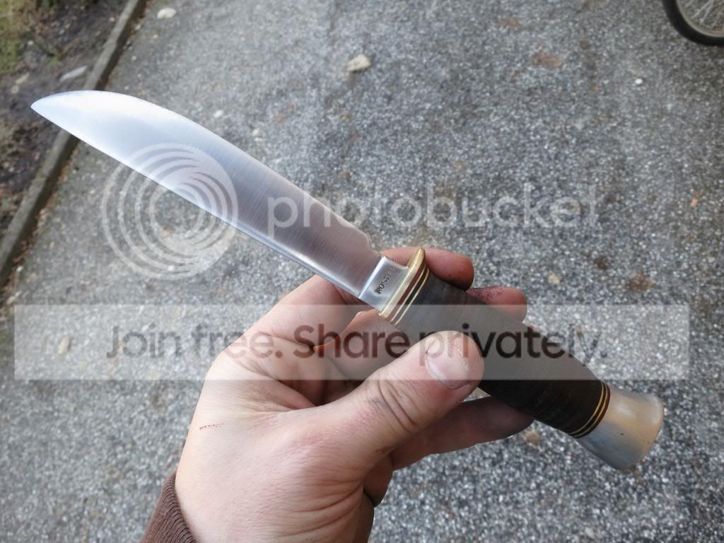

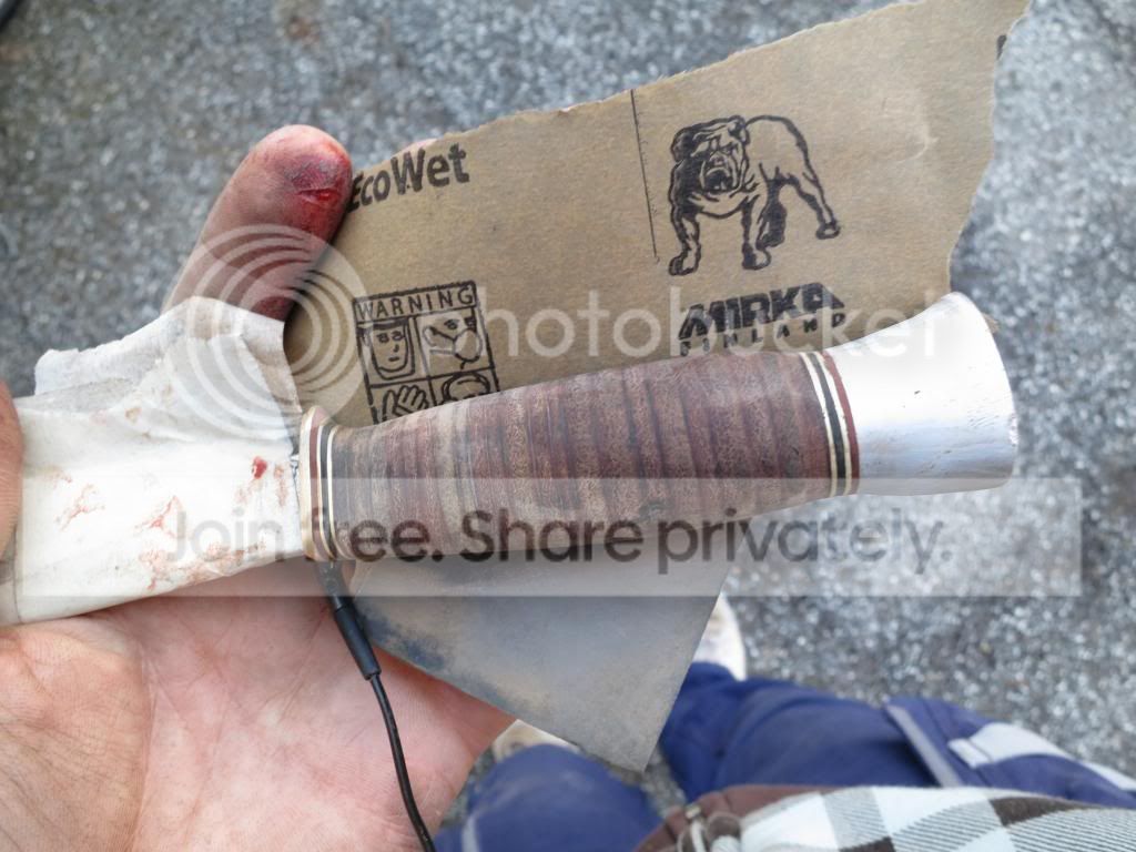

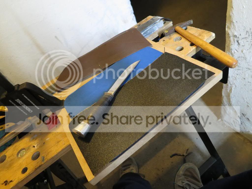

Finishing time! Moved on to the old mouse pad jig with full size papers. 180-1500 papers and then stropping.
Can a SS convex grind really get that bite? Yes it can.

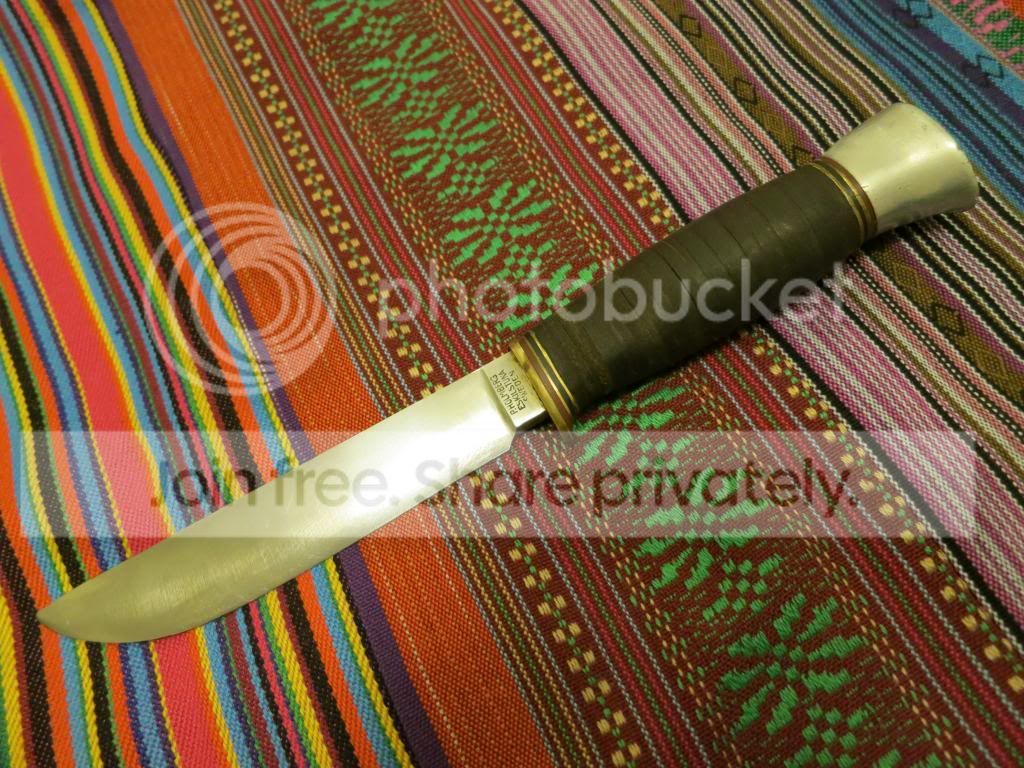

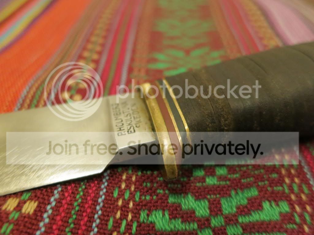

I'm not the firs guy doing post work to the knife. The pommel and the guard has sharp edges that needs to be taken down to avoid blistering.

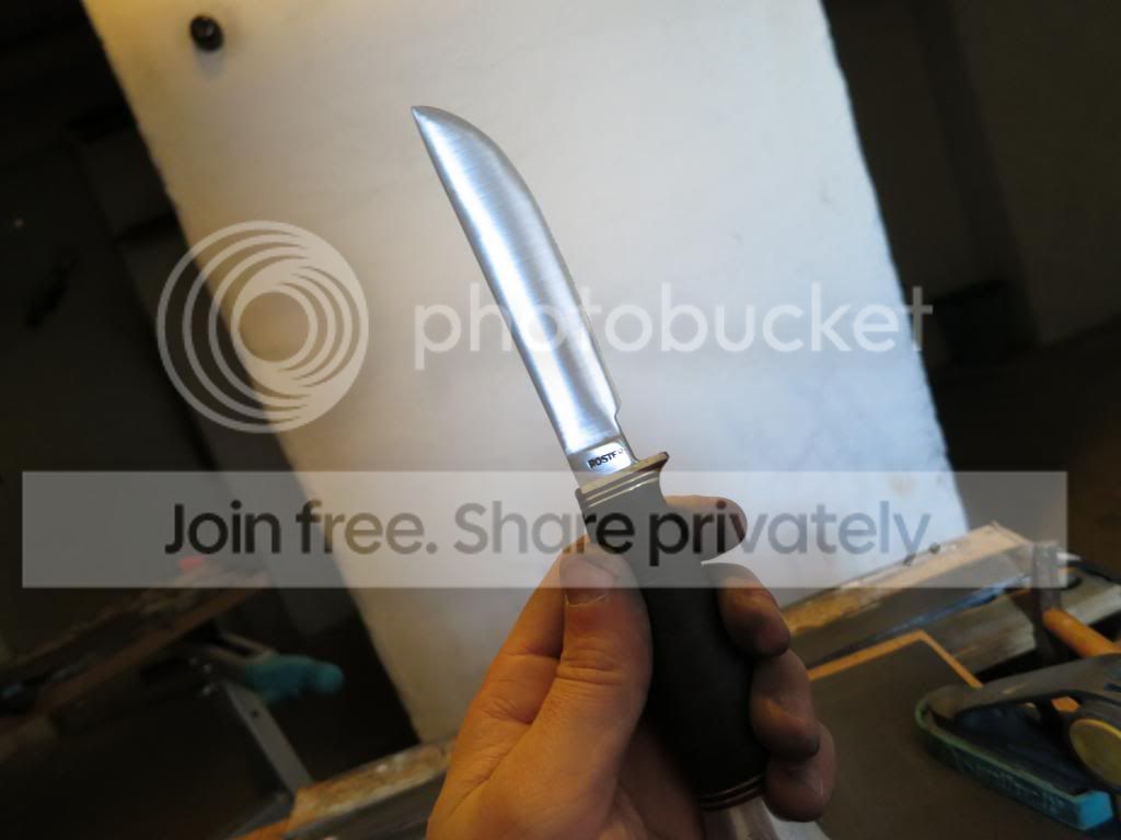

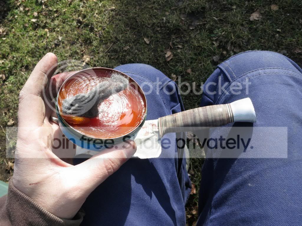

Just a fast 180-600 paper an the steel wool on the handle. Finishing with viking fat.

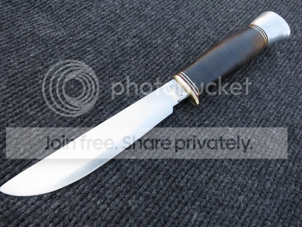

Wnt back to 600 paper on the blade to get a uniform finish.
Thanks and good question Karl. Its a wax-fat that i got from my father in law. Its supposed to water prof and protect leather an keep it "ductile". On the down side it cant be polished.
It has shifted maker but the line "Viking Fiskar Smorning" will still get hits on Google. Fiskar Smorning does not really mean anything in modern Swedish but if I had to guess i would say "Fisher(-man) smear/spread".
