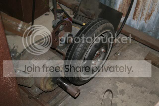

I advocate using a shaft with an eccentric wheel on the opposite side of the tire rather than trying to attach your linkage directly to the tire rim. Keeps you from having to do any welding on the rim and causing problems from that. Safer, easier, and just a bit more material.

What he means it the round plate on the other end of the shaft from the tire. It should have a series of holes drilled on a spiral path from the axle. That allows the linkage to be tuned for how long a stroke it gets.

I took measurements and pics, but looks like my memory card reader has pooped out on me. Here are the dimensions at least; all *very* approximate. The contact wheel on the motor is built from oilfield pipe and is about 2 3/8" OD. The spare tire is about 19 1/2" OD. It hits at something on the order of 200 beats per minute, but that's a bit slow for a power hammer.
Ok, got a new memory card reader.
First, here's a side view of at least part of the hammer to give folks an idea of the basic design:
This is what I was talking about with having the tire clutch on one side of a shaft and your eccentric on the other so you aren't having to weld on the tire rim:
