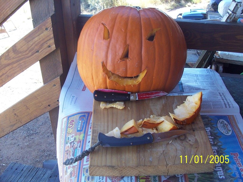

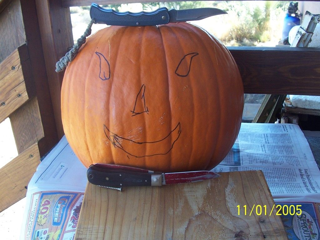

Ok, I'll cut up some more pumpkin using this knife which is a Buck (Camillus made) and has a flat grind blade of 420HC. I'm uncertain on their heat treating recipe but we'll say it's near the same and of good quality. I don't recall this models number (334) but I couldn't find another model quickly with a flat grind. I know it's mfg. is from around 2000. I came up processing meat even before university meat science. So, it's not like I have little experience using a flat grind. Probably more than most here. So, I'll entertain this notion in my topic for certain satisfactions. DM
Ok, I think I've got it sharp. I took it first to my Norton JUM 3 coarse crystollon using a 15* guide. Then on to the fine crystollon and finished it off on the Norton fine India. DM
The 426 has a tip that is a wee thinner than the Buck Trapper. So, I noticed the first 1/4" inserts a little easier. I would insert it that far and began a rocking cutting motion, with both knives. Once I had the eye outlined I'd then go back over it deeper. Following this pattern until the item could be lifted out. The surface skin was tight and hard. Still both blades went right on with no hang ups or hesitation. I could push it on through the thickness and pull the blade down and it cut. Both types of grinds were well done. I've see some flat grinds with convex edges the would have hung up and required more force. Like a 110 two dot. Which has a thick convex semi hollow grind. These didn't. Even the shoulder on the bevel of the 426 I could feel slightly more than the shoulder on the Trapper. But apparently it wasn't enough to separate a difference in cutting ability. The two were very equal. If someone could notice a difference in the way they cut they are better than me. If the blade grinds are done well (thin). NO thickened shoulder at the bevel it will be hard to notice a difference. But if they are thick in that area it will be noticed in the amount of force required to make a cut or insert. Also, if you have a favorite grind then use that and enjoy it. Saying, something like I prefer this grind. Not this one is better. As there are many factors that come into play making one better.
Now, with softer materials, like in skinning you may not notice the extra force required to initiate a cut with the convex edge. Because the softer material gives, allowing a cut to separate rather than resisting. Just what I noticed while conducting these tests. Which are on going. I'll give the Trapper to my wife and let her use it in the kitchen and see what she notices. Then the next chicken I cut up I'll use it and see how it performs. So, that's the story for today. DM

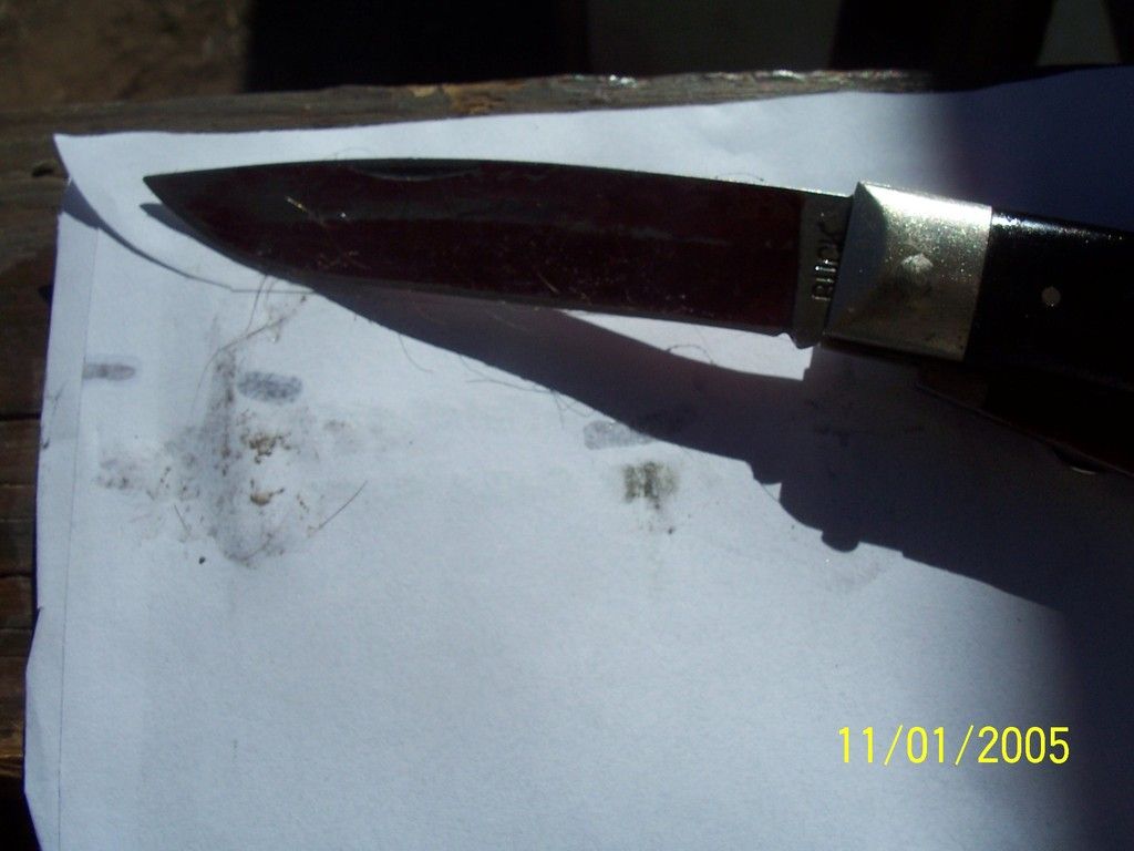

OK, I was able to conduct a different test today. Upon arriving home I noticed we had a chicken injured. Who knows what from but most likely from a wild animal coming by and spooking them. So, I processed the hen for the freezer using the 334 jumbo Trapper. All went well until I went to separate the 2 thighs, the pulley bone from the breast and half the breast. These being the heaviest bone structure. The blade require extra force to initiate the cut. More so than other knives. Was this a function of the grind?
I doubt it. As the edge wasn't penetrating anything at this point just bone. And I don't think the grind is too thick. As my wife used it this morning to slice tomatoes. Which it cut fine. It could be the steel as I've noticed the powder metallurgy steels initiate hard cuts with less force. Another possibility is this chicken is 7 mos. so older than most I process. Take your pick. This is additional cutting information to ponder. DM
