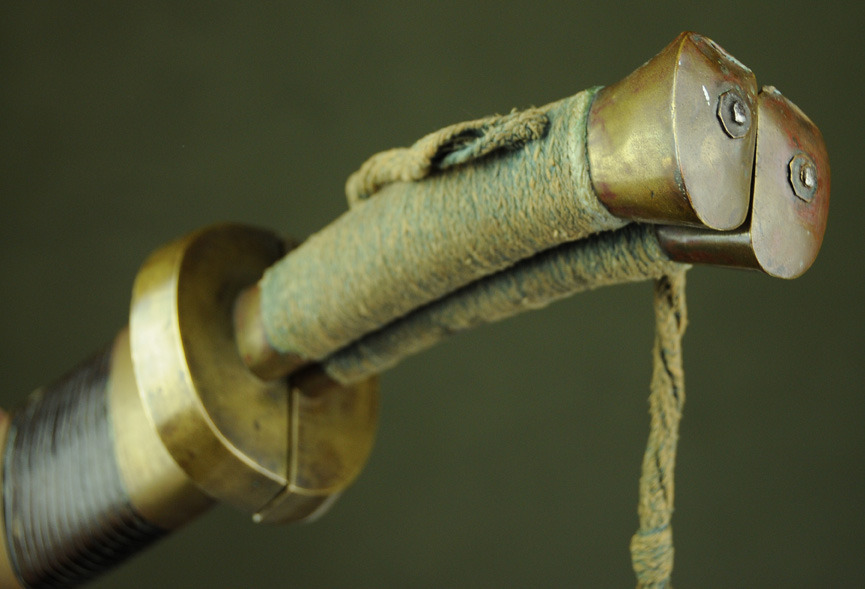

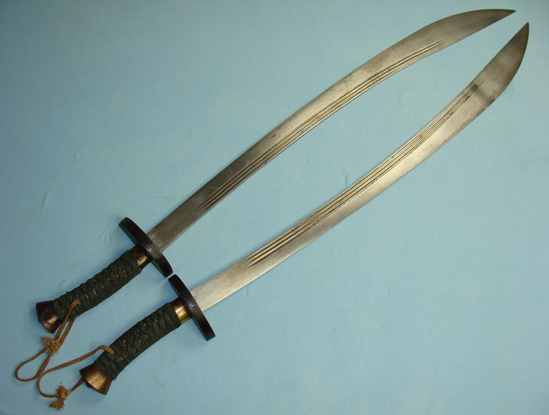

Also i might need to get my vision checked because i see a Dao in it, not just dha. These two blades have very similar background.
* image from SwordsandAntiqueWeapons
