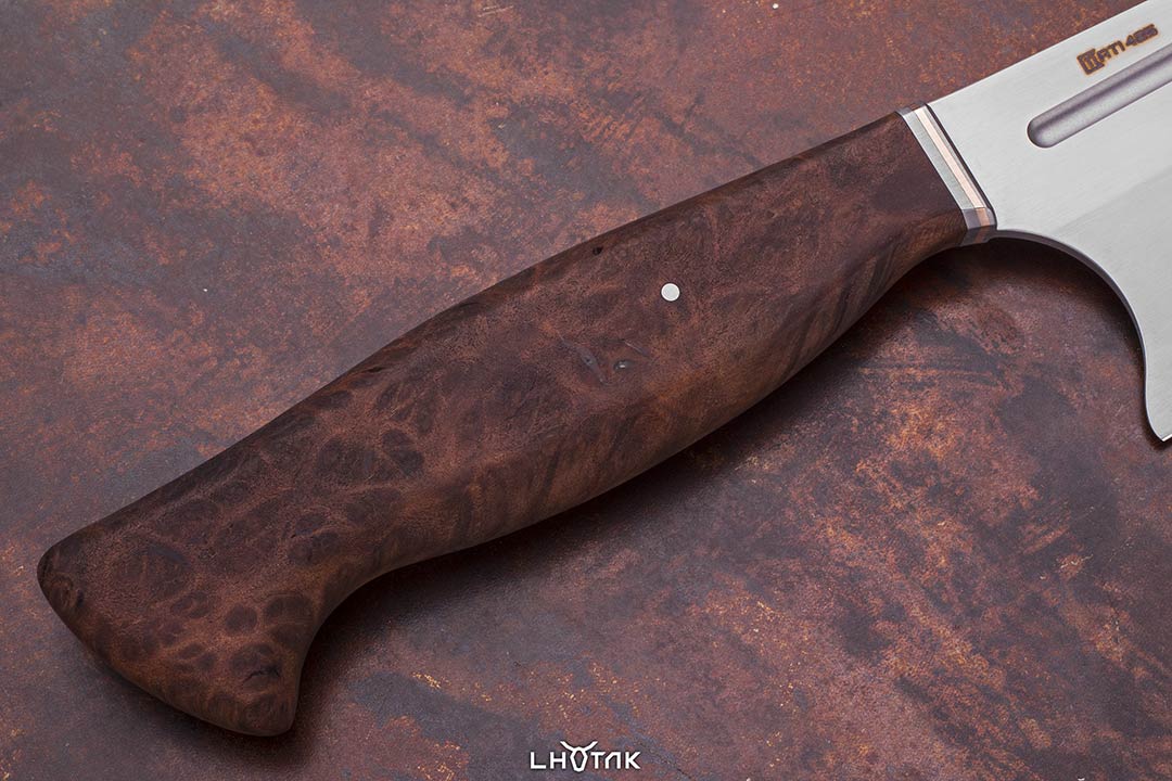

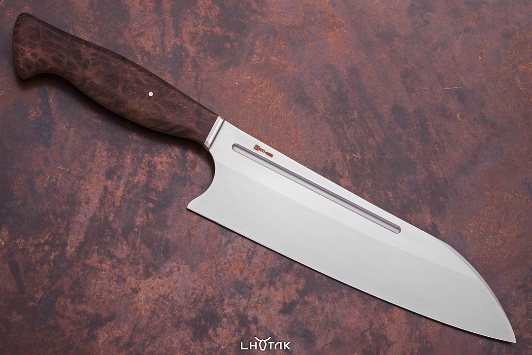

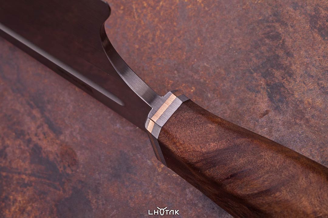

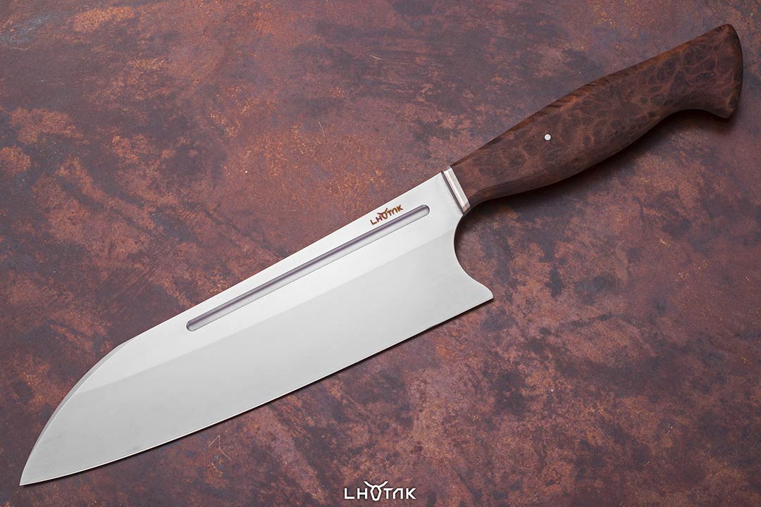

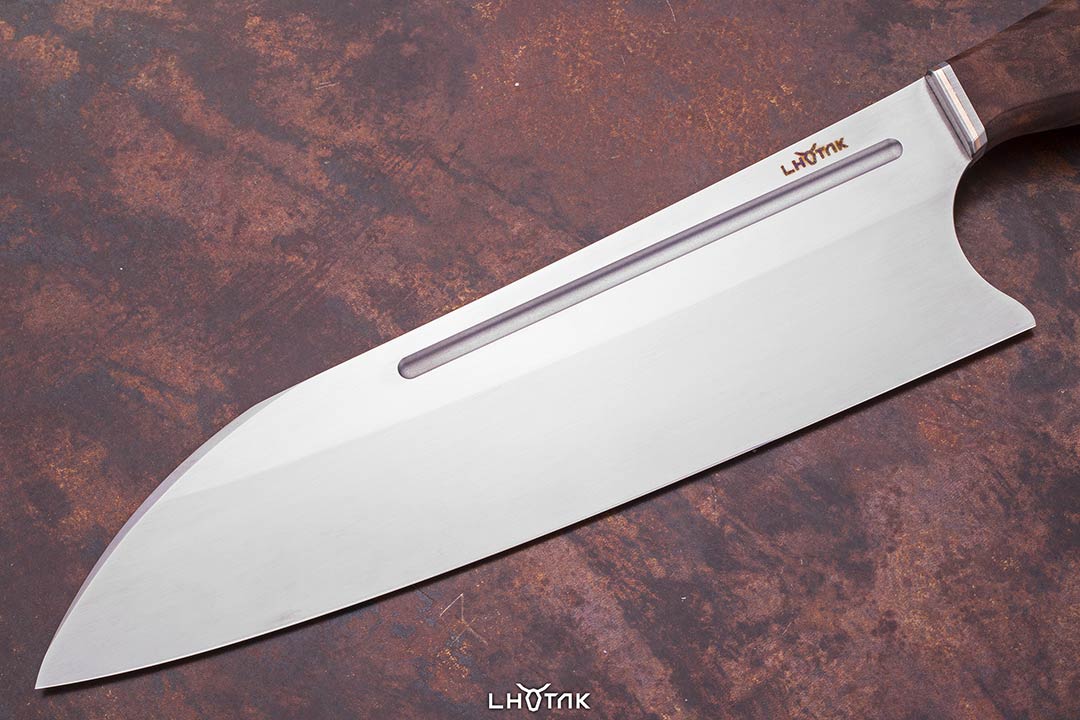

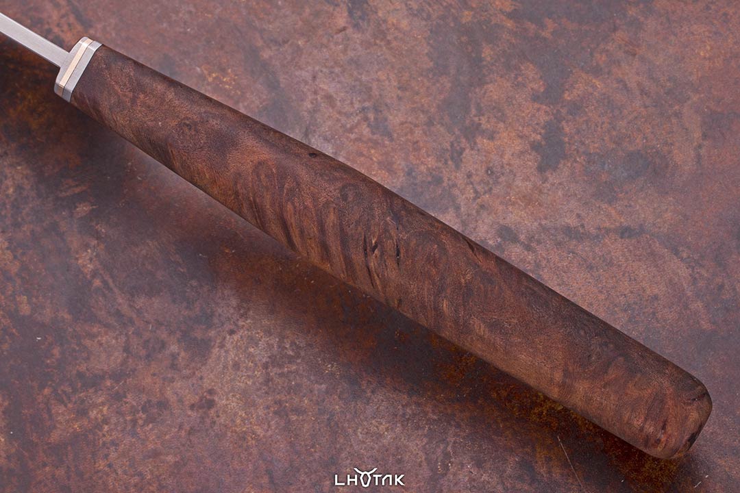

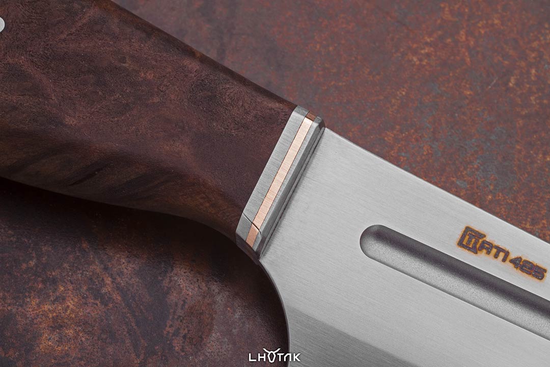

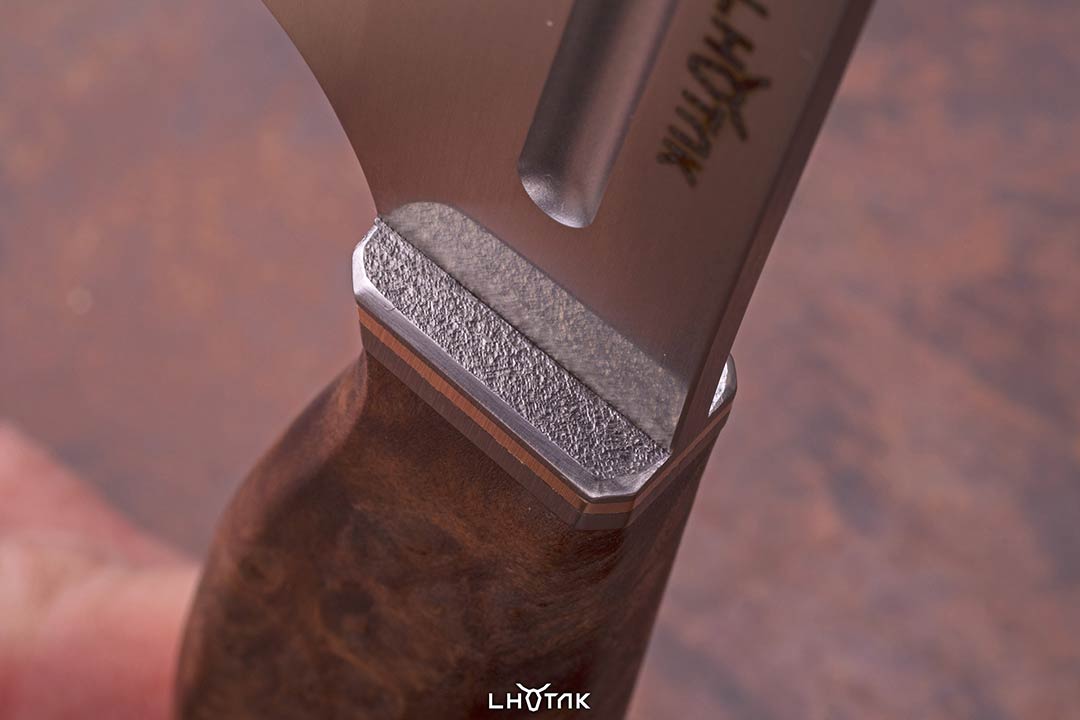

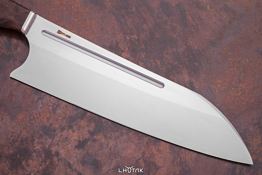

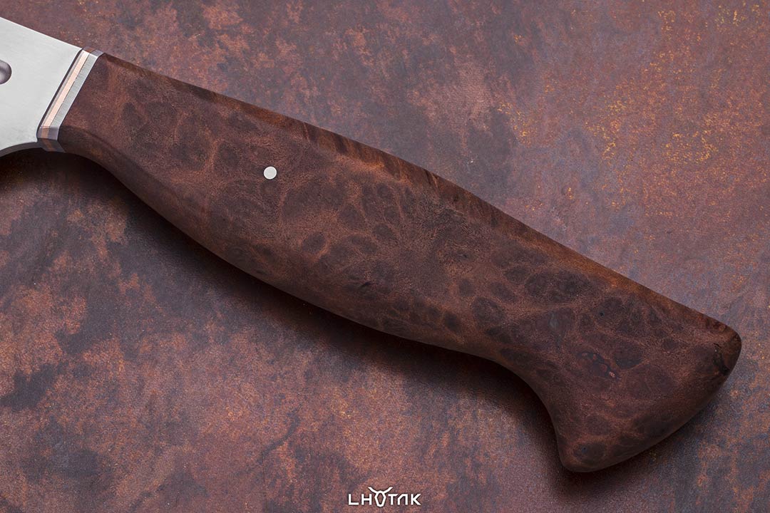

If you guys want to see a nice chef knife, made out of actual titanium alloy, here is a recent one made by BladeMan BladeMan . I only heat treated it, he did everything else:

Very interesting properties with that titanium blade man used in his knife, a quick search revealed that it has a tensile strength in the longitudinal direction of 227,000 psi and in the transverse direction 310,000 psi.
It's interesting because there's such a difference in longitudinal compared to transverse strength, not sure if PM steels might be different, it's possible considering there transverse toughness is so much higher.
I also saw where this is an "alpha beta" alloy as oppose to an "alpha prime" or martensite titanium alloy, which from my understanding alpha beta alloys are weaker than the martensite forming and full beta alloys correct?
I reckon that means it's harder to break it by bending it over, than it is by pulling it apart, then now ain't it! :oops:
I believe so yes, I've always understood yield strength as a material's ability to resist bending and taking a permanent set and tensile strength as a material's ability to resist being pulled apart. tensile strength doesn't really matter at all in knives although it tends to be quite high with higher hardness steels anyways.
