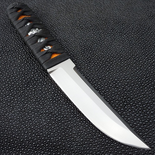

I just finished this titanium blade a few days ago.
I have one of Mr. Mitchell's titanium blades, The Drone. It's chisel ground with carbide on the flat side. It's ridiculously sharp.
Beautiful knife Mitchell!
