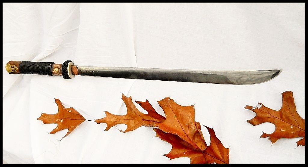

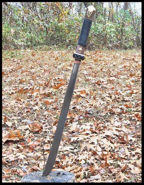

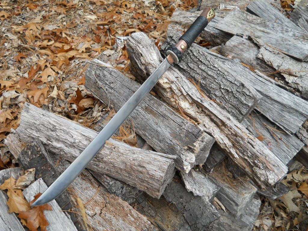

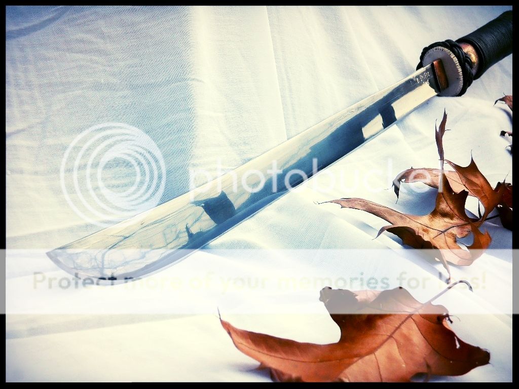

Hi folks, this is my newest, a 21" Beta Metastable Titanium blade, the billet forged by the Titanium Master, Mecha; and ground and finished by yours truly. It's 29" oal, and weights 1lb, 4 ozs. It's a hell'va little sword, lightening fast, cuts deeply into even the very hardest of wood, and holds an edge as fine as a hunting knife without rolling or chipping. It's just plain fun to twirl, swing, and to slay villains. On a side note, I decided to eliminate a traditional guard in order to take full advantage of the steel's light weight qualities, and instead went with a turk's head knot sandwiched between two file worked nickel silver stops. The handle construction is built as strong as a tank, with an extra long ricasso, two1/4 " pins, a wenge core, and a paracord wrap.

Love pic #4!!!!!
