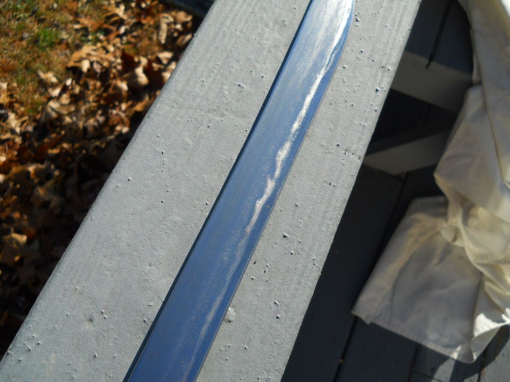

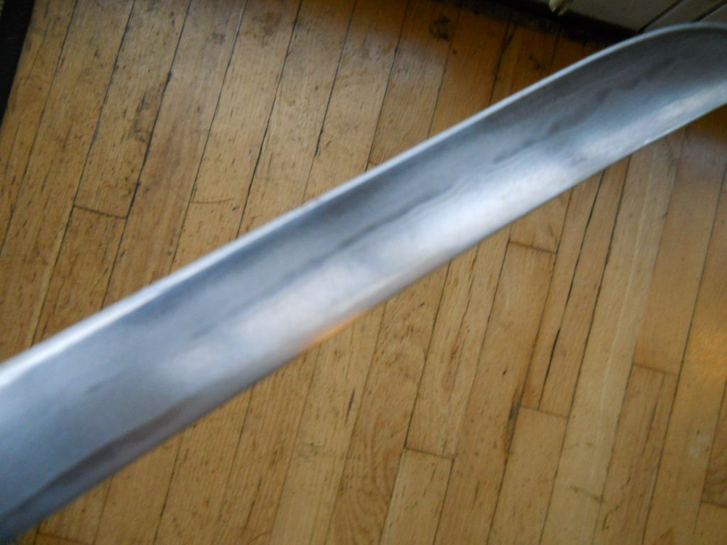

I thought I'd bring this back for a moment to share the scabbard and some new info on the steel. As I began my final post HT grind, I noticed this blade shows a lot of activity, lots of swirls, layers, and banding. I believe this blade has a genuine hamon on one side of the blade, and there is a clear, super bright layer of alloy banding running down the center of the other side. It appears to be a quench line. All in all, a very interesting steel and blade.

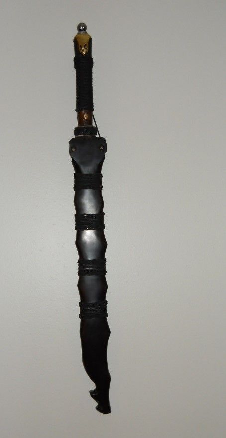

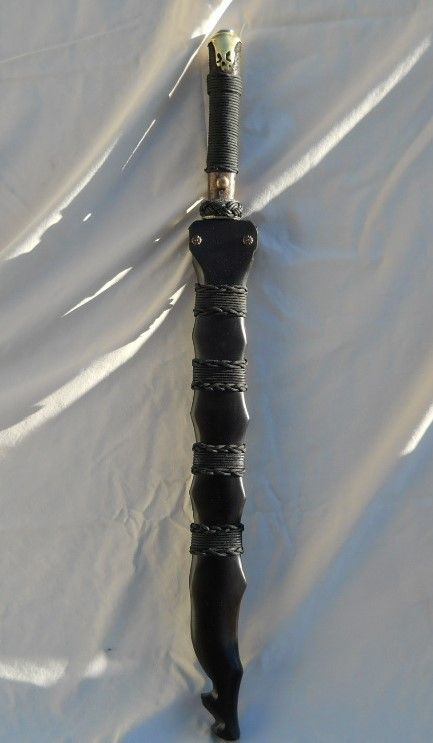

Beautiful work David. Can you clue us in on the construction of the scabbard? What materials did you use and the weight?
Thank you, and sure, I'd be glad to tell you how I do it. The scabbard is make of two pieces of ebony. I make my scabbards by gluing leather to one side, and cutting out the space for the blade. When I get to where the blade fits snugly, I glue the other side up, and I have a perfect fit. I have found that gluing leather to wood works as well, if not better, than gluing two pieces of wood together. I finish up by tying decorative cording/knotting around the scabbard. It looks nice, and tightly binds the construction together. The sword plus the scabbard weighs 2.75 pounds.

This is a mind-boggling moment in the making of beta titanium swords, Dave. Now that you've show that a true hamon can be revealed in a differentially-hardened sword of this alloy, it must be taken into account for all of them! It's just an amazing advancement.
