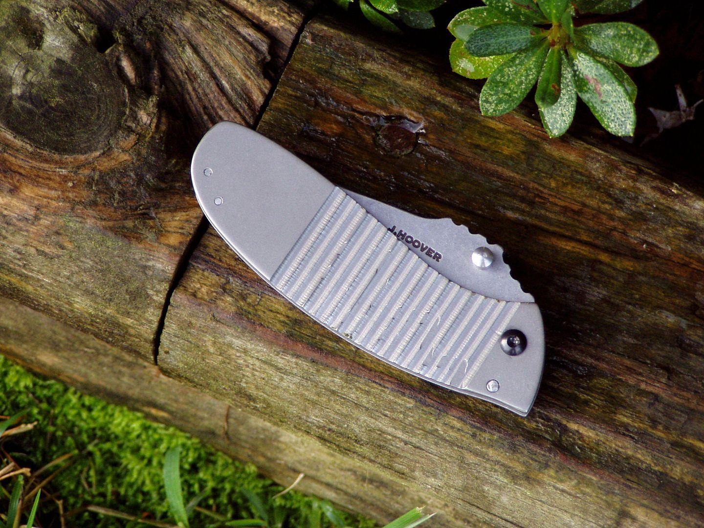

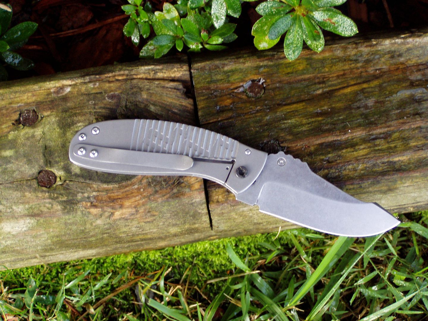

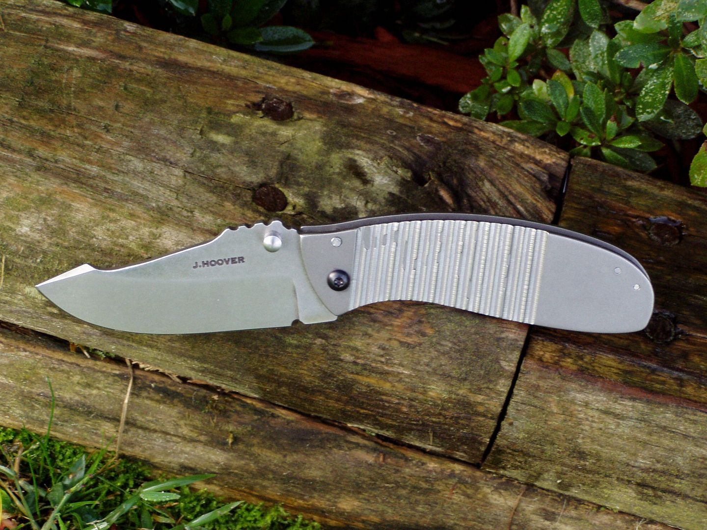

had this one posted earlier with a lot of looks but no takers, so I decided to make some changes to the finish. It now sports a nice stonewashed finish on the ti and blade. Smaller knife for easy carry. Lock up is early and bank vault tight. Blade disengages easily with zero lock bar stickiness. Check out the new pictures.
Closed- 4 1/8 inches
Open- 7 1/8 inches
Blade- 3 inches
Steel- cpm154 X .125
Style- harpoon
Grind- Flat ground with drawn swedges and jimping
HT- In house with dry ice cryo to 59-60rc
Blade finish- hand sanded, bead blasted and stonewashed
Frame- .105 titanium
Finish- anodized and Stonewashed
Pivot- 3/16 stainless with phosphor bronze washers
Detent- Positive and secure with a 1/16 stainless bearing
Clip- Made in house from .040 titanium, sanded, bead blasted, and stonewashed. Set up for right hand tip up carry.
Hardware- Stainless
Asking 250.00 shipped in the USA
Paypal, PS M/O, or certified check preferred.
Questions or comments welcomed
Thanks for looking

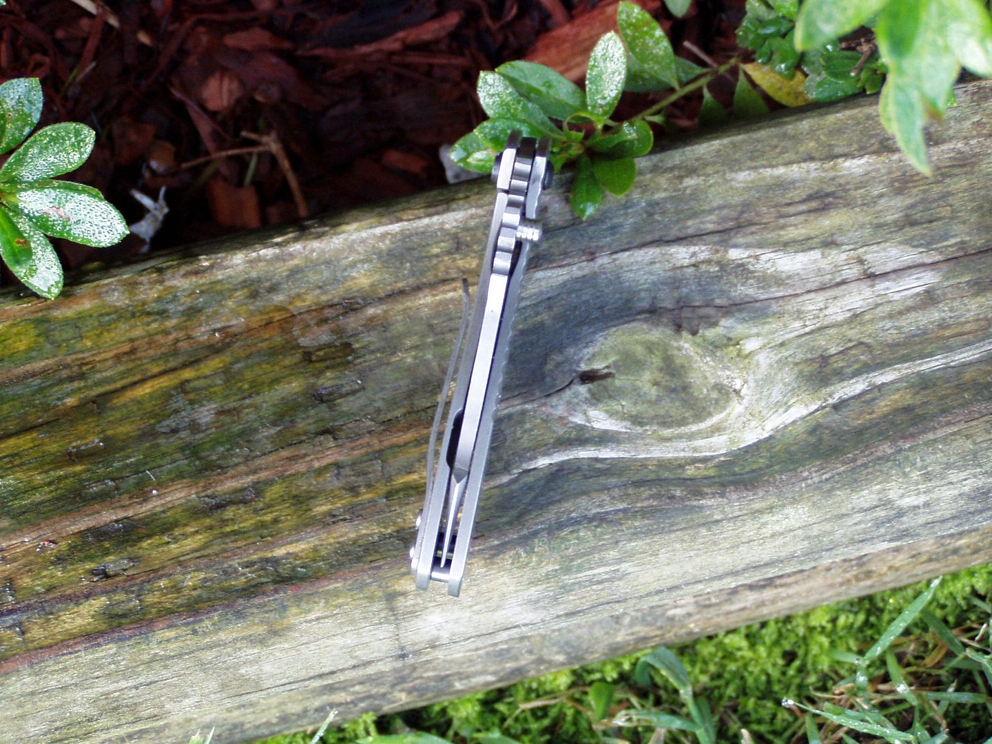

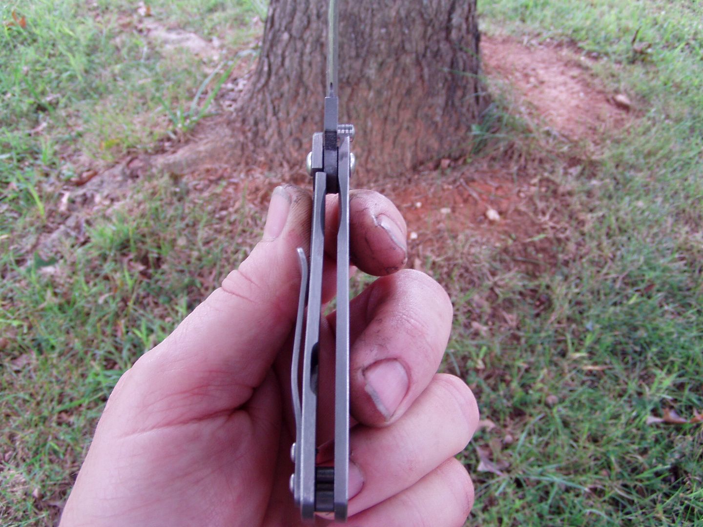

Hey ben2002gsxr, got you email. The video link works fine for me on my lap top but will not seem to work using my phone. It is the only link I have, sorry. Here is a picture
of the lock up, usually have one, thanks for bringing it to my attention. The lock up is early and tight, no movement in any direction with no lock bar stick.
