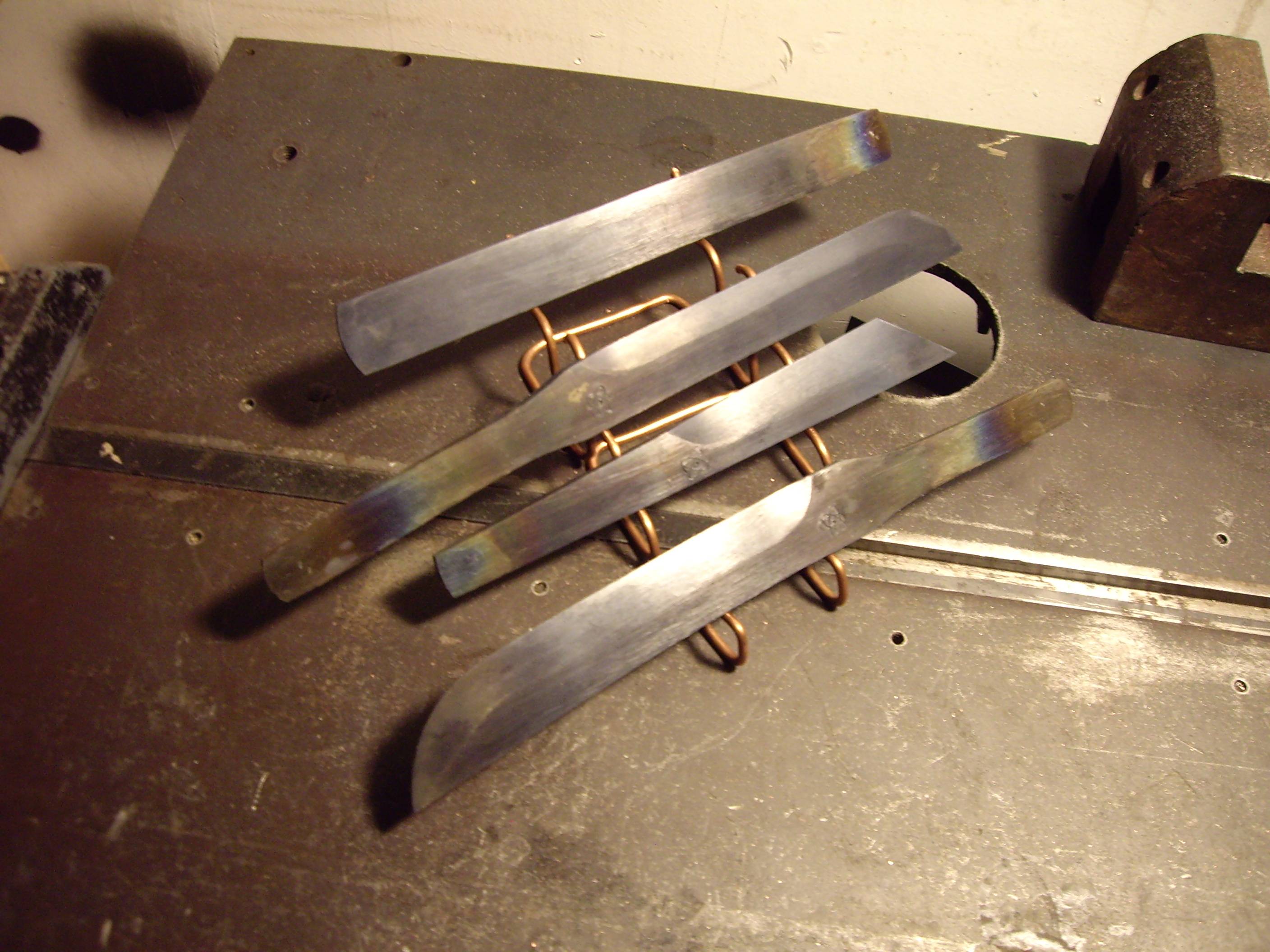

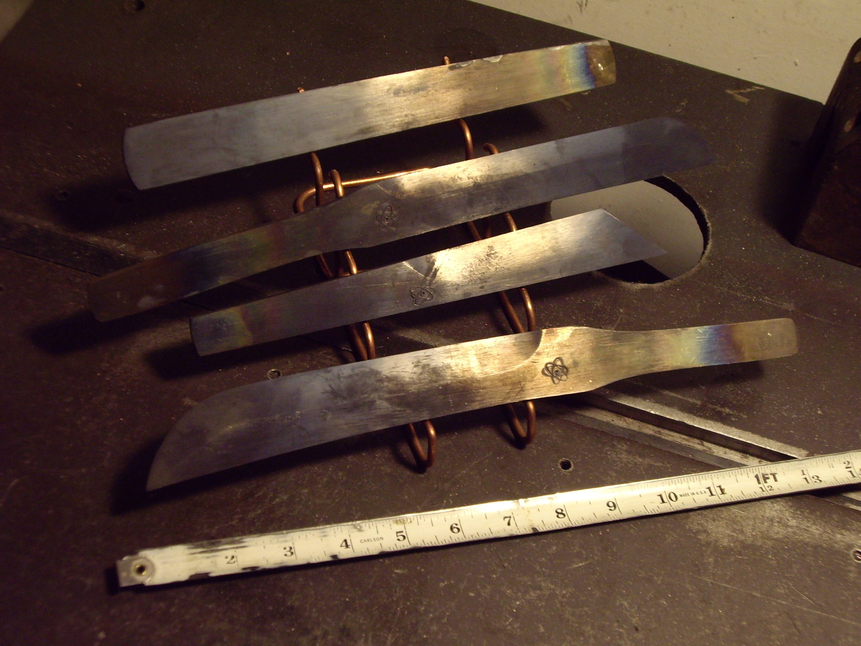

I want to share a few quenching photos of forged beta titanium knives. Still fine-tuning the process, but I'm really happy with this batch, and I think the HT is going to be very nice.

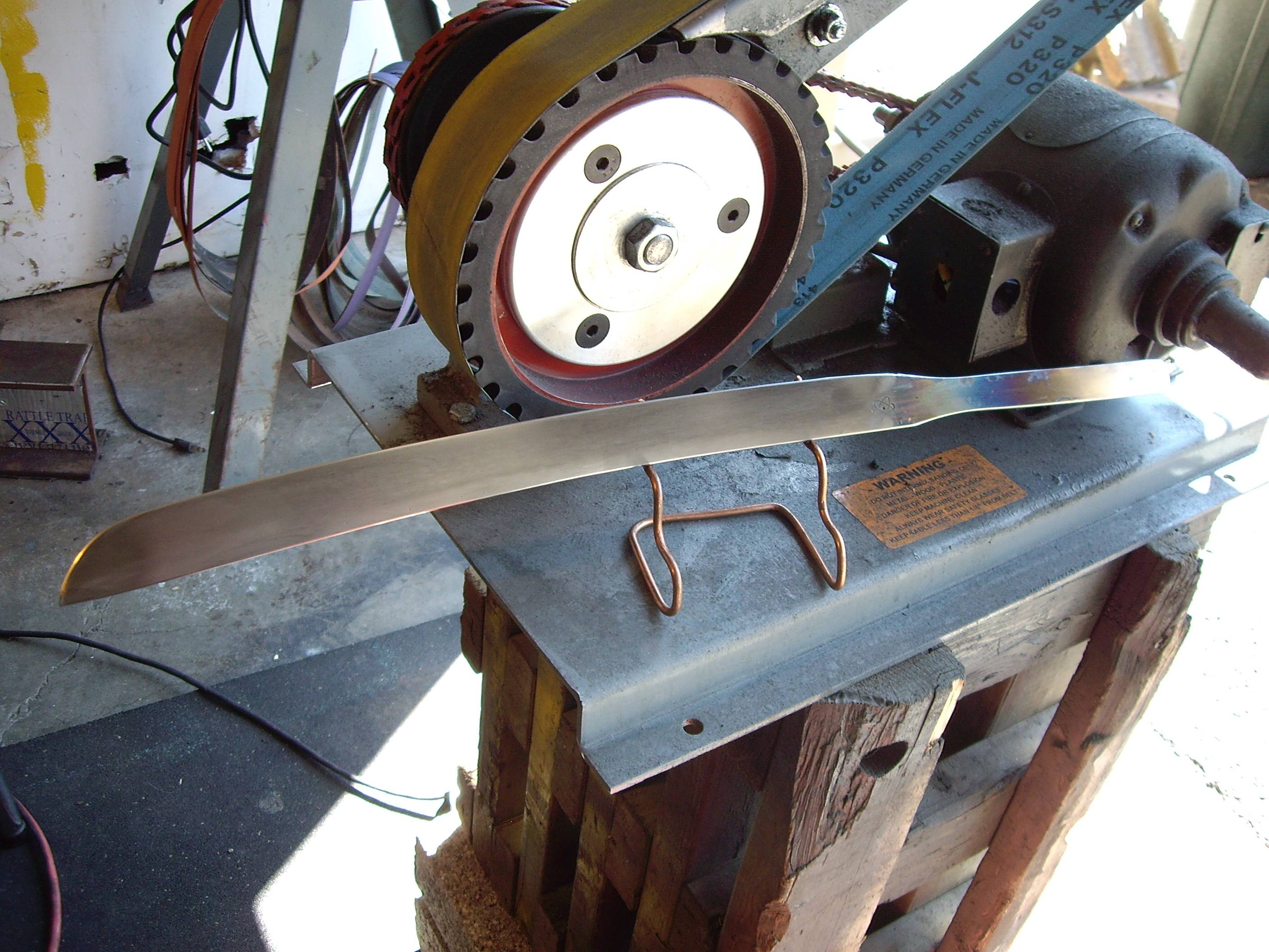

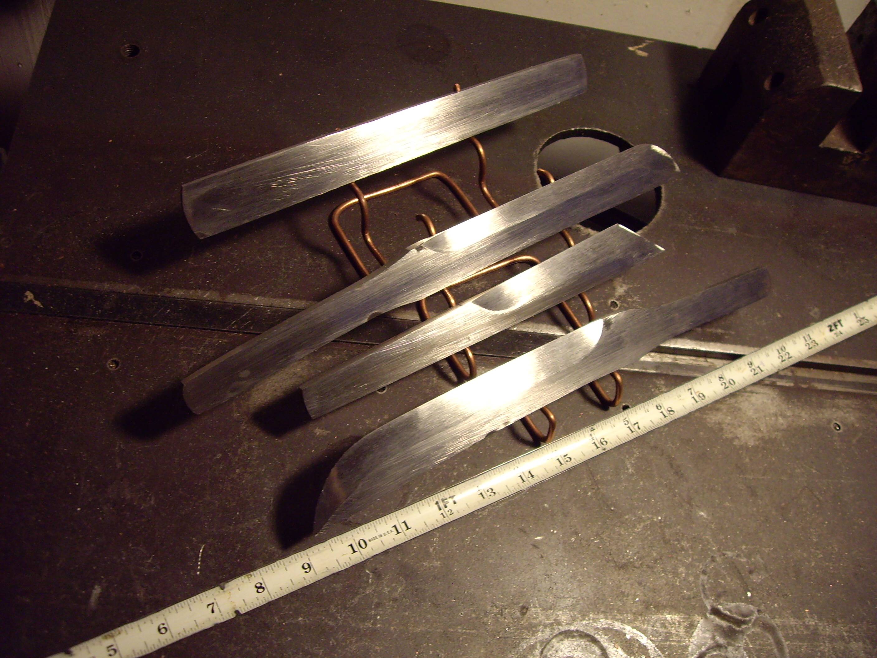

Rough grind: really having a blast with my newly modified 2x72 grinder!

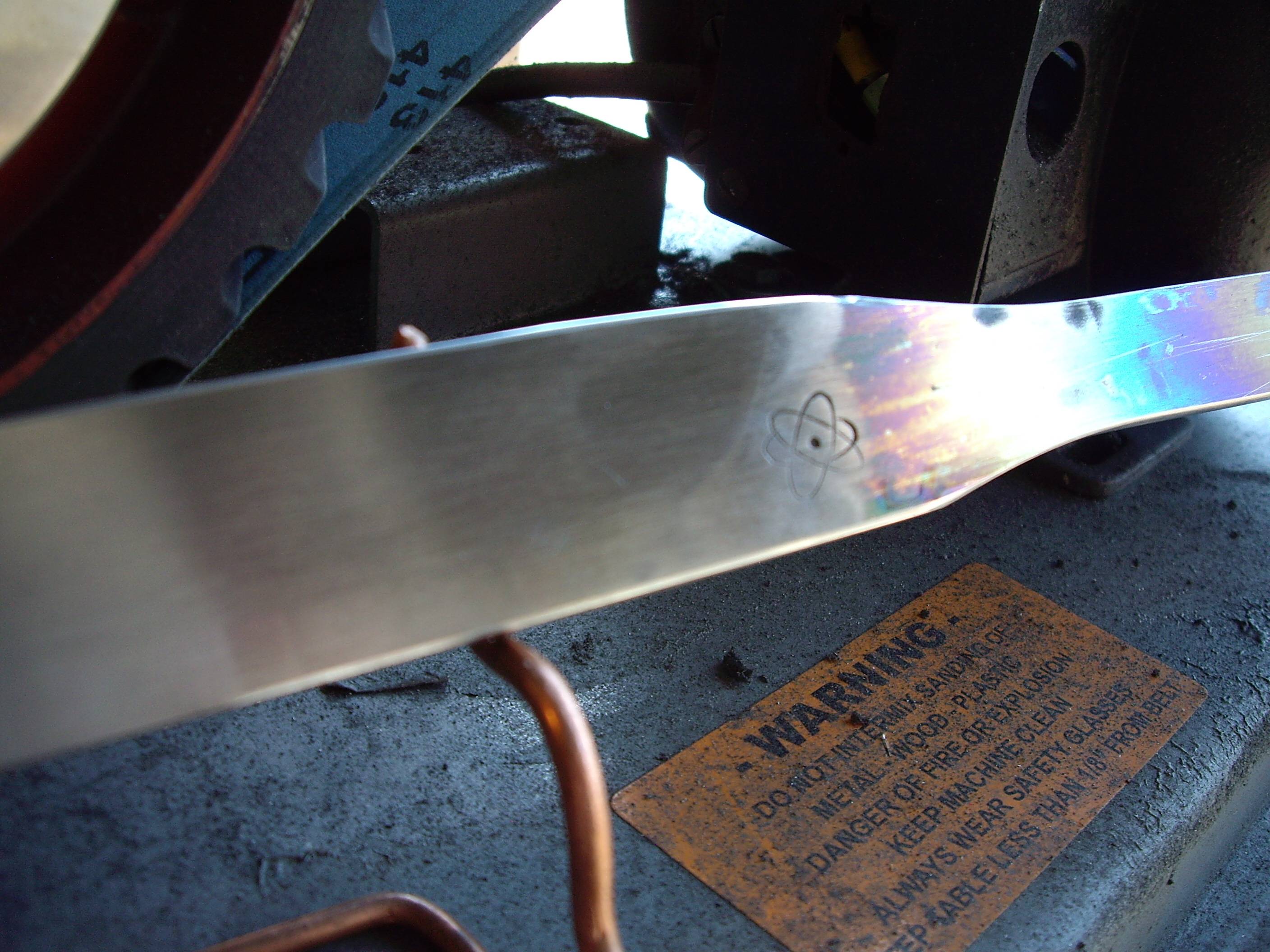

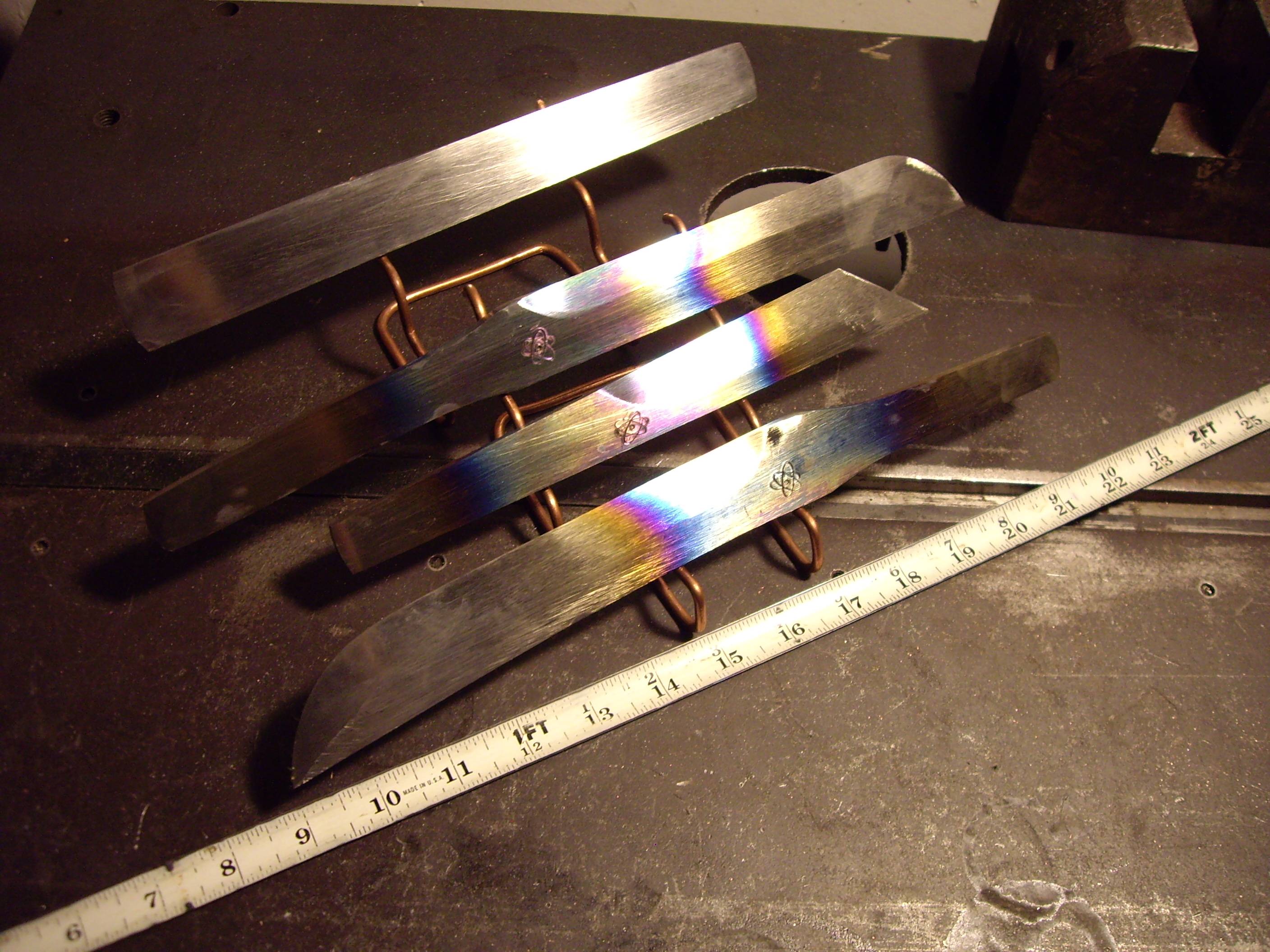

Marked: still doing this with a point and a single oval, so each mark is actually four overlapping marks, haha.

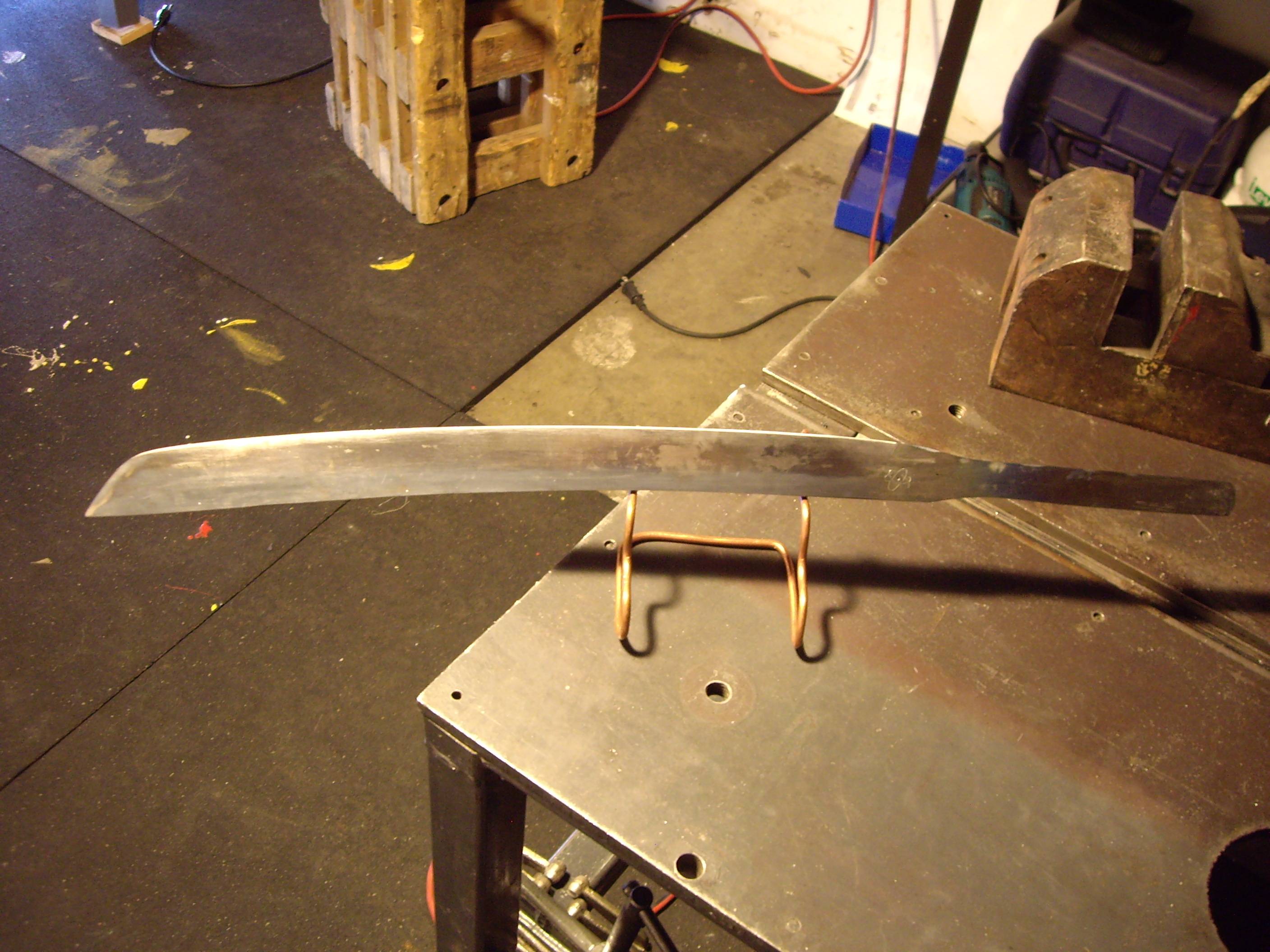

Quenched: I think this will prove to be my most "potent" ht yet.
Cleaned: A little WD40 makes everything look nice!~

Video of these knives getting dunked:
https://www.youtube.com/watch?v=AggQuChU3bE&feature=youtu.be
Pure clean cold water. Titanium hates oil.* And HELL NO I'm not cutting these ridiculous bars by hand! Reciprocating machines may be ultra sexy, but even the power hacksaw takes 15 minutes to make a cut.
*I read of one ti alloy that likes oil, but it's stupid

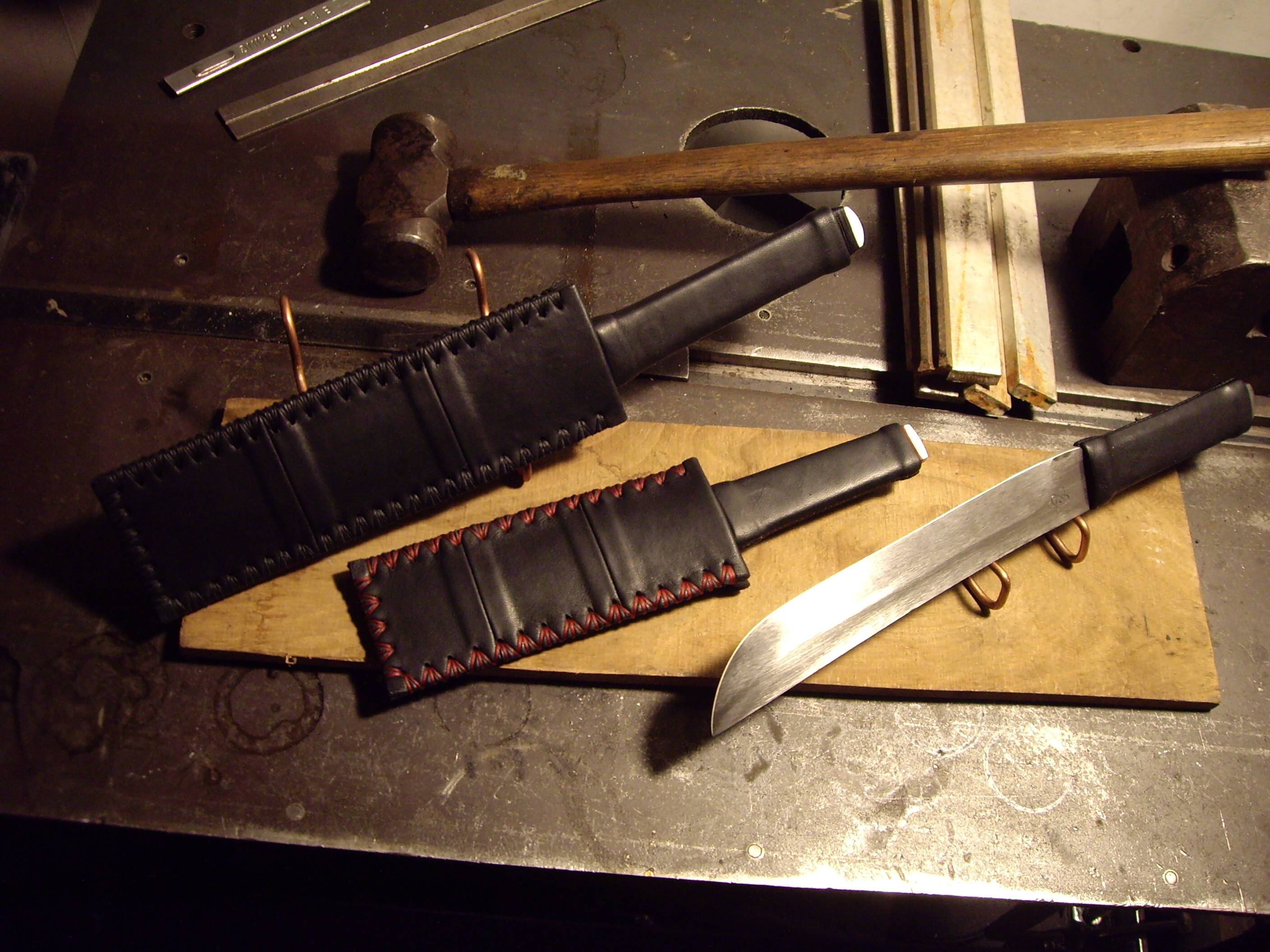

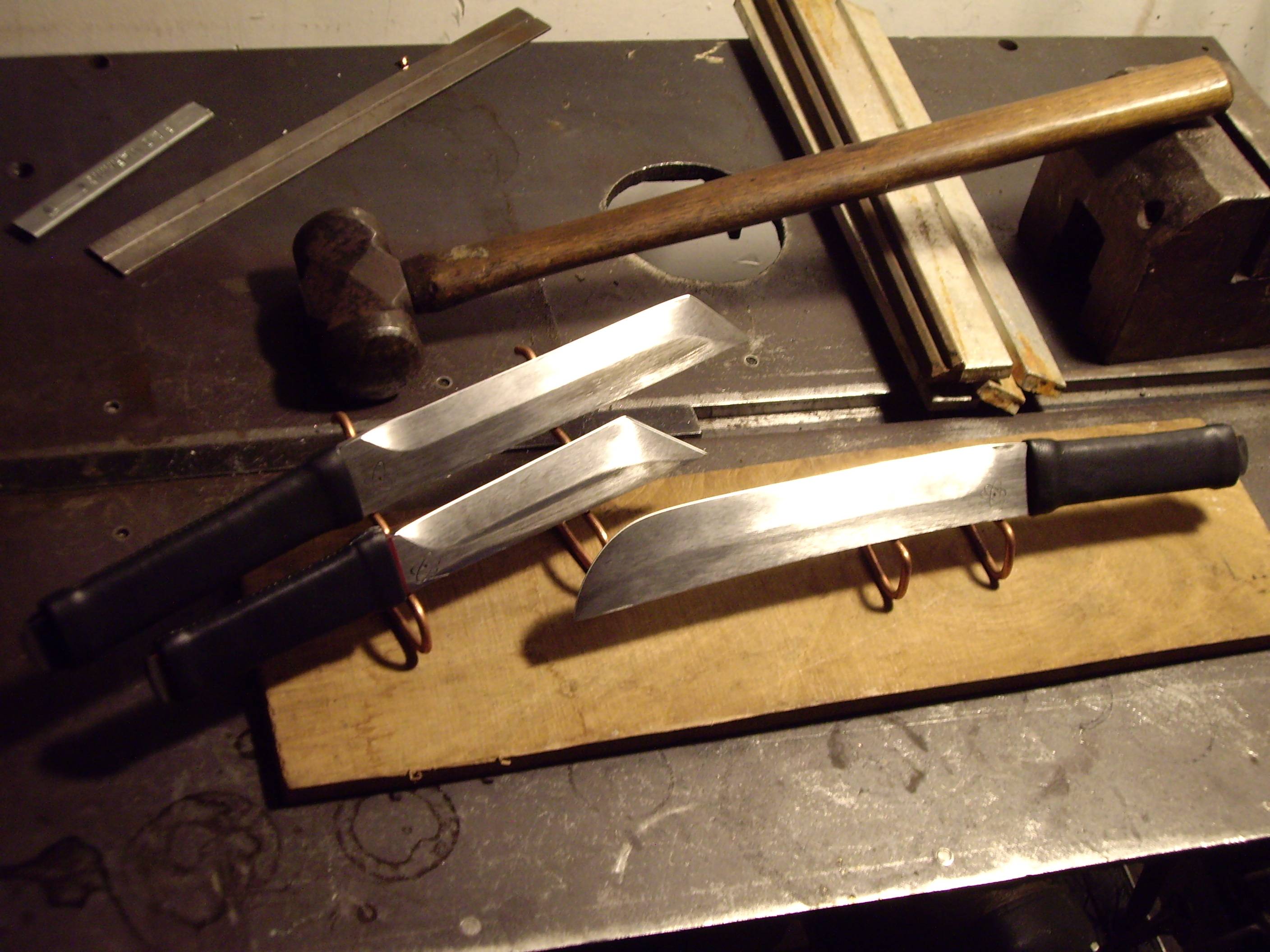

Here are these knives with deerhide + cow sheaths and grips. The third one will have a sheath covered in white deer.
Above them is my favorite hammer ever, took me almost 2 years to PRY it out of the farrier who owned it, just got it tonight! It hammers a fantastic billet! :D
I should have a good idea of their hardness soon; I'll post the results for ya!
Well, according to my new tester these should be just around Rc 47. Still reaching for that magic number of 53! :)
Edit: Been testing every ti blade or blade fragment around, getting readings in the 40s.

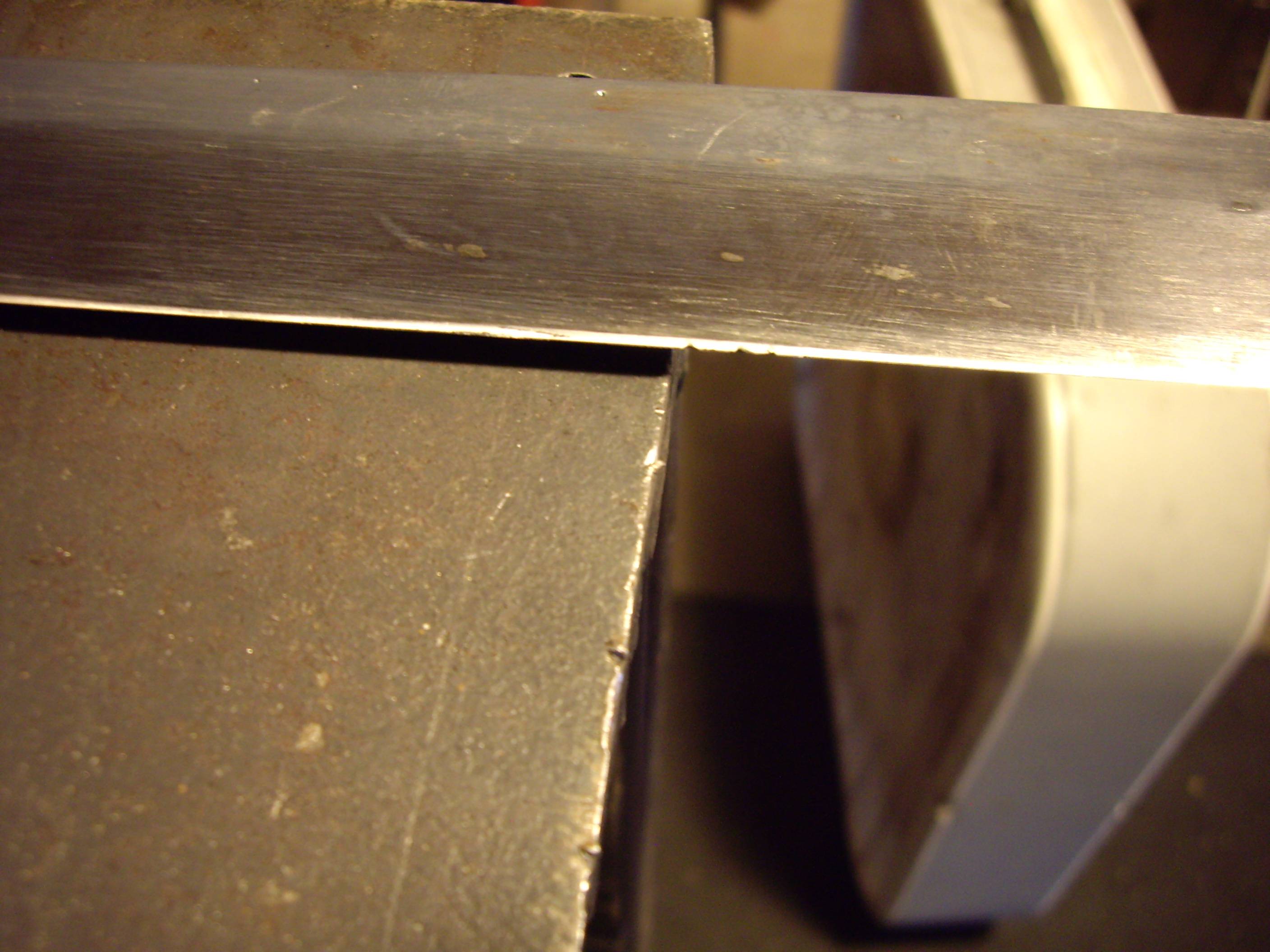

For what it's worth, this monstrosity defeats my welding table in an unscientific edge-on-edge contact test! :D
Small gouges on the sharp blade edge, big cuts in the steel table is good, right? :p
Mostly just rolling a bit.
Viola! Good as new!
