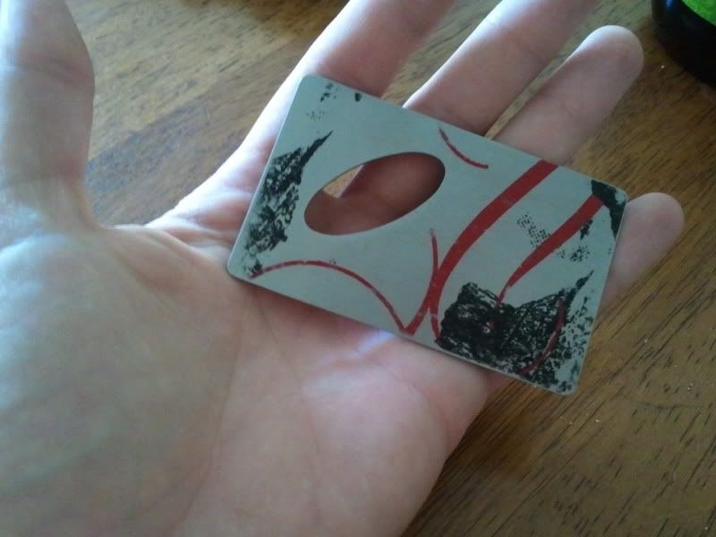

Daniel, some other ideas for your spike. First, a bottle opener on the end. I think the claw type would work, but if you did a oval cut out that still leaves you the end to do something else with. Second, maybe something to make it a little bit fatter or easier to index in your hands when wearing gloves and your hands are cold. I need to know what I am grabbing by feel sometimes. Third, some way to keep it from laying flat, like a pin or bolt that goes through it. I wear full finger gloves and picking up a thin piece of metal off a flat surface would be difficult. Fourth, I don't see any way to keep it in a sheath, maybe a small guard like projection or a contoured grip profile.

Not sure how hard an oval cutout would be to do ,as a bottle opener,but sounds great.
To keep the bar from lying flat,and being difficult to pick up off a flat surface,I'd suggest this: instead of an oval 'cutout',how about an oval 'bend-down'?
i.e.: Cut out the C the right OD to use as an opener,but instead of cutting out the inner side (ID) of the C,just bend it down slightly.....voila! instant integral spacer!

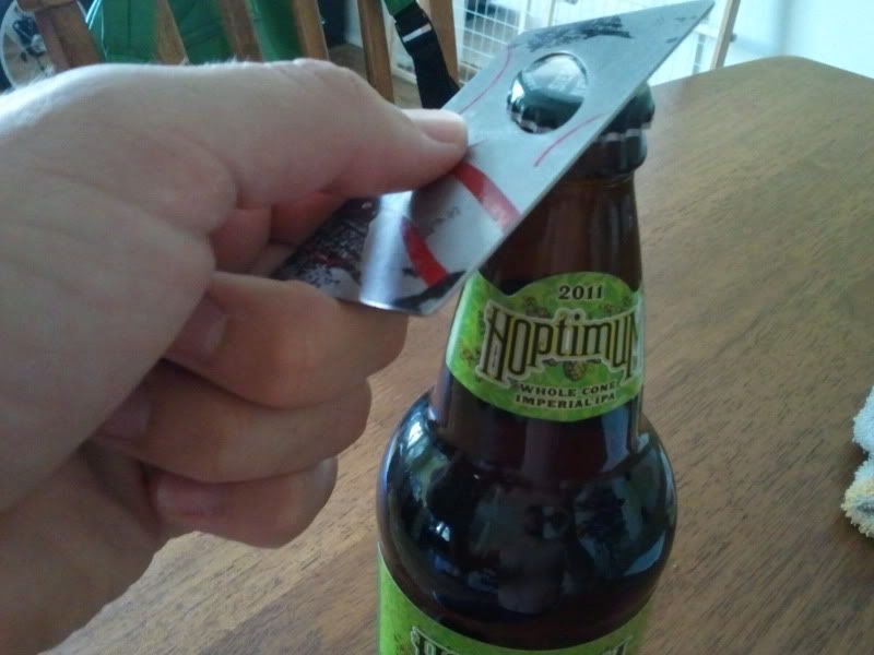

Gnar I have been thinking about this a bit more. Here is one way to do it while taking care of the flatness.
And here is what the oval cut out looks like and how it works. This one is credit card sized and fits in my wallet.

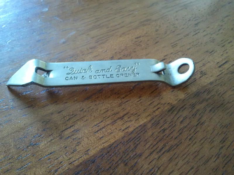

As for the claw type, think about what a SAK has or a leatherman tool.
