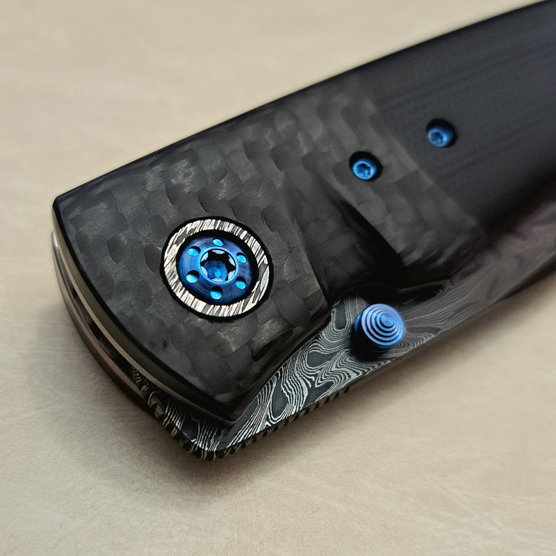

All the Titanium hardware that I have is from China and all at a fraction of the cost from US sources.None have broken.
Below I have anodized them gold.
Chinese titanium screws are softish because titanium is softer than stainless steel . one should never forget how soft (or ductile) titanium (and aluminium) is.
as long as you are aware . np
It's not that the titanium is soft but the grade used that is important.The standard being 6AL4V(Grade 5) used on every quality titanium knife out there.
The ones that I have are Grade 2 but I haven't experienced any breaks.I have cut and grinded them down.I believe Flytanium must be using Grade 1 being the softest and the most purest grade of titanium. I should note that I broke three of these screws that came with the 940 scale kit and not just one.
