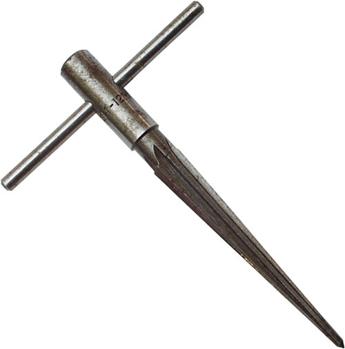

I usually just hit the inside of the tube with a cone shaped grinding stone in my Dremel to open and round the lip. To pre-round it if it get a little deformed, I use a hand reamer like this one first.
will the cone shaped grinding stone take care of the outer lip deformities of the tubing though?
The tubing mushrooms a bit sometimes and even though I sand it the metal seems to stay there. Id like to have a clean outer edge
Ah, I see what you're saying. No. The only thing that will solve that is filing the tubing flush with material by hand and then hand sanding it smooth. Your grinder must me pulling the material over and causing it to deform.
