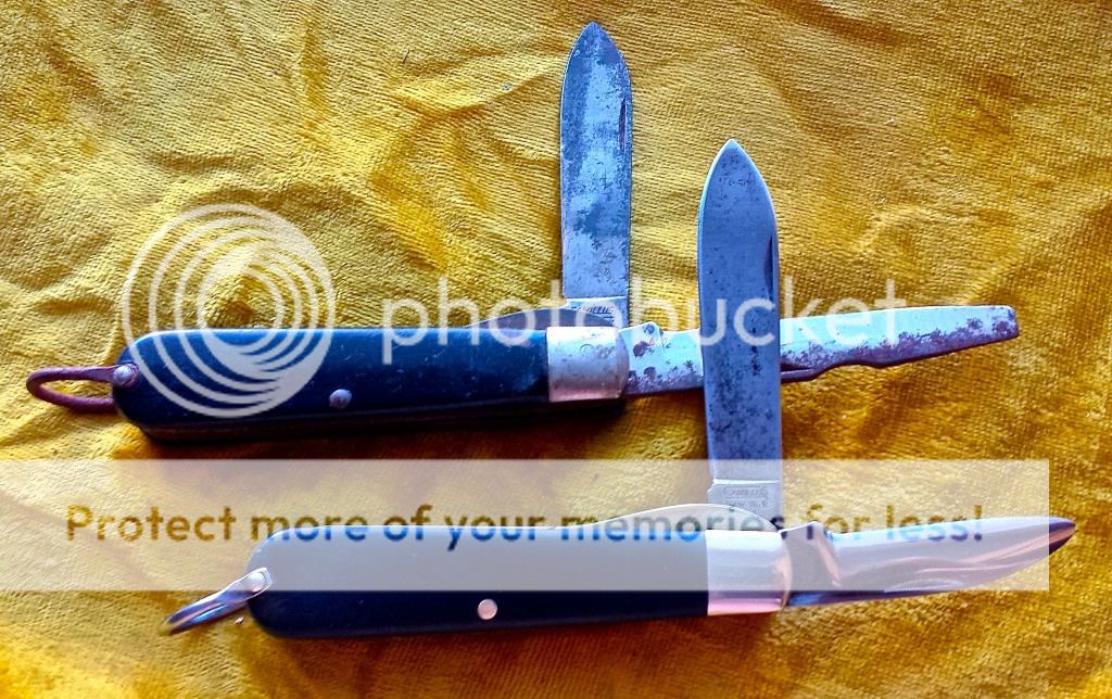

I enjoy whittling and was reading this month's issue of Woodcarving Illustrated, where someone had written an article on how to modify an old TL-29 into a locking whittler. In the article, the writer modifies both the main blade (which does not lock) and the stripper/screwdriver blade (which does lock). I found a lot of 4 Camillus USA TL-29's on eBay for under $20, and went for it. Here is an example of one as it arrived (on top) with all the corrosion, and the one below that I modified (which also was very corroded):
I spent quite a bit of time cleaning it up, and it took a long time to thin the blade so it was good for whittling. I still think it can be thinner. I also had to tighten the joint in a vise and peen the pins, followed by lots of sanding and buffing. Overall it is a very nice piece of kit for whittling. I have 3 more to practice on until I get it perfect.

Thank you for the kudos! The blade is super strong due to the thickness. It takes a great edge and holds it very well, but it is not ideal for fine detail work. It is perfect for carving hard woods, like olive wood, which I have an abundance of. Olive wood dulls my knives very fast, and if you need to carve end grain it is sure to nick the blade or break off a tip (which has happened many times). This knife did not have any problem with the hard wood. I used it to carve this pumpkin:
I flat ground it and sharpened it to around 12 degrees on each side. I was going for a true Wharncliffe, but the difficulty is getting the tip to remain pointy. I have 3 more to practice on, so I will keep at it.
