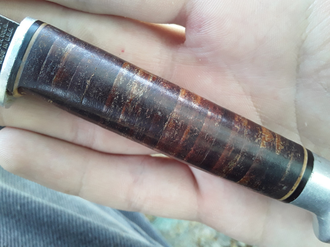

For a stacked handle, is there a good way to brighten up yellowed white spacers on an otherwise nice handle you don't want to really disturb ?
I've got a western 628 that could use a little something and I just won a nice west-cut K3 in stacked leather that's overall very nice otherwise, both have ( or appear to have in the pics ) yellowed spacers that could use some freshening up.
I don't think it'd be possible to brighten yellowed white spacers if it's yellow due to oxidation. Dirty leather hendles I've cleaned with saddle soap and a brush. Done the same with a sheath. Waxed them after with sno-seal and buffed to a shine. I've used a small amount of honing oil on some leather handle because it's readily available while sharpening.

I think careful ( using Fine sandpaper 400g ) on oxidized Leather spacers would work - it would not take much at all, and care to be taken not to reshape from the original.

These should have originally been white right?

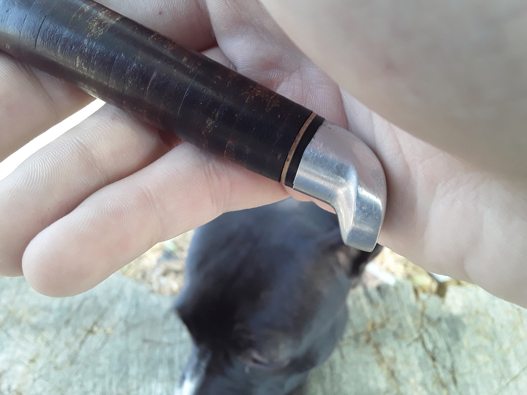

Overall the handle is very nice and I just don't wanna mess it up.
I will give it a healthy dose of neatsfoot oil, but that probably won't fix the play In the pommel from leather shrinkage.
In that instance I will just get a wrap or two of thread in there to fill the gap, the leather should at least swell enough that you'd never know.
