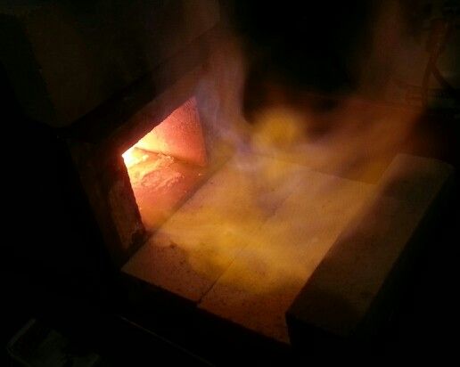

And this photo just because I think it looks cool... I don't run it with the front wide open, these are just for the sake of photography.

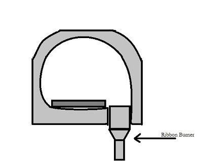

I took the design of my forge in progress from a pic Stacy shared. It was a table forge with a ribbon burner. I am expanding this a bit, and adding a couple of other things like a small idle burner, and the ability to change the volume of the forge. Here is a crude MSPaint drawing. When completely done will be kaowool/satanite/ITC-100 with bubble alumina floor with a blown ribbon burner and a small venturi idle burner. I will also be able to vary the ribbon burner as well as direct the flame to a degree.
Thoughts?

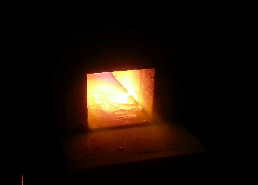

The forge list fine but it felt really flamey? The flame just seems very full and flowing not so much strong.

The thing that strikes me first is that there is no back port. 22" long, wide, and 154CFM feeding it needs some place to go. It is all coming out the front right now.
Tips:
Try a speed control ( light/fan dimmer) on the blower. They usually will allow the blower to be variable. The choke plate works, but requires a bit of finesse.
Set the gas pressure to about 2 or 3 pounds ( just barely enough to make the gas flow). Start by barely cracking the gas valve ( 1/4 open is a lot on some needle valves). Have the fan barely delivering any air. Light the forge. Up the gas a tad, then the air, repeat, etc., until it is purring along with a nice low flame. Let it heat the chamber for about five minutes, then turn it up some more. With some fiddling, it should run just fine.
There will be some amount of dragon's breath. That is the flame coming from the ports. With only one port, it will all come out the front. The Dragon's breath should be neutral to just slightly yellow/orange. If it is bright blue, you have it too lean. A blown burner can make some noise, but you get used to that.

Stacy what do you mean by "backport". Does that mean an opening? Is my opening too big? Both ends are cut of and the back is designed on a slide der to increase and decrease the opening. Is that not good enough?
On a forge the size of yours I would normally put a 3X4" front port and a 3X3" back port. The back port is usually level with the floor (front port, too). The floor will normally be a flat surface about 3" wide made from some kiln shelving, bubble alumina, or refractory. When the back port isn't needed, like during HT, it can be blocked off with a few firebricks.
Another thing I see in your forge is what appears to be a very large chamber diameter. That isn't necessarily a bad thing, but it does affect how it functions. You have that much more area to heat. Normally, 6" is plenty enough chamber width for swords.
Perhaps another layer of 1" wool would be a good idea.
