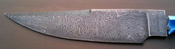

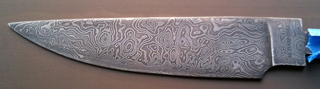

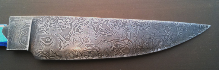

I'm working on my first true pattern welded blade (non-cable) and need some help deciding whether to add bowie-type clip to the blade.
The blade is 6" long, made from Aldo's 1080 and 15N20.
I'm also undecided on the handle shape: either a super stark bog oak coffin handle with stainless frame, guard and pins; or a hidden tang in redwood burl with stainless guard and mozaic pin.
Here's the blade.
and
thanks,
This is just my personal taste, but I don't like clips on shorter blades. To me a subtle clip looks absolutely great on a big, long, slim bowie blade, but my opinion is that they make shorter blades look souviner-ish or cheap.
How about instead of a true clip, just swedge the last 1/3 of the blade and see how it looks. If you decide to add a clip, you can always do it after the swedge.

Personally im not usually a fan of clipped blades but i think i might like it on this one. Whatever you do im sure its still going to be a nice knife.
Maybe I should clarify a bit. When I think of a clip, the first thing that comes to mind is the obvious curved clips you see in the old Jim Bowie themed bowies (though no one really knows what Jim's knife looked like).
I'm much more of a fan of the straight clips that are long and subtle. A straight sublte clip might look good on this knife. It's hard to know without the knife in hand. Trace the blade on some cardboard and cut out two profiles of it. On one, leave it the same, on the the other, add a clip. Hang them up side by side with a bright background and look at the dark profiles and see which speaks to you.

I wouldn't clip that particular blade. If it were wider and the tip would be in the same place with the same edge shape after clipping, a clip might have worked.
I think there's a break in the language here.
I am probably wrong, but I assumed he meant simply adding a clip grind.... not actually changing the profile with a radiused clip.
If you just mean a clip grind (a small bevel added to the blade shape you already have) then I say almost any knife looks better with that because it adds dimension and technical difficulty to the blade.
You need to plan it out though, as a clip grind can make or break the look of a knife.
Thanks, Ken. :) I've had this sitting on my work bench now for 3-4 months. It needs to be reworked a little to remove a slight wave in the edge from heat treating. I just haven't got the umph up to do it yet. I've got to head to the shop tonight for some work, but this one will have to wait as it's just for fun and not a customer order.
--nathan
I played with photoshop a bit. I liked it a lot with a clip, but it is great as it is...

Thanks to everyone for there comments. I'll work without the clip/swedge until the handle is on, then repost to get opinions of the full piece.

NATHAN ---- as you seem to have captured an elegant line in the creating of this particular blade, I'd urge you to give considerable thought to the design of the guard, handle/etc. This piece could develop into a unique & handsome bowir --- a real dressed up classic.
