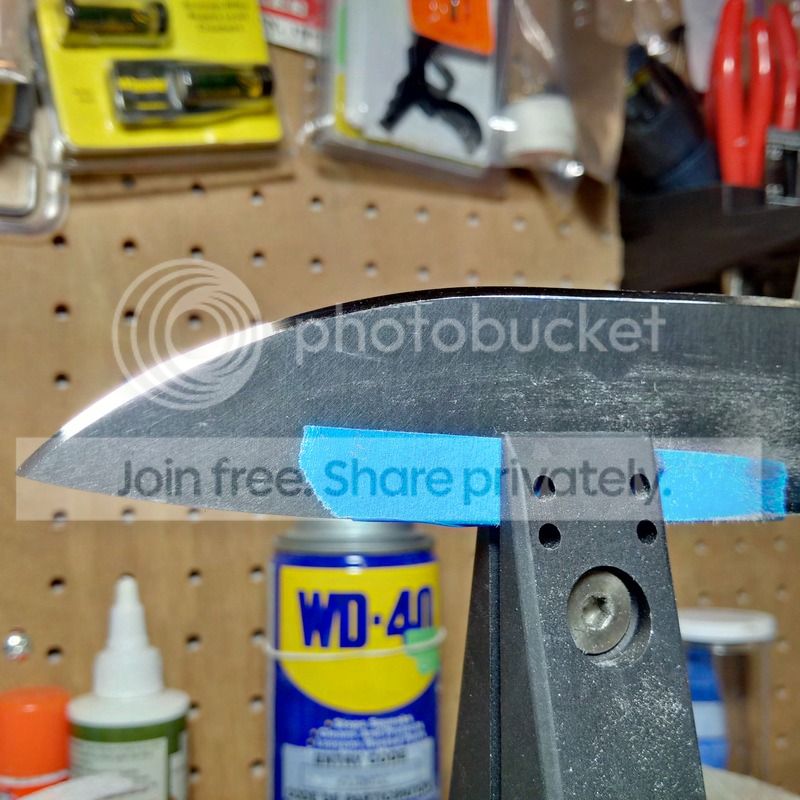

I use a knock off edge pro because I can't afford the real deal, the stones are completely worn out and useless. I was contemplating going to a powered method I saw on Instagram using a modified harbor freight 1x30. I typically take mine up to 1500 and then buff on a loose wheel with plastic compound. It gets them sharp enough to shave and slice catalog paper. The full size cleaver I completed a couple weeks ago had no trouble going through a 500+ page text book and spine.
http://s15.photobucket.com/user/00s...8-489E-82C6-08D45CC70C50_zpsnvpvieso.mp4.html
Kevin - that demo is IMPRESSIVE!!! That'd sure dice up some veggies..... or a big chuck of beef!
