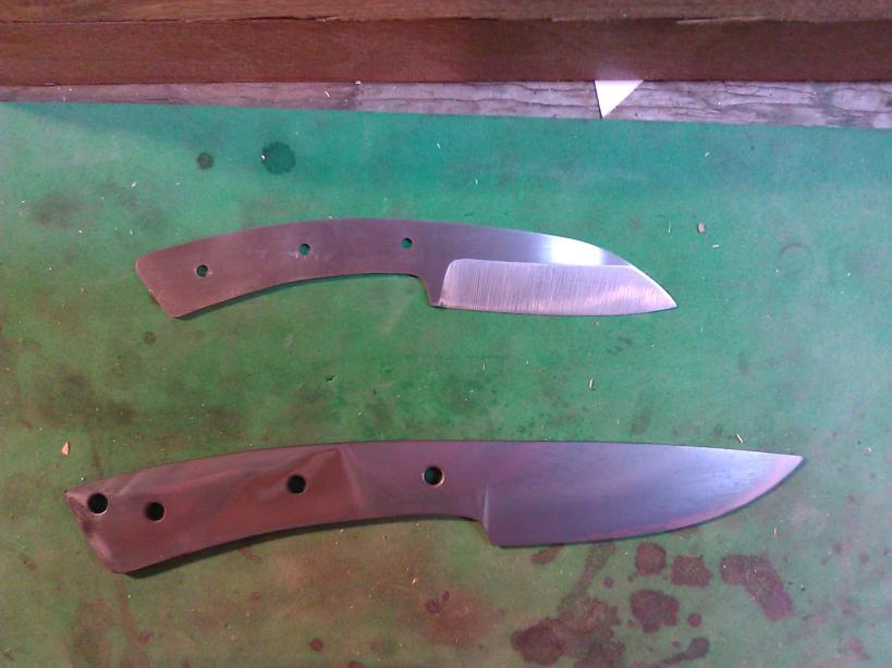

While waiting for the knife to cook, I pulled out a piece of 1/16" 1095 that had a mini rigging knife pattern glued on it, which had been cluttering my bench for months. Time to get it out of the way, should be fast on the Bader. On a whim, clearly influenced by Salem and JohnnyMac's recent gallery posts, I sorta wharncliffed it for variety (not QUITE a straight edge) and then decided to give it a chisel grind and leave the 60grit finish on the bevel. I promptly hit it with WD40 when it came off the grinder and then polished the flats to 360 by hand with a block. If not for other stuff going on, this could have gone all the way through heat-treat in just a couple hours, which would have been neat. The idea was to just MAKE IT without fuss, and leave the fretting for the others with the fancier material and greater emotional investment.

Following advice here, and on Salem's site, I've ground two new blades. My bevels are flatter almost everywhere, especially the plunge, and I adjusted my sanding techniques according to my friend's advice. They sanded to 360 much more easily than my earlier blades, and I THINK the grinding lines are gone from the plunge. In any case, the bar is raised. Now the trick is to keep it there :-D

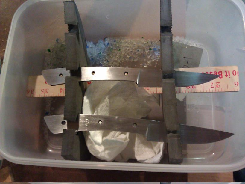

Here's a teaser of the evolved-technique sanded pair in my nifty blade-carrying tupperware:
