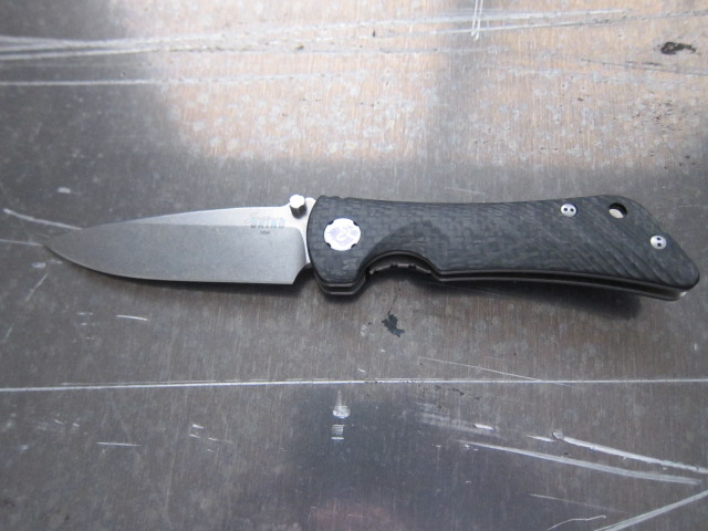

I like a sharp knife. That's the point of having a knife isn't it.
Do you sharpen or re profile a brand new knife before you use it. Or do you use the factory edge until it needs sharpening. I find myself sharpening some and using others. What do you guys do?
This is an example of a brand new knife that I sharpened right away, it came from the factory with a huge burr on it so it really needed it.
This is one that I haven't sharpened at all yet and I use it quite a bit
